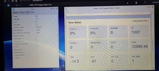

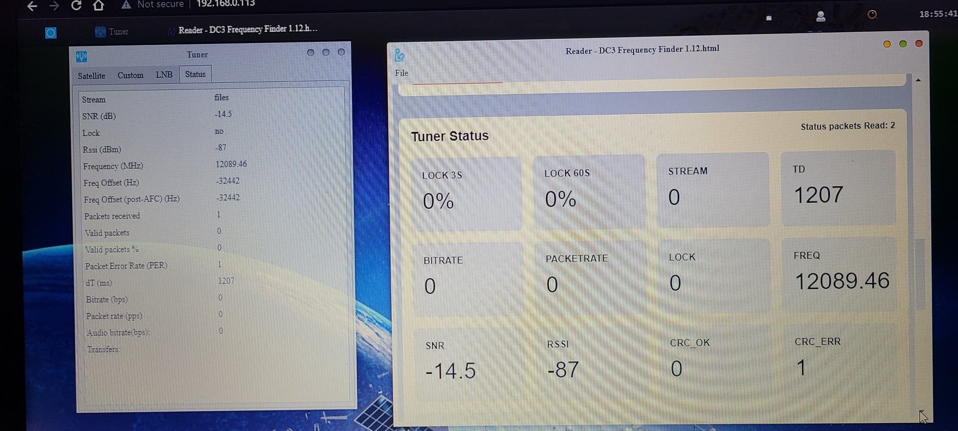

IIRC, the Frequency Offset would jump around a lot, here’s a single static screen grab from during the experimentation

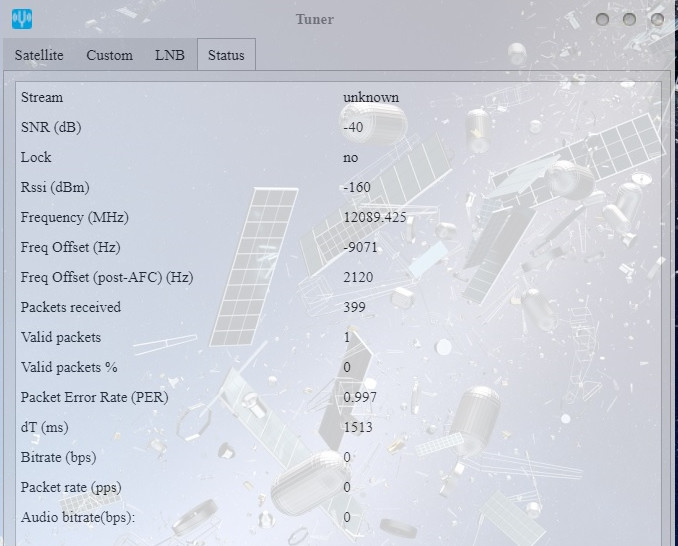

The -40/-160 values are not real values. Those are just default numbers reported by the chip when there are no packets.
SNR -25 is the lowest I’ve seen for reception of an actual packet. And that’s not possible with the current radio settings (spreading factor and coding rate).

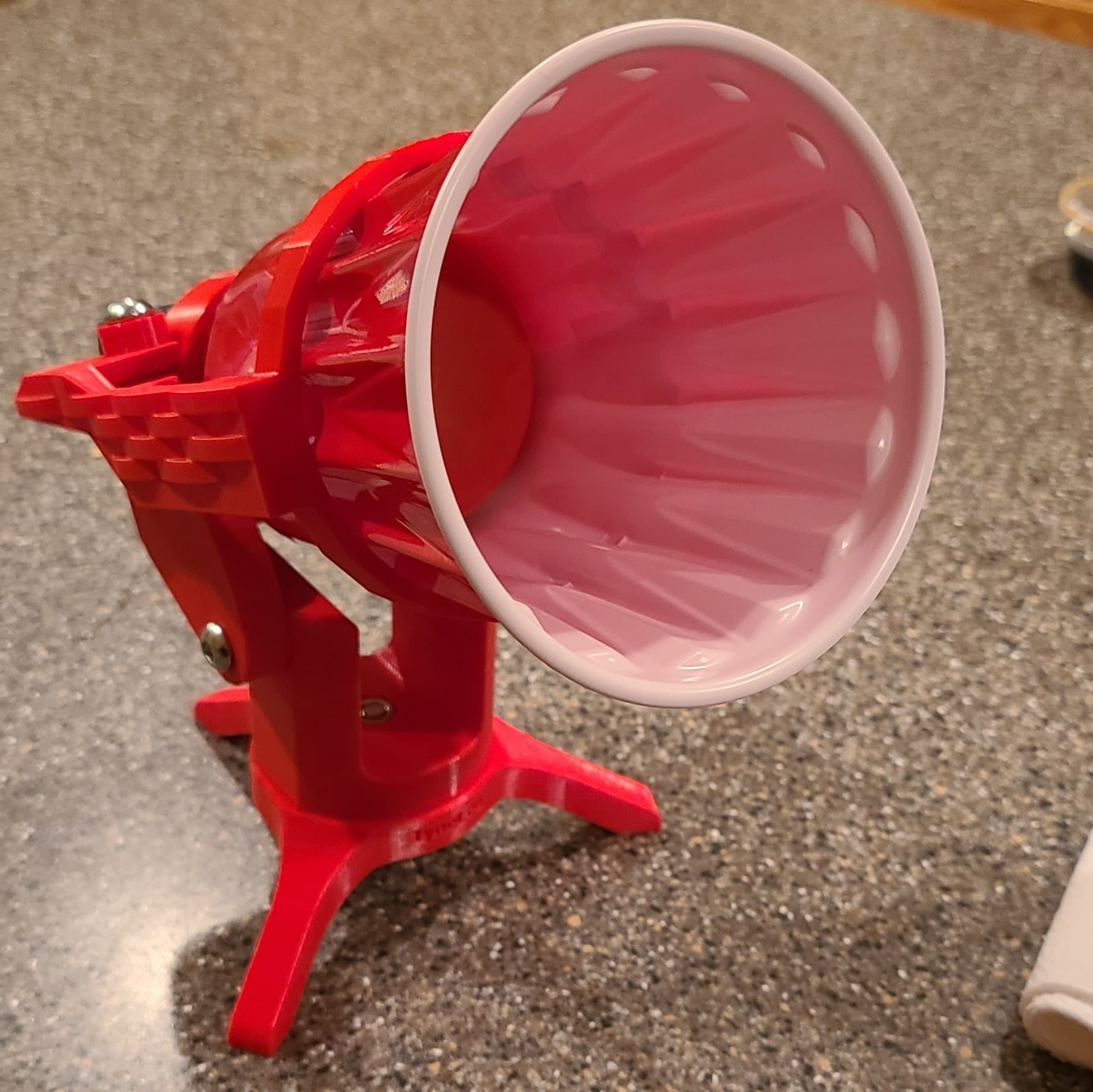

I was able to improvise a cone from standard kitchen aluminum foil glued to an 8.5" x 11" piece of cardstock. I’ll have to figure out something more permanent, but this got me up and running!
Would this serve as enough of a feedhorn to enhance signal capture? Going to try it all out tomorrow, hopefully. I assume line the interior with aluminum foil?
The additional attachment to the mount is meant for a pringle can of some sort, but this is what I have on hand.
You should see improvement with this concept after foil lining the interior of the cup. Neat design :grinning:Ken

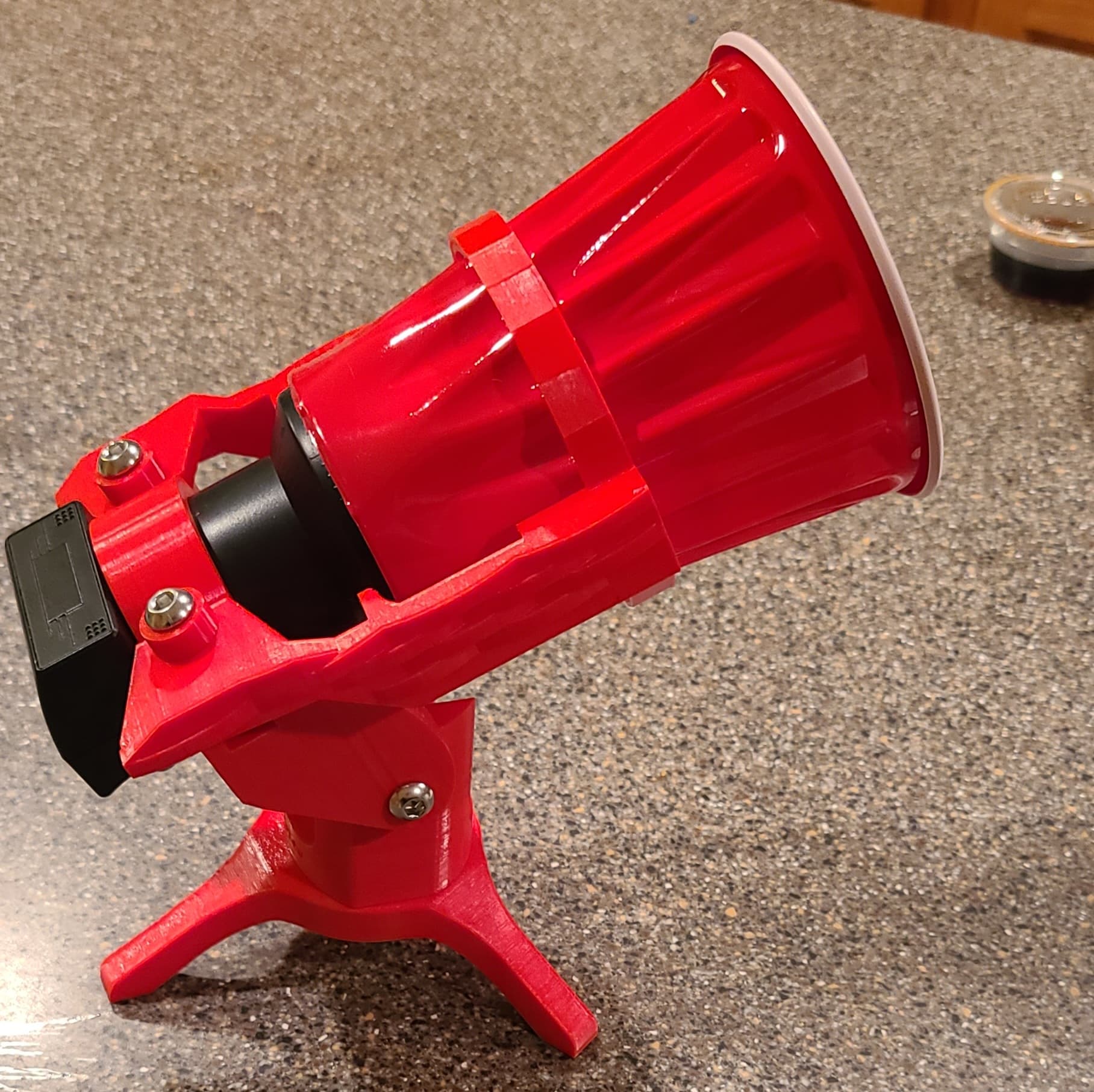

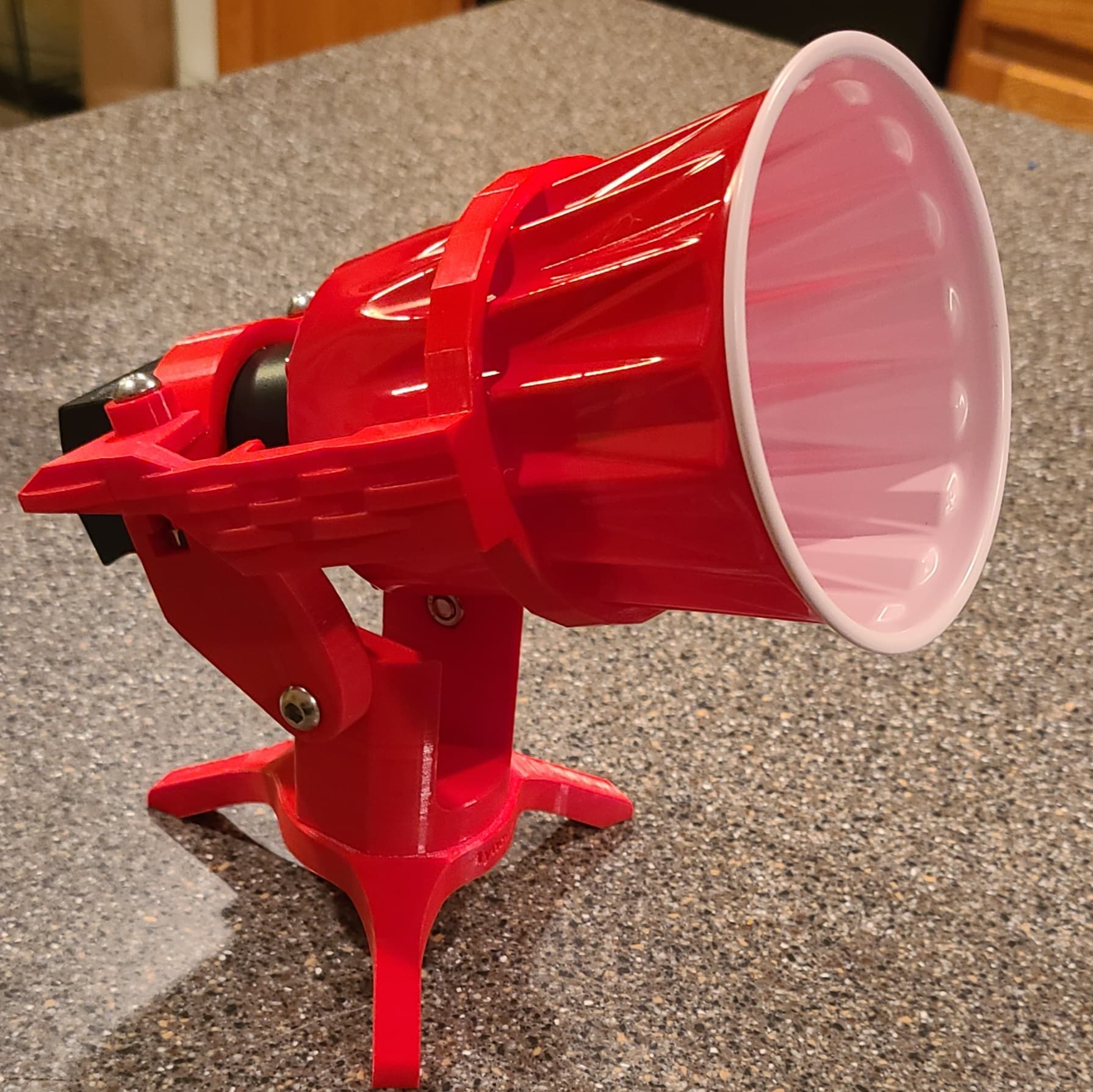

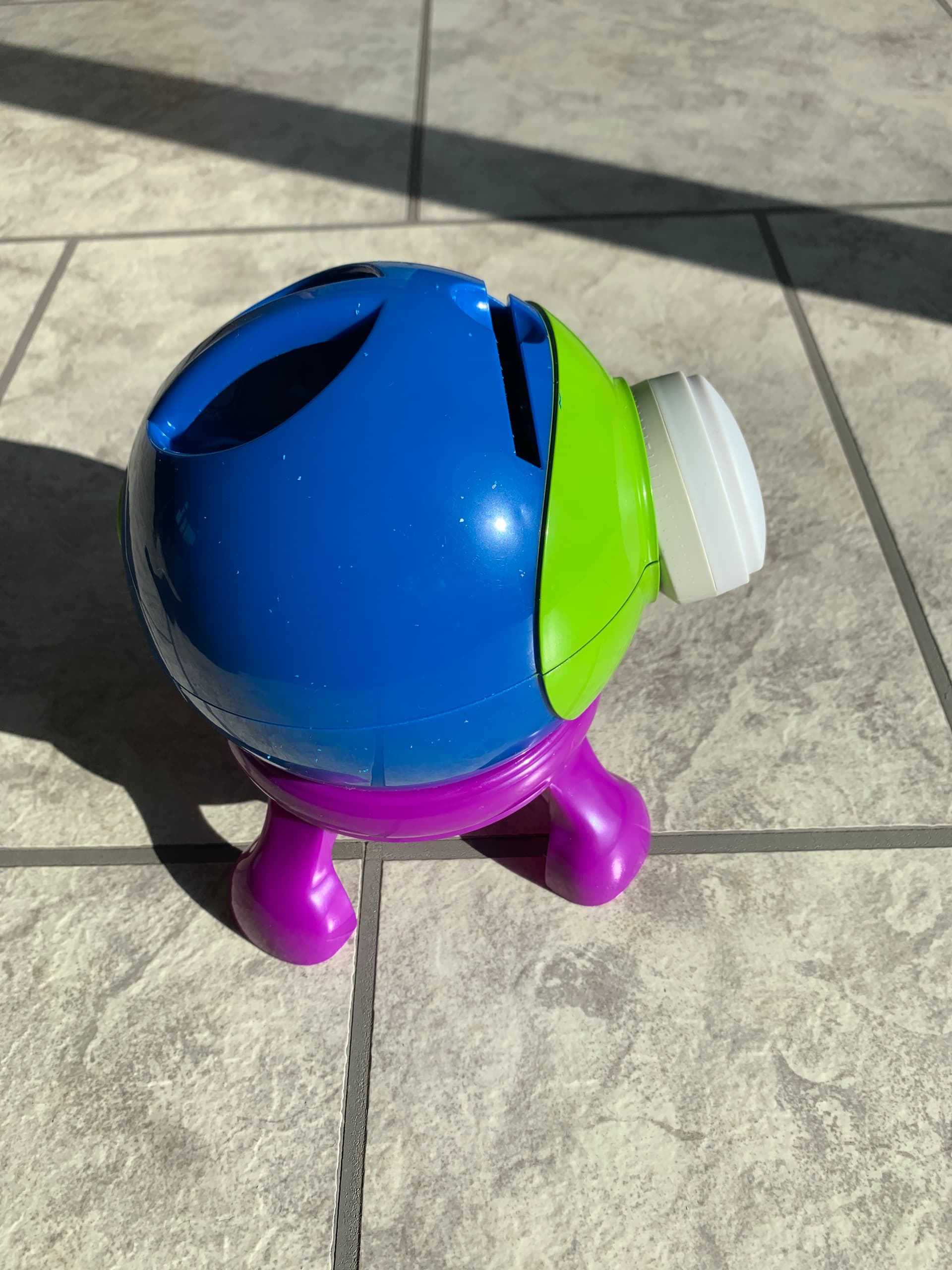

That’s really neat. This is what I’m playing with at the moment. It’s based on a toy projector. It already has a battery compartment with an on/off switch—and plenty of space to stick the circuit board inside (the new, smaller Dreamcatcher). My other stands/tripods always get blown over in high winds. I’m assuming this shape will be more stable.

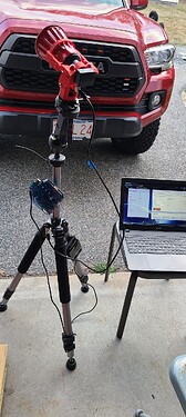

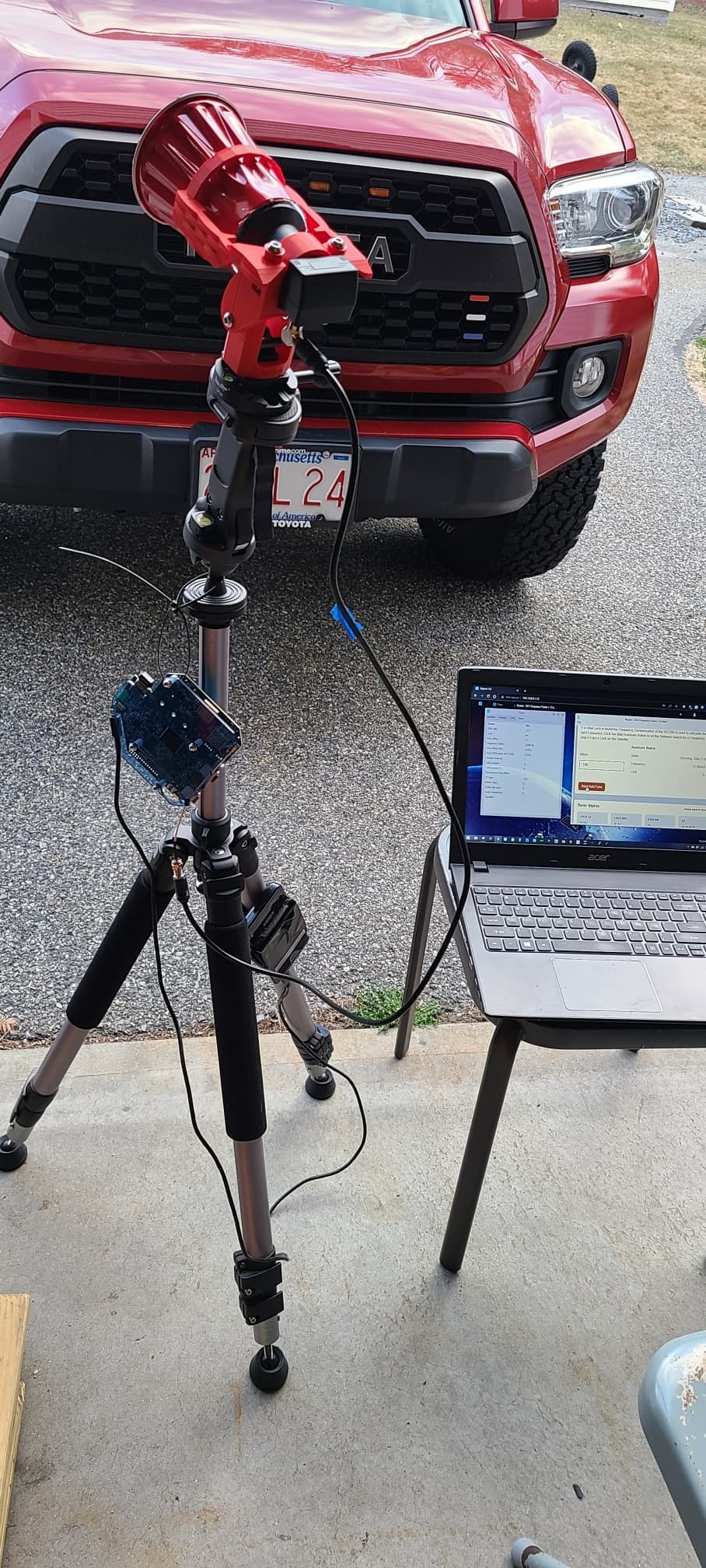

Managed a little time outside, getting setup on a tripod. The following pics represent what I could mange with a couple of hours of playing. Started with the -40. Never did get a lock on the signal.

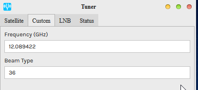

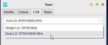

LNB was set to dual… Freq was 12.0984… try the 12.098422?
Thanks.
How wide is the signal again?

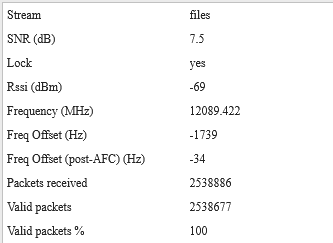

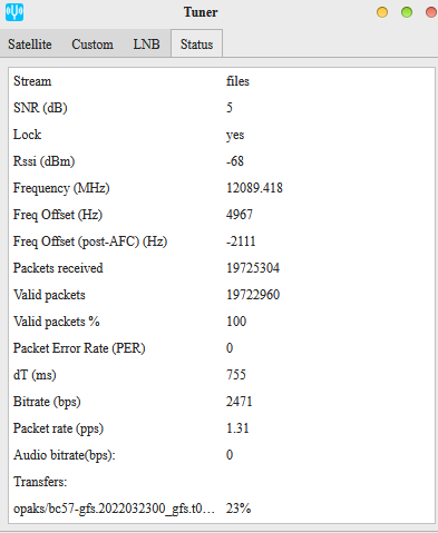

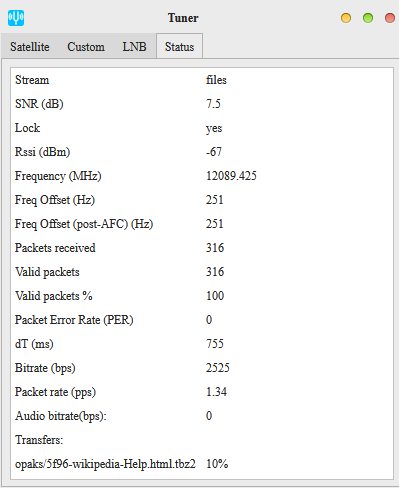

Both myself and Jerry @maxboysdad are operating on frequency 12.0894. You said you are set to 12.098422, although your first post using the Tuner App showed 12.08946 (12089.46). What is your Tuner Status showing now? Here’s mine and Jerry’s - - Ken
Ken Status
Jerry Status
