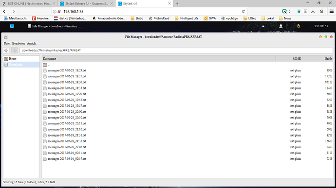

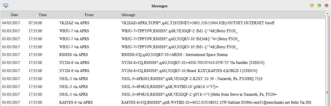

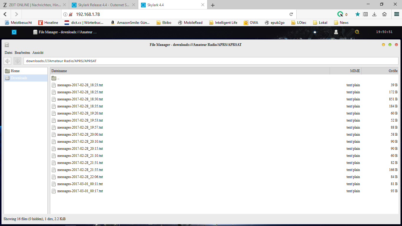

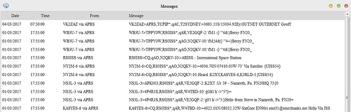

Alphasat - I am looking for assistance in tracking down file delivery issues on the Alphasat beam.
Can people on Alphasat please post their /var/log/messages (“System Messages” from Log Viewer) here or in a PM to me?
Specifically - are you successfully receiving APRS message feeds? Please check in “What’s New” - when was the last time you received messages?
Could you include a screenshot of File Manager open to “downloads:///Amateur Radio/APRS/APRSAT” and scrolled to the bottom, along with the UTC time when you took it?
Thank you!

No, I am not receiving APRS Messages. Setup was fresh from yesterday.
Wolfgang
Log from today 1700 Z and screenshot:
