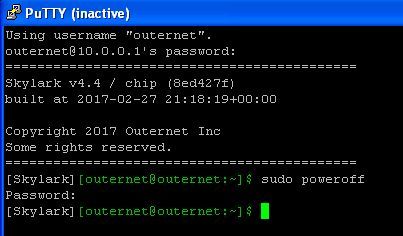

A quick update to this post - - I can reliably poweroff my Lantern’s CHIP and SDR/LNA thru SSH using sudo poweroff as follows:
