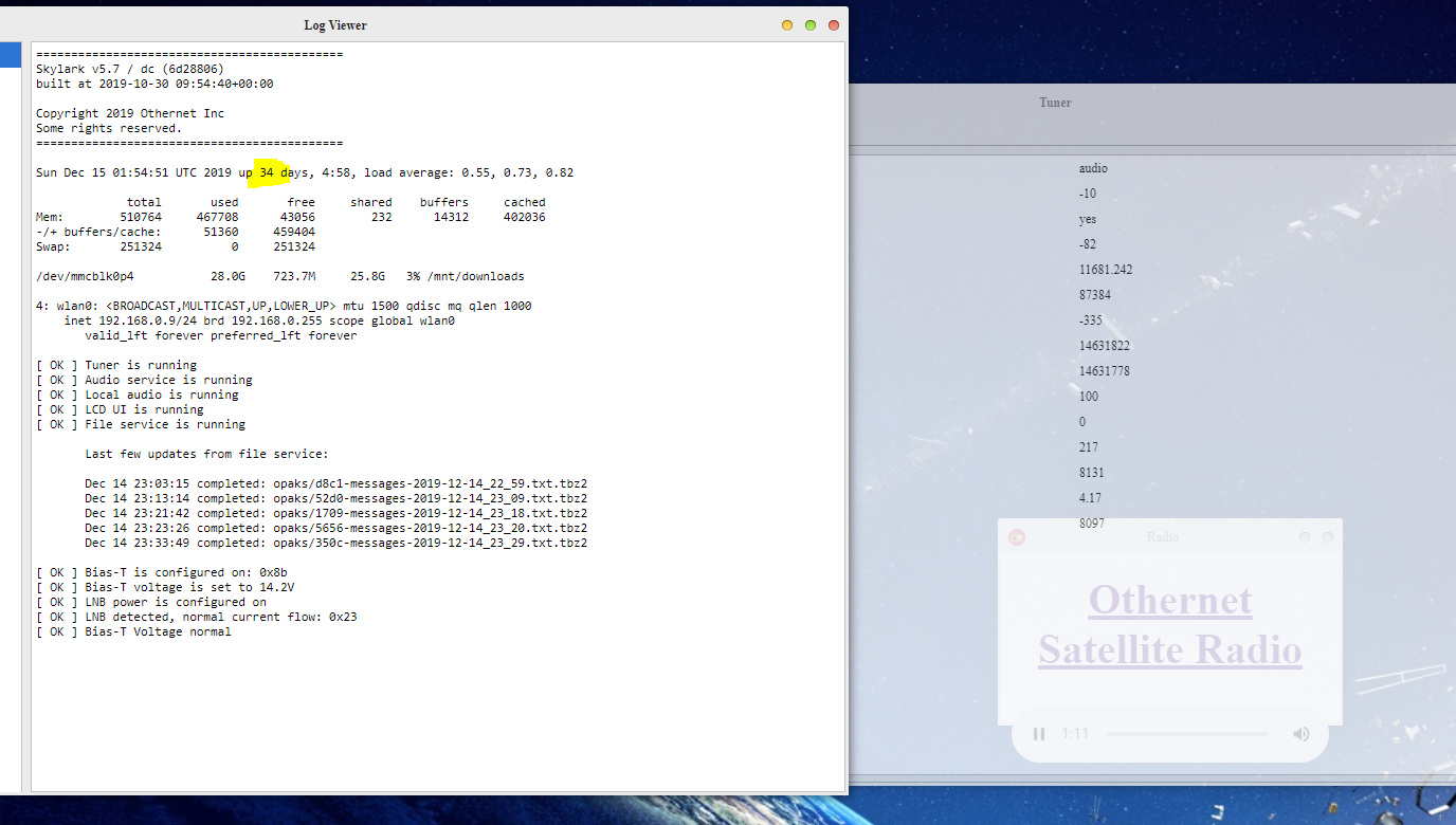

Thanks for fixing the Bug in the last Version, just listenign to Radio over Othernet after 34 Days running my DC nonstop. Nice!
PS: that is BBC Radio on th EU Beam or what?
It should be Voice of America. BBC refuses to license their audio service to us.
