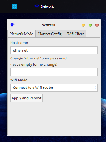

Here are some pictures - -
Here’s where you go - -

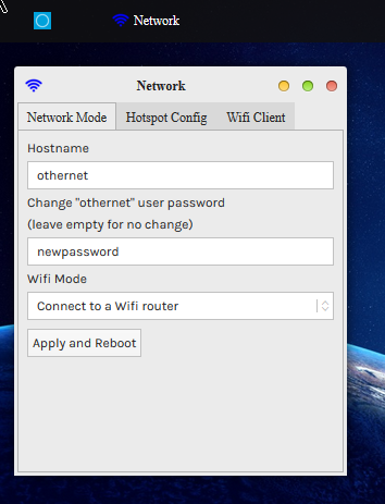

Type in the new Othernet password - -
Then click Apply and Reboot and your admin password will change to the new one. Ken
