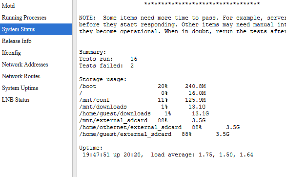

Another point back on the external storage getting full - - there is a tab in Log Viewer - - System Status that will give your remaining storage
In my situation, I only have 3.5 GB left which will fill in a few months because I have the entire Rachel data base on my 32 GB micro SD card. I’m going to set up a 64 GB micro SD card (FAT32 formatted) with the Rachel data base to get more storage. Ken

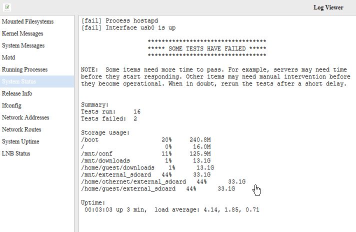

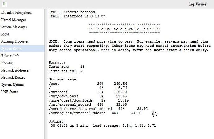

64 GB External Storage
A FAT32 formatted 64 GB micro SD card works fine in the Dreamcatcher v3.03 with Skylark 5.3 - -
With the Rachel data base, I have 33.1 GB free for Download storage. Ken

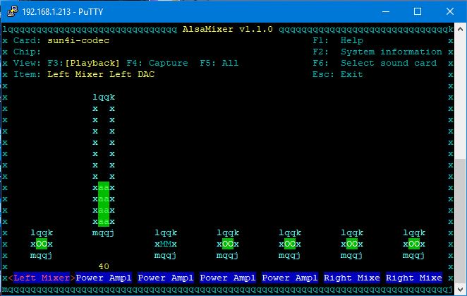

Also, a reminder for those that want to adjust the audio.
- Download PUTTY
- Enter the IP address and leave it in SSH
- Login with othernet/othernet
- type “sudo alsamixer”
- Enter “othernet”
- arrow over once and use your up/down arrows to adjust the volume
Hi Jason, I couldn’t increase the volume with the mouse over, I think I missed something in what you said
@kenbarbi: as you can see “Left Mixer” is currently “selected”. “arrow over once” meaning press the right arrow key once, to select “Power Ampl”, and then use the up/down arrow keys to increase/decrease volume.
Excellent! Another keeper of an SSH program. Ken

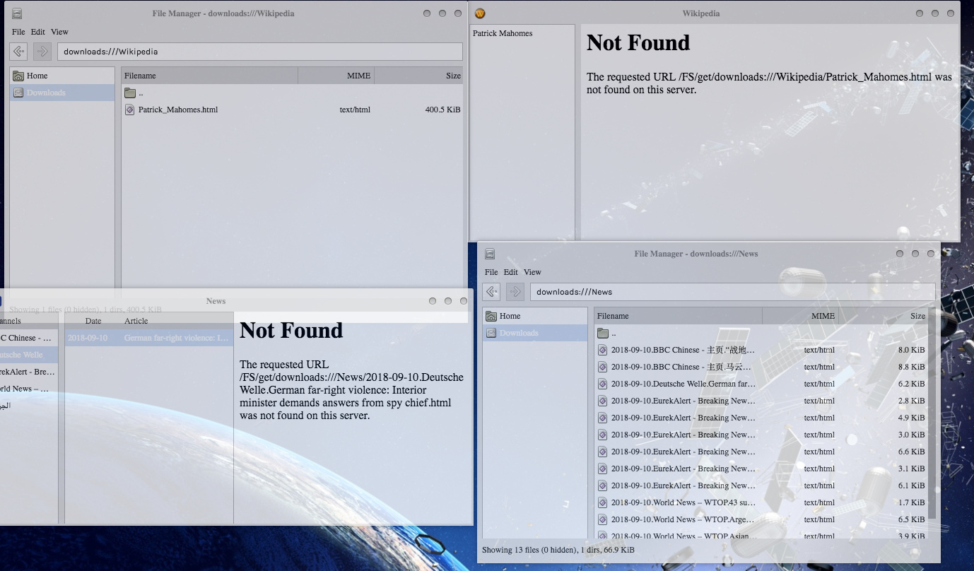

My apologies, was out for the weekend. Here’s the screenshot attached. I’ve gone ahead and blew up the SD card and started from scratch, but oddly still getting this ![]()
Can you try doing a factory reset from the LCD ui and see if this persists?
Also can you please show me the “System Messages” from Log Viewer.
