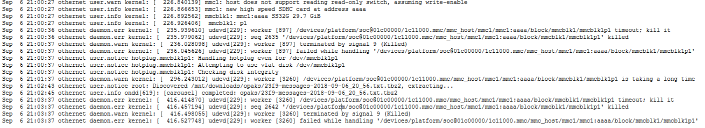

Yeah, I tried to look at the /external-drive/downloads and crashed my skylark
I then tried to restart… it wouldn’t fully boot with the second sd still installed.
So. I restarted with only the operating system sd, that was ok
then in inserted the 32gb second sd…
after three minutes of ā€œchecking disk integrityā€ it timed out and that was far as I got
I know the skylark does a 7day cleanup of the files… some of them…
The question is ā€œwhat is being mirrored over on the second sd card?ā€
These screen grabs are a little hard to read from the system messages log.

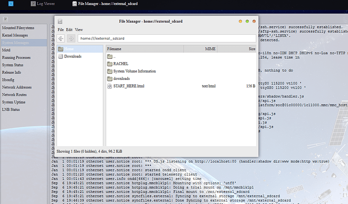

there is an option on the lcd setting.
called unmount the external sd card. It’s a little tough to get
there but I’m trying it to see if it does and help
edit:
I finally got to the home:///external_sdcard/downloads/Wikipedia
there are 4797 files for 2.2 GB on my secondary sd card (from the month of July)
2.2 GB seems too high. Let’s see what @Abhishek has to say. Ken
