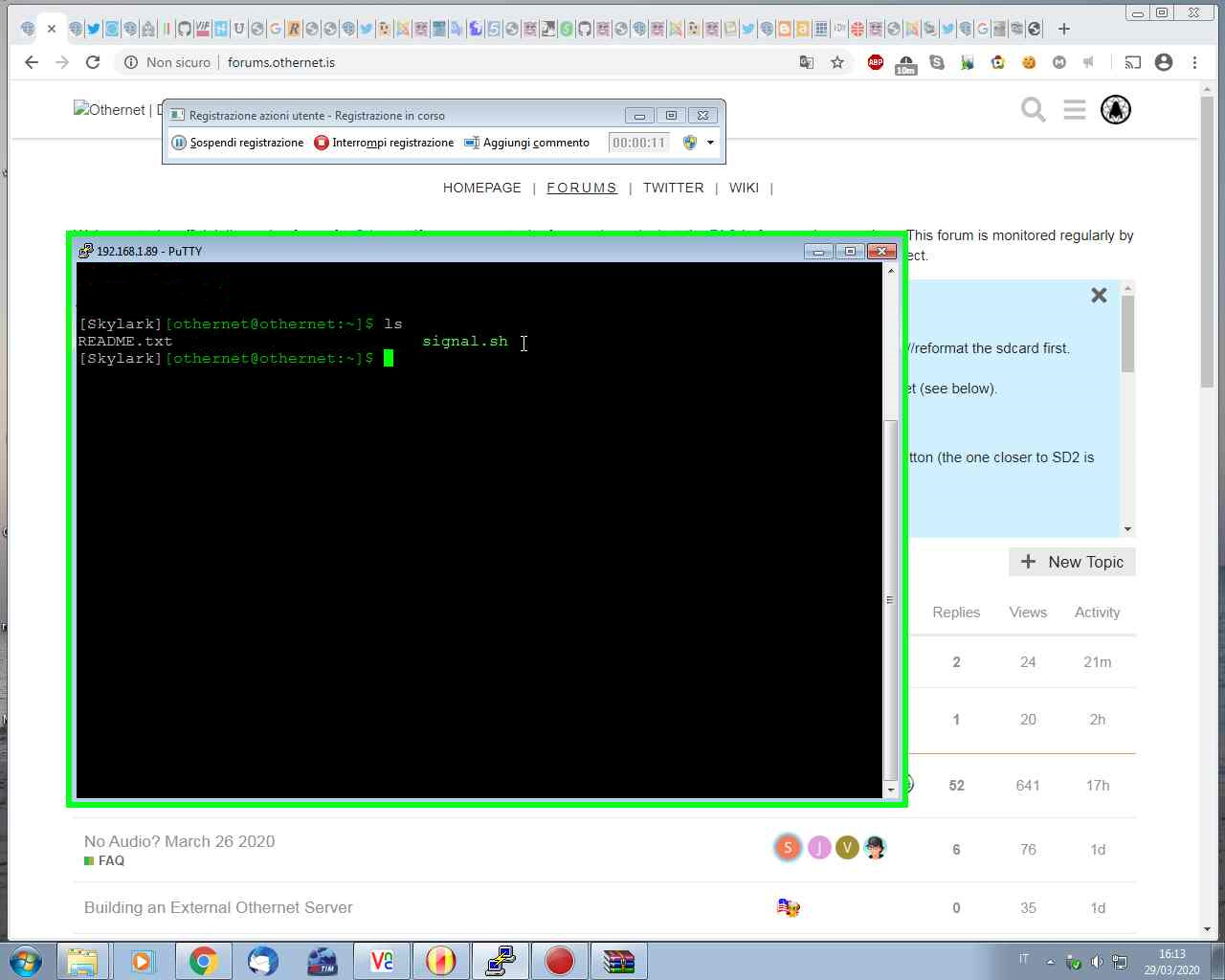

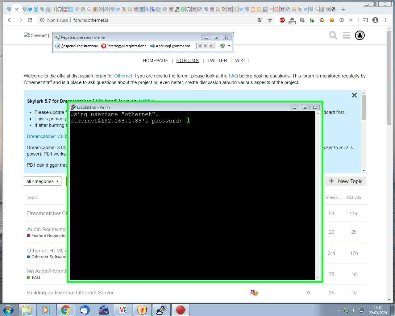

Copy the file from the forum ( next post), open an ssh session ( I use Putty in windows OS ) to your D.C, you need to know the IP address, authenticate and type an ls command, just to see what’s in the directory.
Type vi signal.sh and send.

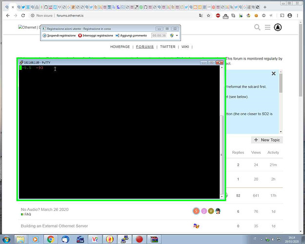

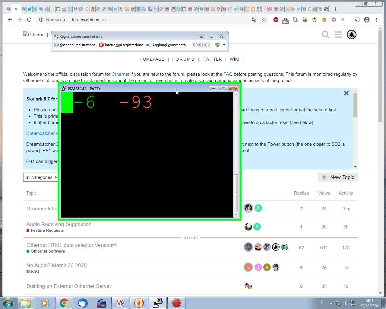

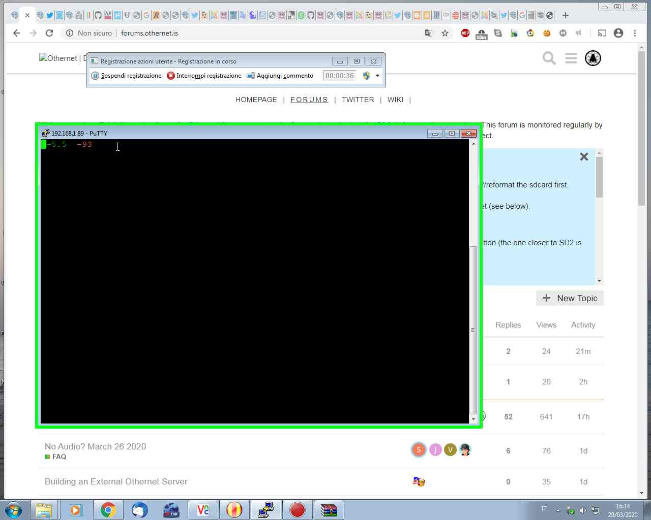

Hope everything work, now in the terminal the 2 numbers run down.

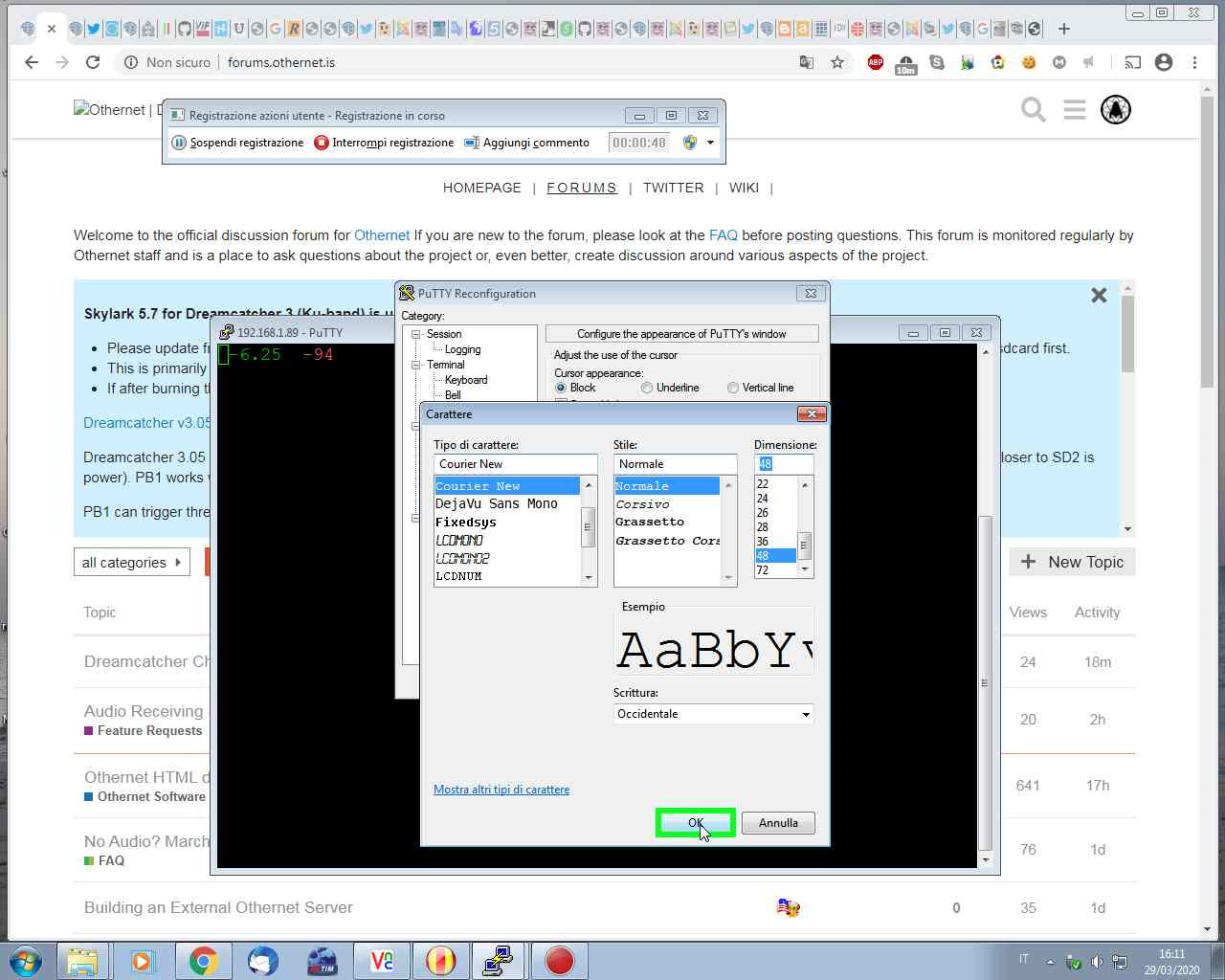

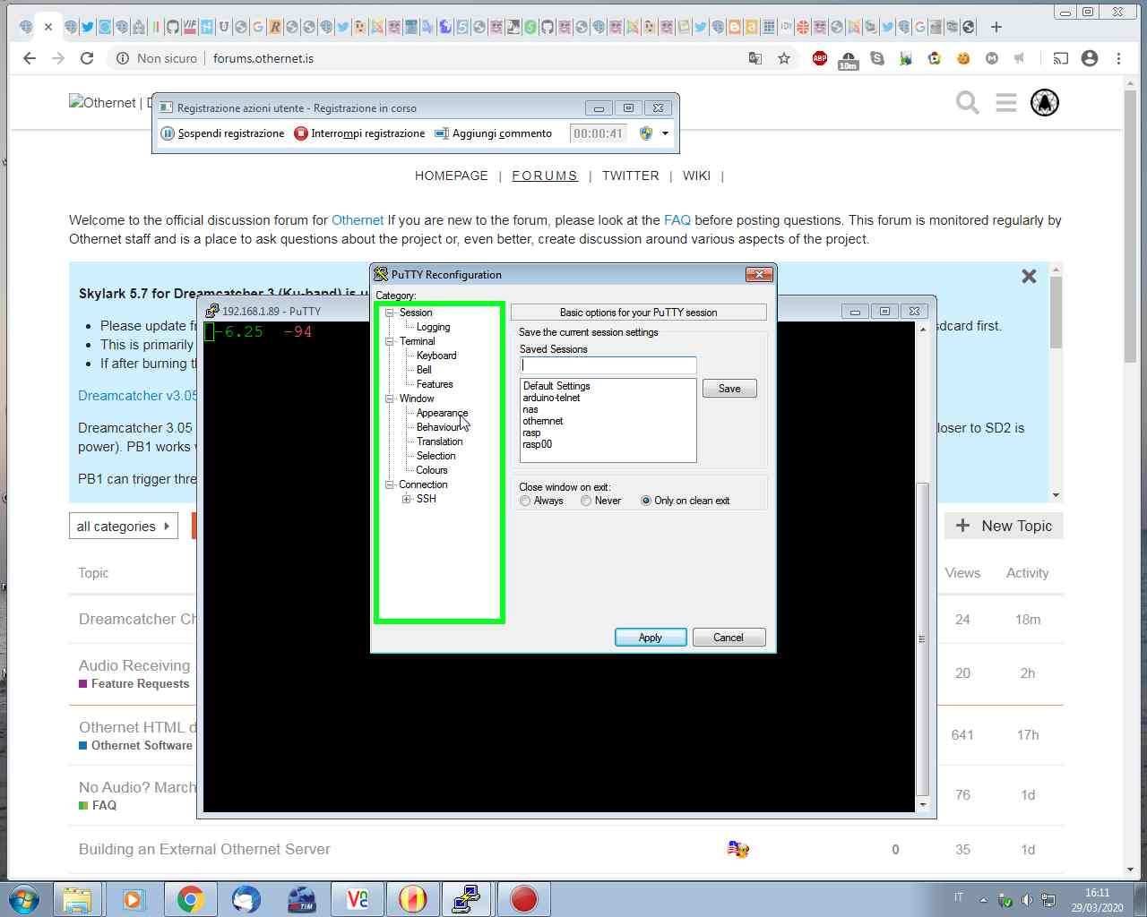

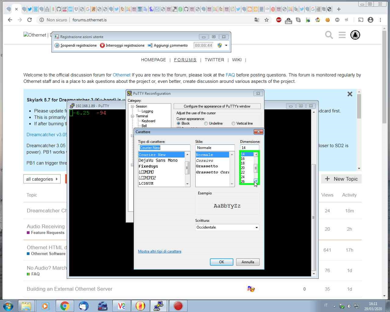

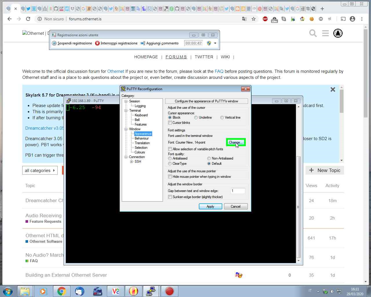

I will put some photos to explain how to change the size of the text with Putty but you can find your way if use a different terminal.

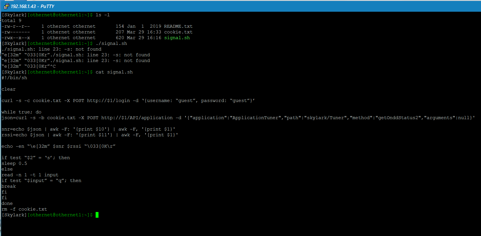

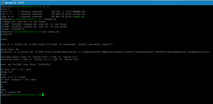

looks promising… but can you debug what I did wrong ?
try to change the echo line with:
echo -e “\033[1K”
echo $snr $rssi
./signal.sh 127.0.0.1
just to remember that if you have not signal from antenna at all, blank page on the othernet page, this will not show any numbers.
This is made to read the values once you got the satellite and have at least some indication on that page ( what I said??)
I am having issues with the keyboard characters for the single and double quote characters to make the script work… my ansi keyboard doesn’t support all of them, cut and paste is causing problems…
try only the complete command ./signal.sh 127.0.0.1
in the previus post you miss the IP address

i see the problem with a few lines: the quote chars got replaced with something UTF-8-ish which are not the plain ol’ ASCII “”" chars. every single and double quote char you see is suspect. a quick fix with vi and you’re done.
also: the variables ‘json’ ‘rssi’ and ‘snr’ do not have the proper
enclosing dollar-char lparen … rparen → $( … )
this is the preferred construction rather than use backquote chars (which got eaten by this forum’s editor, it seems)
as in:
rssi=$(echo $json | awk -F: ‘{print $11’} | awk -F, ‘{print $1}’)
here’s the “debugged” script:

I modified the echo to display in green \033[0;32m and red \033[0;31m and reset \033[0m
echo  -n 'Type letter q to quit'
echo -en "\033[0;32m" 'SNR= ' $snr "\033[0;31m" 'RSSI= ' $rssi "\033[0m\r"

finally the numbers on a line only, no scroll. Well done.tnx
