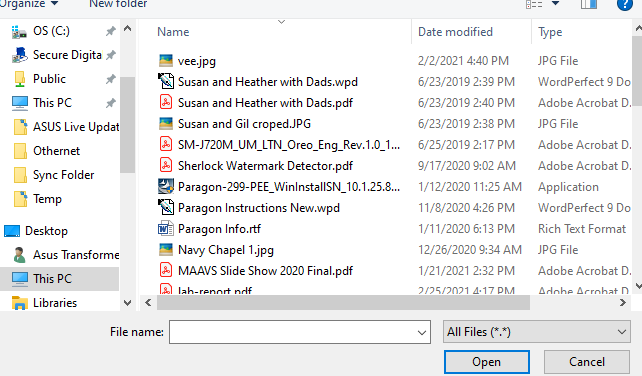

Just received the Bullseye. Where do I put the Satellite Frequency Finder file? I pulled the OS SD, put it in my PC and sent it right into the SD card. Looked at the card. The file its there. Plugged it back into the DC. Fired it up. Don’t see the file. What am I doing wrong?
Thanks, Don

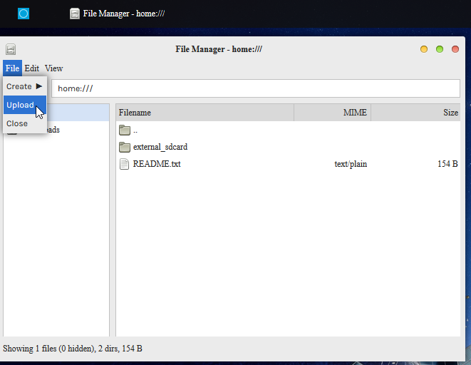

Hi Don, if you down loaded it to the Skylark OS Card, it got deleted when you rebooted the Dreamcatcher. If you want to put it on a card in the Dreamcatcher, you have to write it to the External SD card.
Otherwise, with Skylark running, upload the file to your OS card. Go to the File Manager then Upload the file this way
Then find the file and upload it. It will now appear on you OS SD card where you can run it. Again when you reboot your Dreamcatcher, this Upload goes away. Ken
Or run it from the Uploads Directory as Syed said.

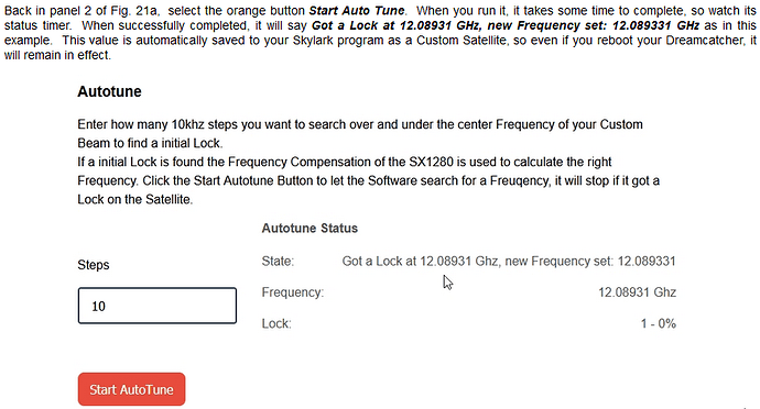

Finally was able to change out the Maverick today to the Bullseye (snow melted). No change on Skew or aim on my Dish 500. Ran the autotune app 1.11 (set to 25 steps) and it found lock at 12.08961. Nice!

After you did the Auto Tune, did you get this confirmation that you found a frequency?
You may have to start the Auto Tune at higher starting frequency, or add more steps - - like go from 10 to 20. Ken
