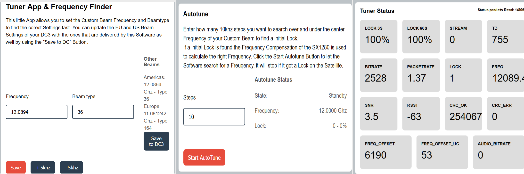

i implemented a Autotune Feature and made the App a bit nicer looking ![]()
Autotune searches a range of 10khz steps to get a initial Lock, if it got one it caluclates the right Frequency with the Compensation factor reported by the SX1280.
You can download the new 1.1 Version here (Right click->Save Link as):

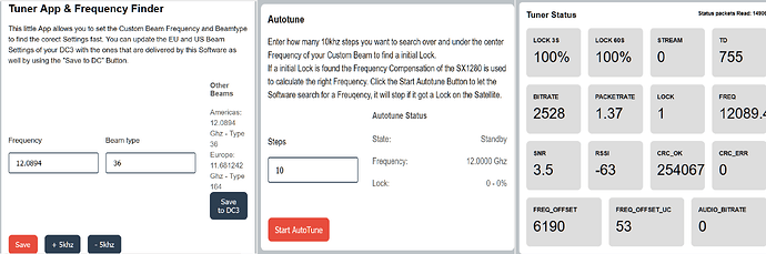

Very nice, Manuel! Just a question here, but is it possible to put the three segments side-by-side instead of vertically? I have more screen real estate available to watch and work with that way.
Thx, will do some changes to the UI, responsive is always a bit of a hassle but it would be nicer. Will be in the next version

See first Post for new Version 1.11, two Cards will now be used per row on large screens.

I apologize that I was not clear in my request. Something like the pasted graphic below is what I meant. Your original columns were fine, I only meant that it would be nice to see it all on the same desktop without having to scroll back and forth to watch it work. Note to other users: this is not an actual screen shot, but three clips pasted together in a graphics program, and is only for illustrating a request. It does not represent any screen shot that is currently available.
Superb Manuel - - it works like a charm. Now, Syed needs to get it in the carousel for everyone to use without the manual download process. Ken
i did understand your Request, this will not work good at the Moment tho, see how bad the left Card looks with the Text that is really pushed together. Most peaople will not use the apps in Fullscreen anyway i think.
PS: There are four cards anyway, in my Opinion a 2x2 grid looks better then three cards and one lonely one below.

No question that 2x2 would look better. OK, I uploaded it, but still is in one long column with all four cards. Or did I do it wrong? How (or can I) make it look like a quad on my screen, or is it possible?
