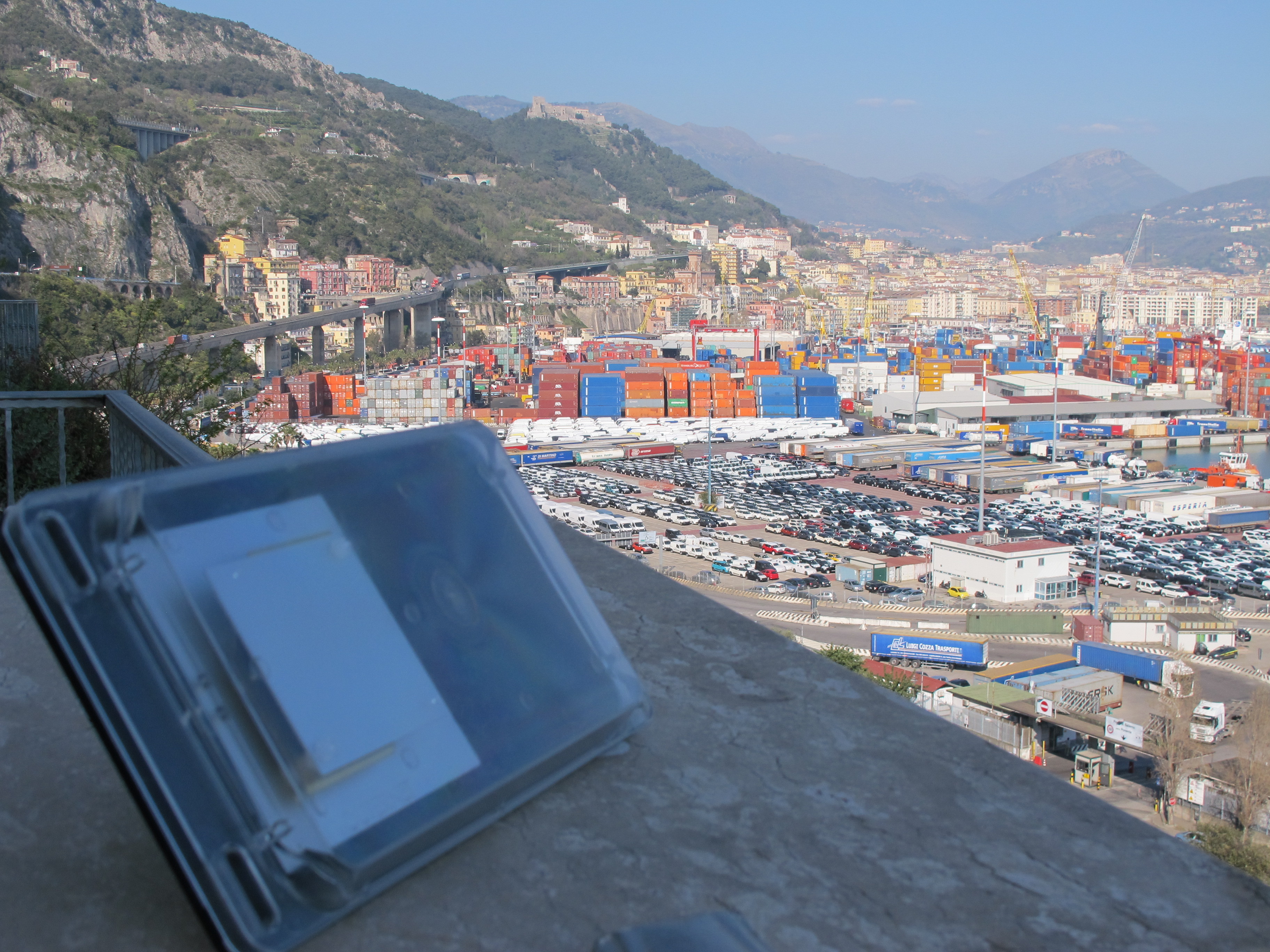

Interesting reception issues here in Salerno, Italy, (Lat 40.68 N, Long 14.77 E at 1700 Local - 1500 UTC).

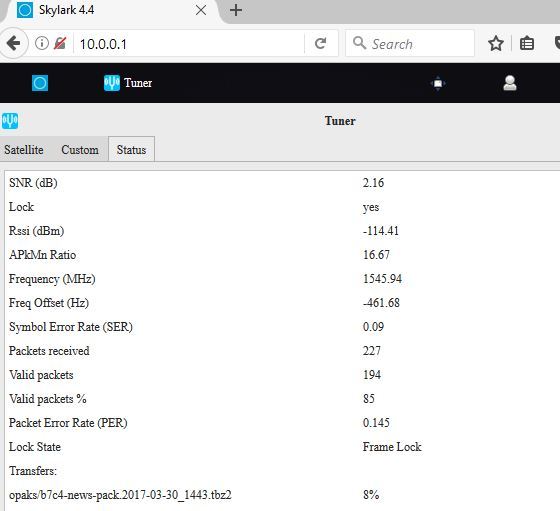

With Lantern perched high on pillar my SNR peaked at 2.16 dB with an Rssi of -114.41 dBm, and Signal lock with errors:

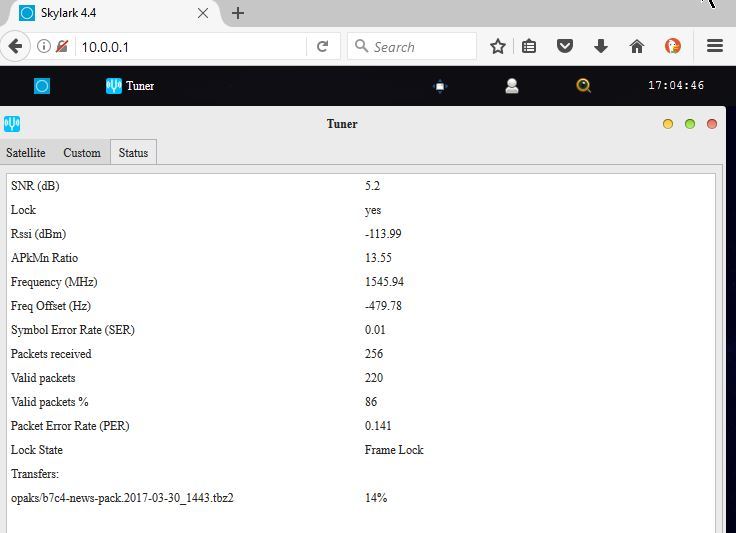

When I put it on the floor shielded to some extent, my SNR peaked at 5.2 dB with a slightly higher Rssi of -113.99 dBm
