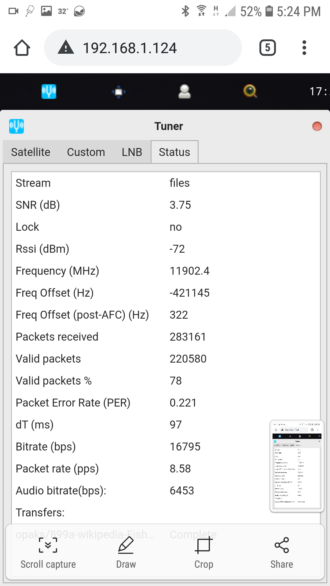

I’m getting intermittent fades and loss of lock here outside of Washington, DC too:
But my signal picks up again in a hurky jerky fashion to +2 to + 7 dB. I don’t think its rain fade, but a transmission problem. I checked @maxboysdad Jerry’s terminal in Utah, and he is not seeing the same thing. Ken
I’m in michigan and seeing the same thing you are. I haven’t brushed the snow off the dish to see if the extra gain makes a difference.
No difference with a clean dish.
Wow. Never seen SNR figures above about -11 before on my equipment Except for back in the L-Band days. That dish of yours is surely working hard. I took the opportunity to try peaking my LNB whilst the rain came down. I now have about a 50% or so decode. I also tried adding an empty baked beans can as a waveguide/feedhorn and that also brought it up out of the noise but I was holding it with my hand and so had to remove it. The bean can did win me a few more db’s though so that’s next on my list of improvements.

Are you talking about the first screenshot with snow on the dish? I was surprised too. I should have taken a picture.
Just to add a comment here, when the storms came through here Monday and Tuesday, my SNR did dip somewhat, sometimes as much as 6 dB. Most of the time when this occurs, it is when there is an accumulation of snow on the dish or the LNB. I have noticed a similar but lesser effect during heavy rain, but it does not lose lock during these events. I agree that it is more likely a transmission problem.

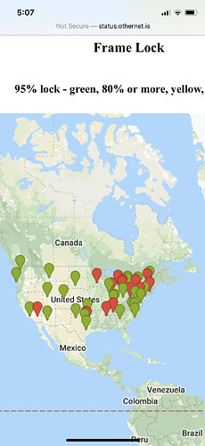

We had a similar situation occur last year, where @kenbarbi Ken was seeing loss of lock at Annapolis, MD, but my unit in Salt Lake City, UT, was not, and it was a minor problem at the feed point (terrestrial noise or something). It seemed like the perimeter of the “transmitted signal” from the satellite had moved, shrank or indented at the east edge for a short time, but was stable farther west. I am about 2100 miles almost straight west of @kenbarbi Ken.

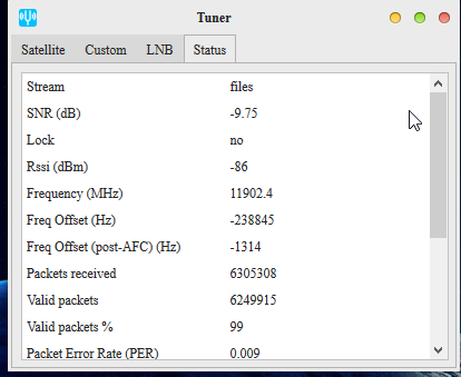

Today, with no precip of any sort I have a -9db s:n and 100% decode and 8100bps audio rate and 20216bps overall data rate. This is the best I’ve ever seen it. Clearly peaking the LNB in the rain helped enormously!! This reminds me vaguely of a trick from back in the day where one hangs a wet rag over the LNB to simulate rain fade? You would then peak for max signal.
