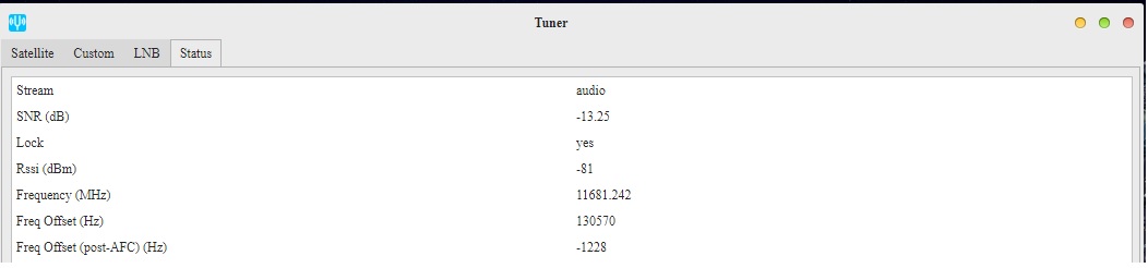

Hi, here in rome these are the values with a horn ( cone), without is -17 snr and - 96 rssi.
Never lock with the bare LNB.

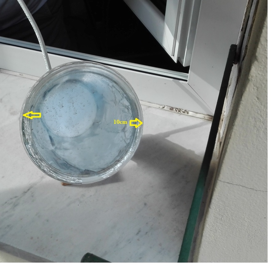

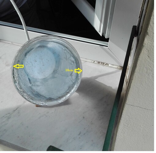

here it is.

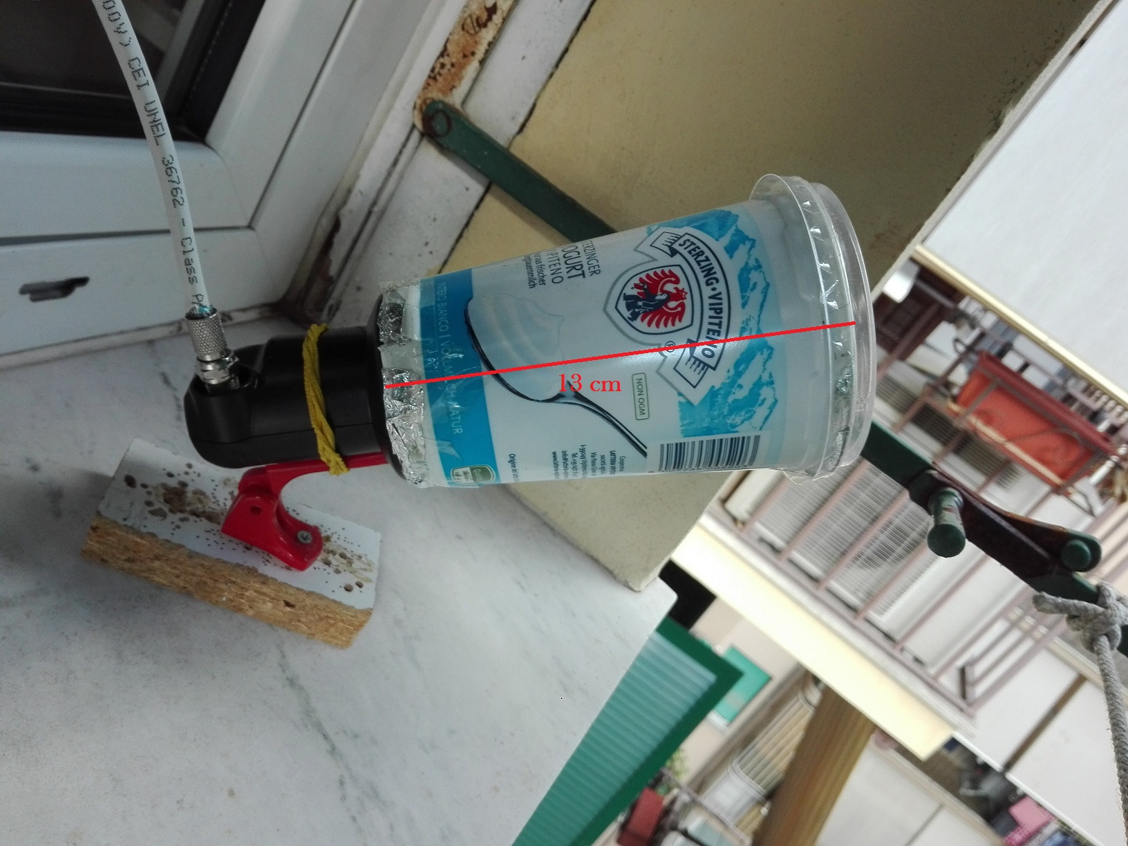

Hope you like yogurt, because is in BOM you need. The part with old hairbrush hinge is waiting for copyrights.
tnx to donde for this:

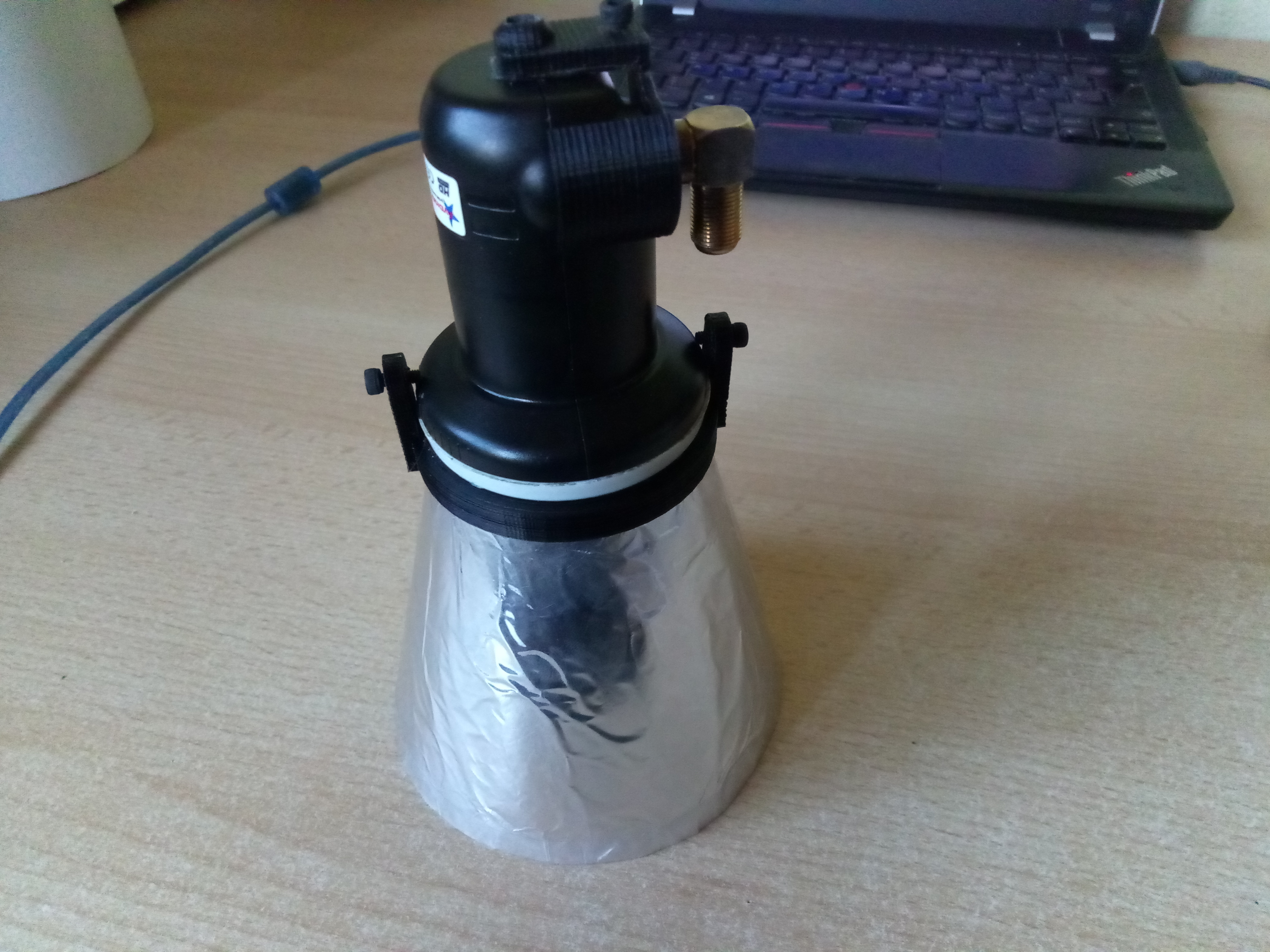

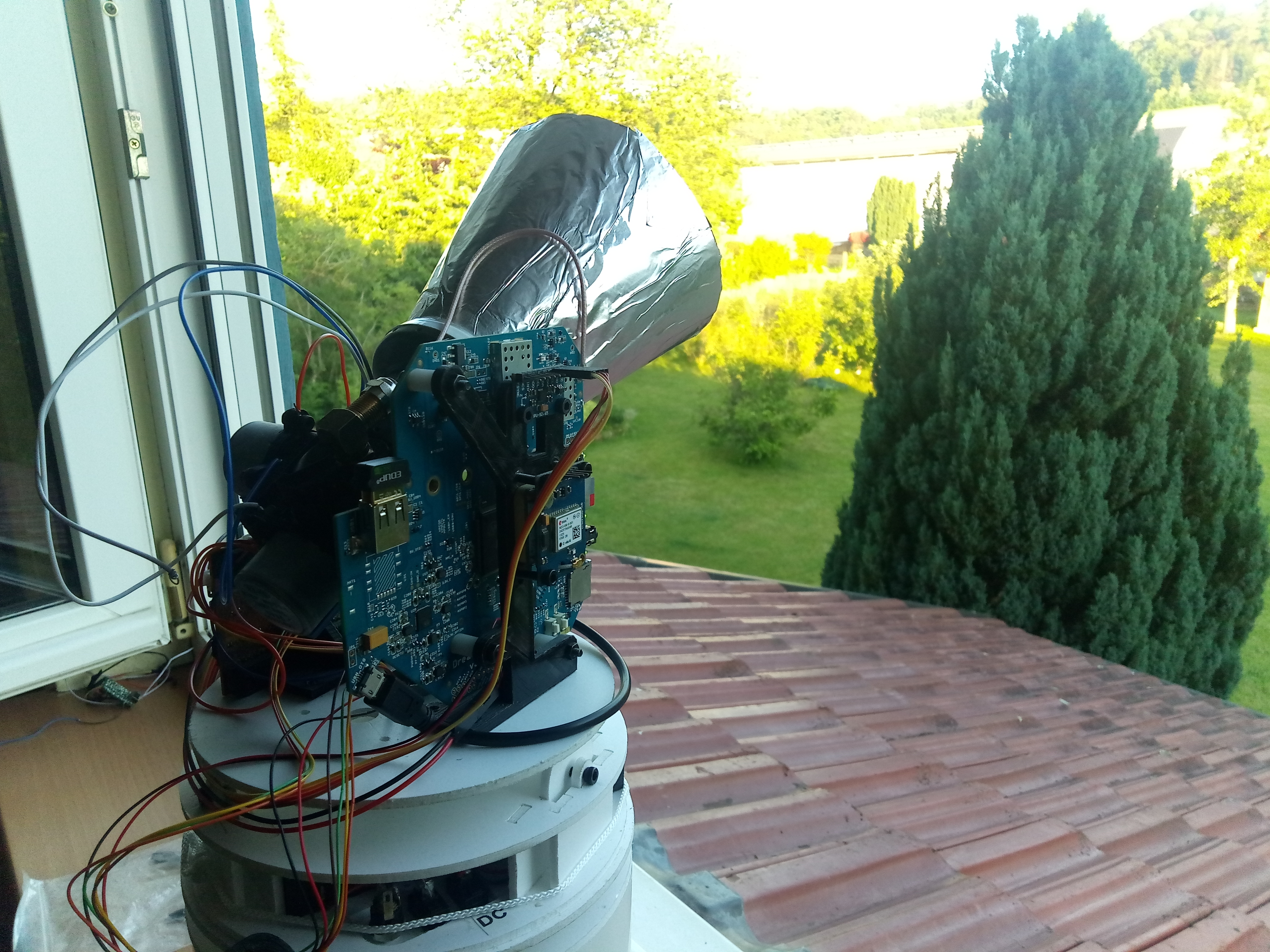

I used the link to make a template out of paper and then coated it with aluminium foil. I am really surprised how much it improves my signal.

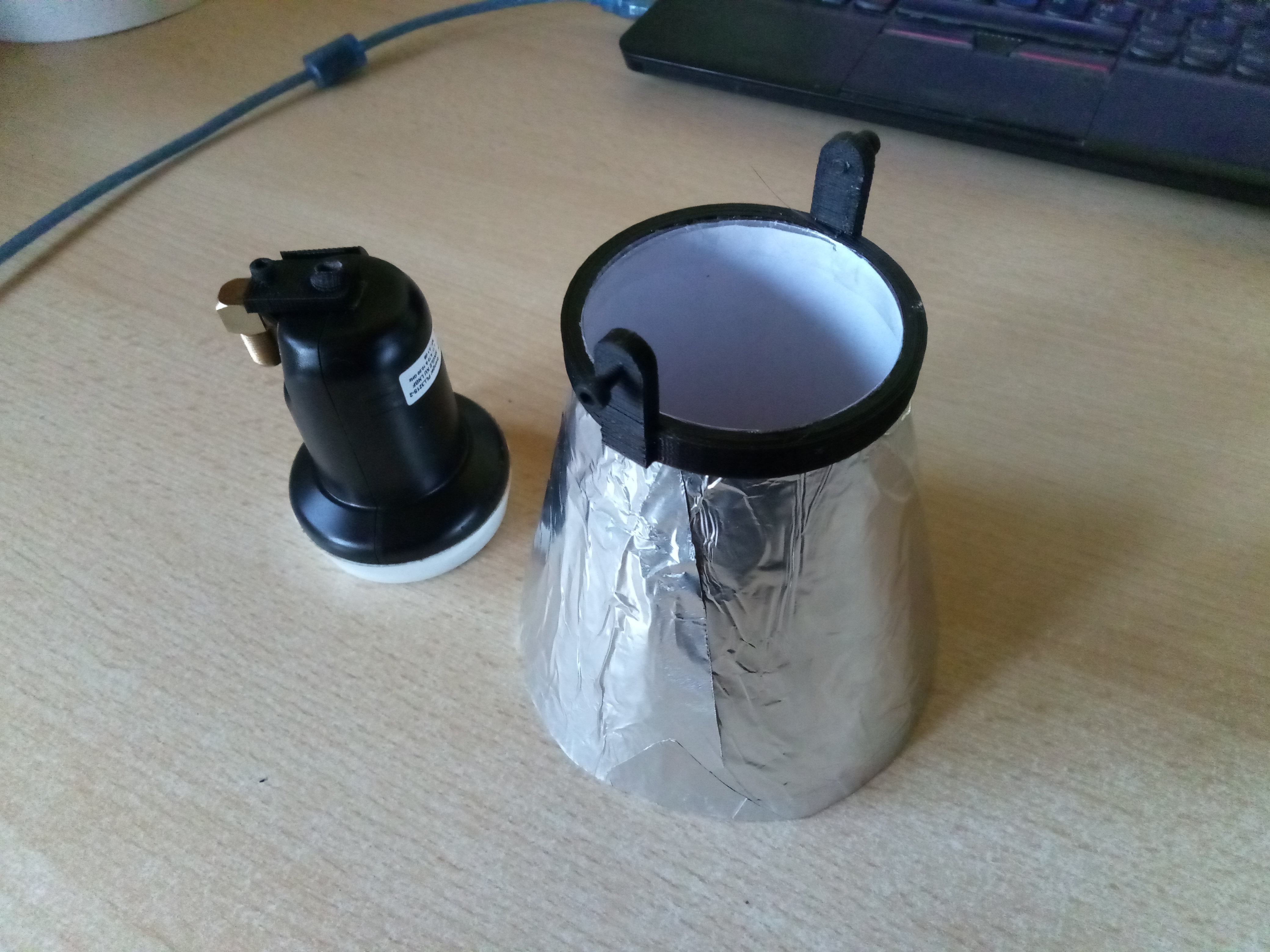

I fitted a ring to my horn, so it can be put on and taken off easily. I am also making parts for a second antenna at the moment and I’ll add some changes so it will work with the horn attached. Only it will not fit into its current case while the horn is on the LNB.

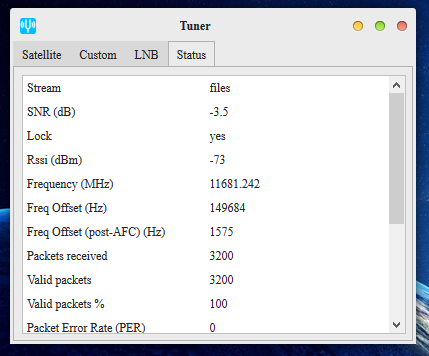

@Martin How much additional gain did you get from the cone?
@Syed I would say 3 dB. The best I got so far without the cone was a SNR of -6.5

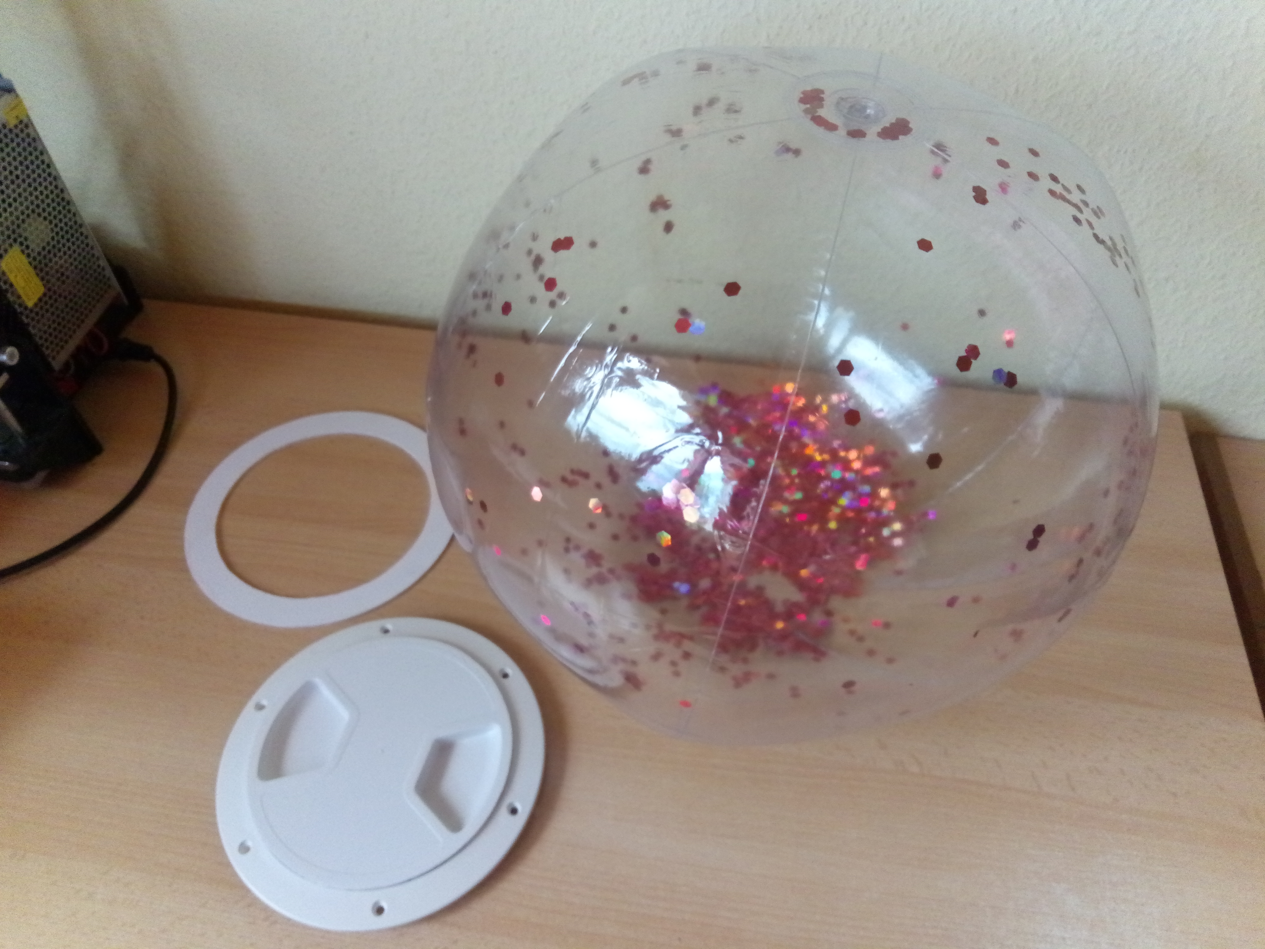

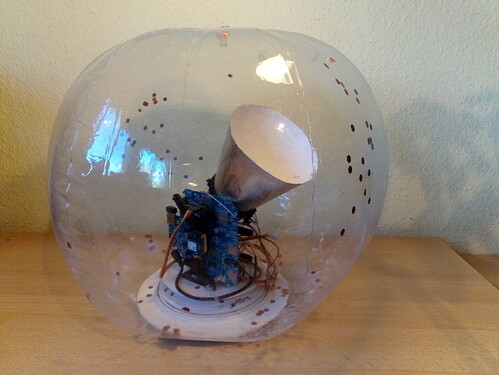

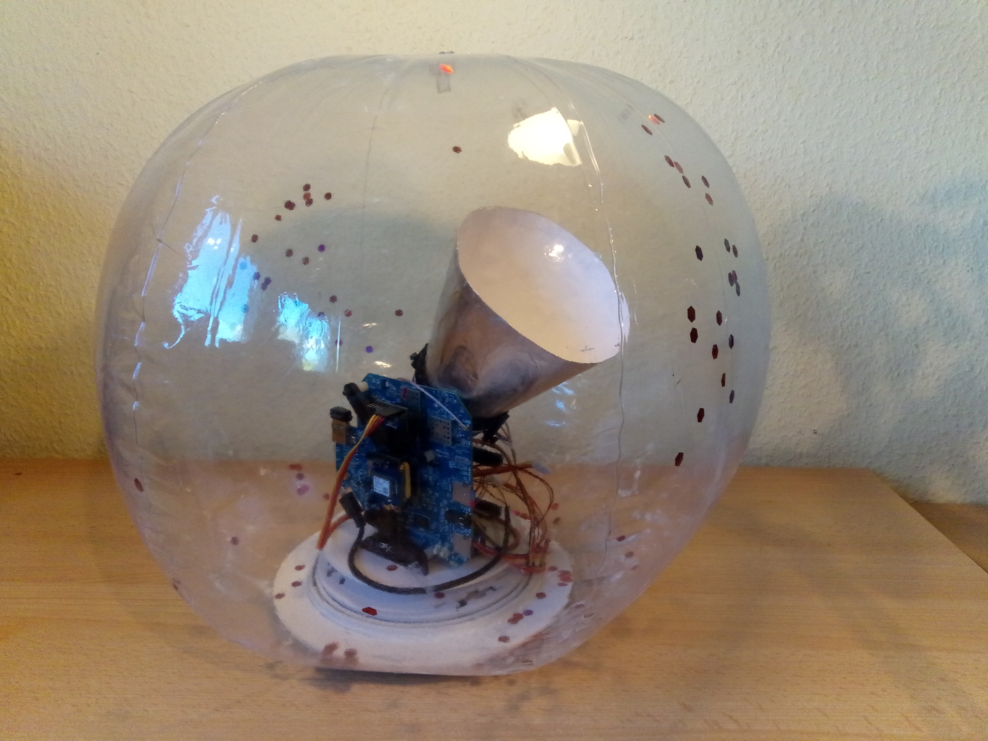

Good evening everyone! I made a new case that should work with the cone attached. It’s made of a beach ball and an inspection hatch. Everything is airtight, so it should be weather-proof as well. I will also add a camera screw mount to the lit, so it can be mounted on a tripod or a cheap security camera mount. That should make it easy fix it on the boats guard rail. I chose a transparent ball (which only was available with glitter) to watch how everything is working inside, but I guess a white one would look nicer and you wouldn’t see the mess I made with the sealant. Those balls are standard merchandise stuff and super cheap. @Syed you could even have an Othernet-logo printed on them. (Take a white one, add a few LEDs to illuminate it from inside and you would have a literal lantern :wink: )
This is bananas! Do you have a video of this…in the dark?
