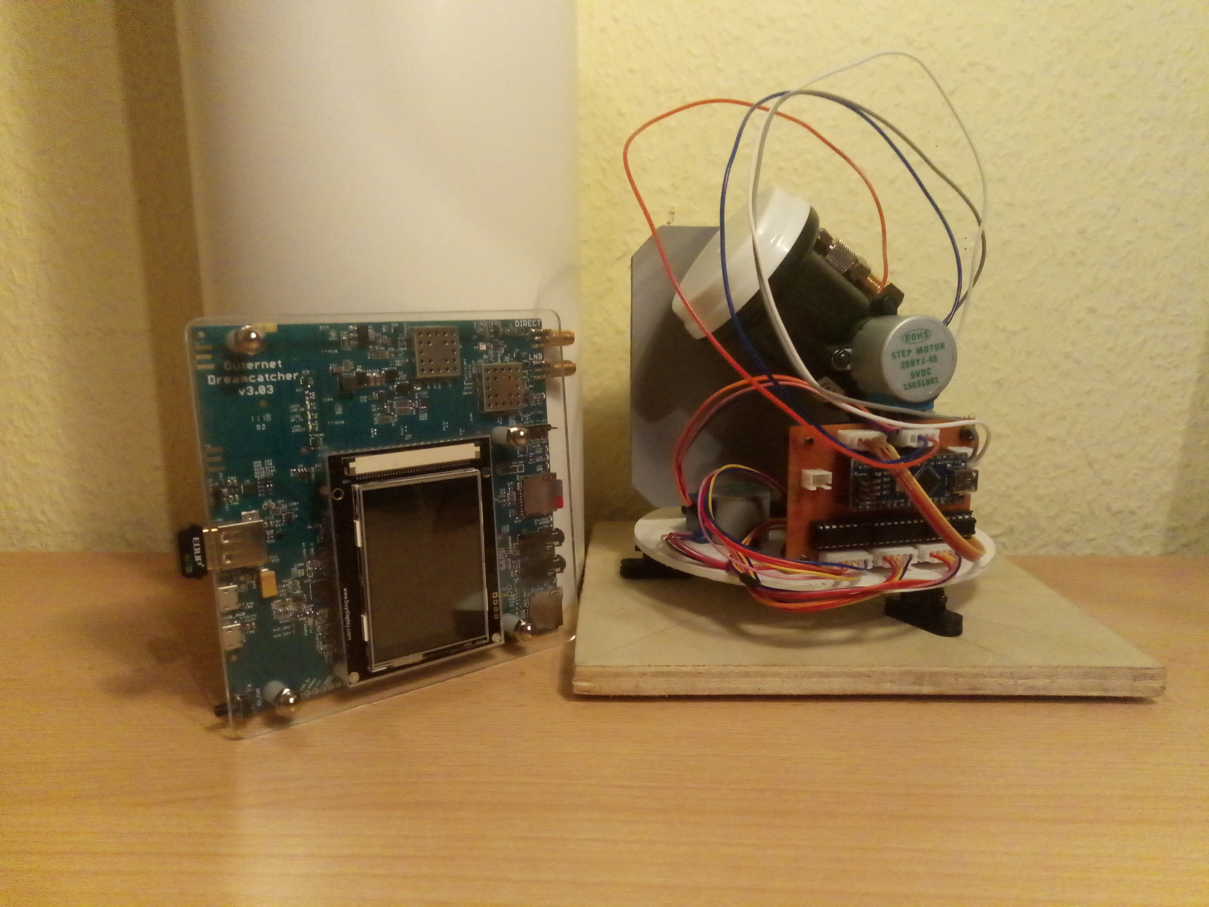

I did a field test today and I get a stable signal now. Here is a video: https://youtu.be/oPjuLpDfgwY But still the magnetic field is a problem. Placed on my car the pointing was way off. Running inside the car it seemed that it mainly detected the car’s own magnetic field. I’ll try to find a setup with my car to do some tests with a deviation table during winter.

@all Thanks a lot for your feedback, I am happy you like it. @kenbarbi A gyro-compass would be way out of budget. I thought about using my boats fluxgate compass which is using the Seatalk1 protocol. I may use this and the internal sensor when the fluxgate is not connected. But I somehow prefer a standalone unit. You would have a device you could take with you, put it down, turn it on and it would start receiving. Like when I am in our marina there are a lot of masts and rigging in the way. But like that I can take it to the beach to receive the forecast there. Or when you want to run it on a boat which has no fluxgate or on a camping van or sth like that. It could be a solution if I could interface the Dreamcatcher to read out the signal strength, then run a pattern around the arduino’s pre-programmed position to check if I can get a better signal and then reset it to this position.

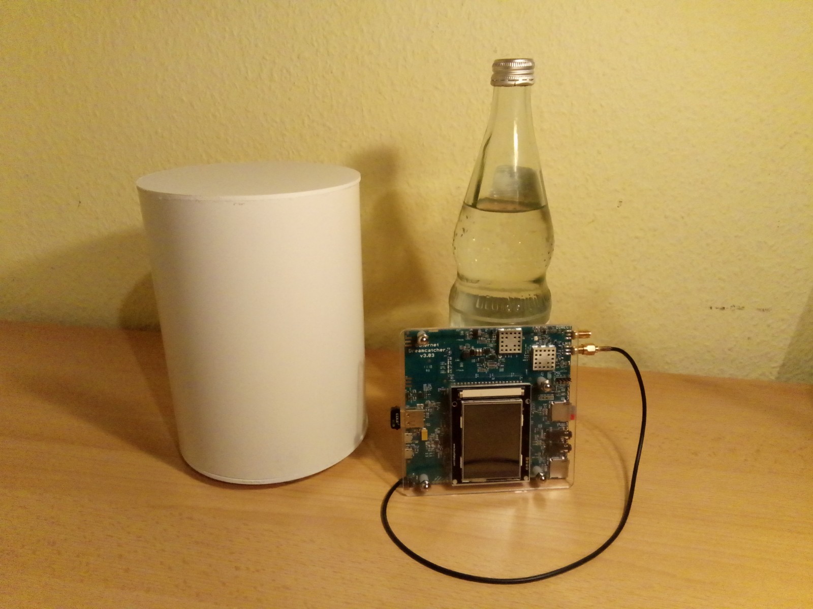

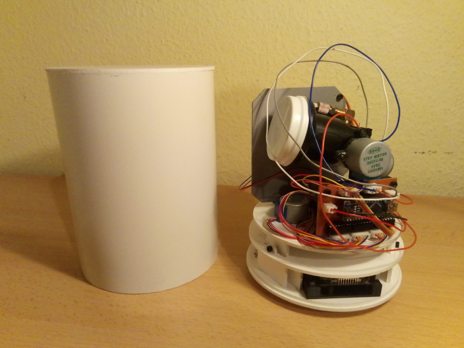

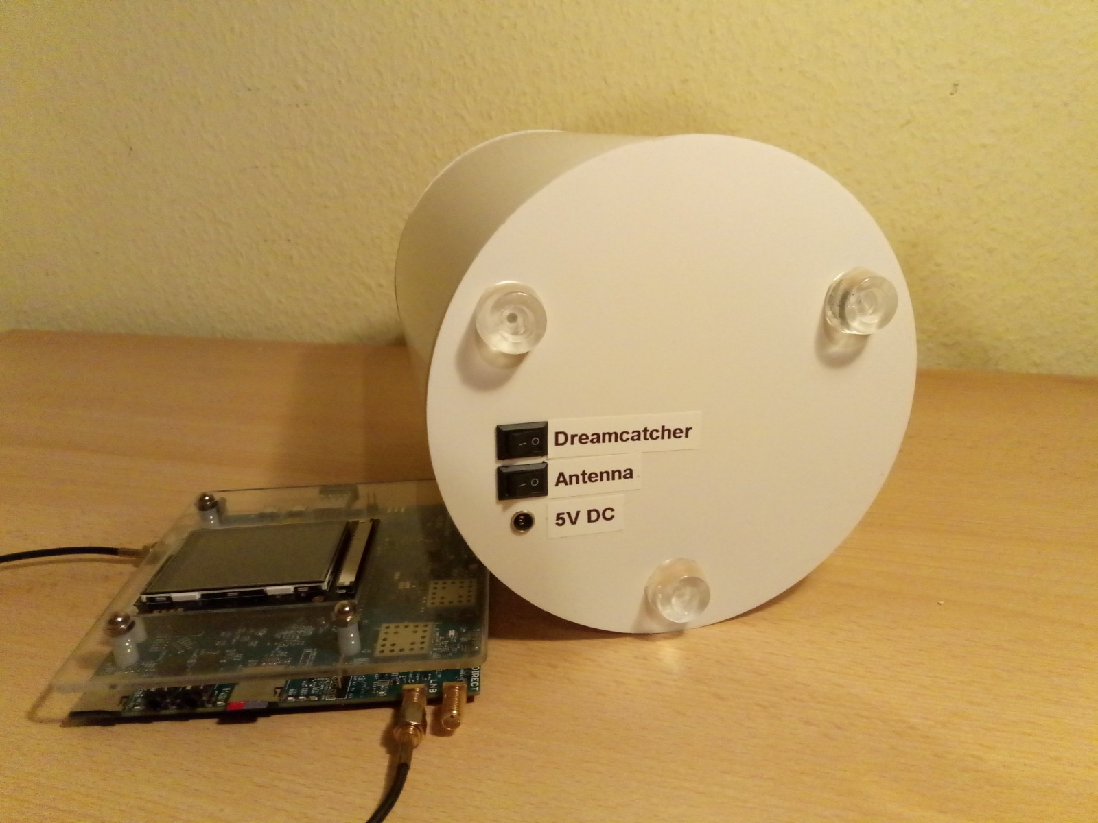

Here is a short update on what I have been doing. The new setup is designed for the Dreamcatcher 3.5 (the grey template) and the new LNB now. I also designed a new smaller PCB and downsized the mechanical parts and reduced their number. The magnetometer was moved away from the motors. I squeezed everything together as much as possible and together with the smaller dimensions of the Dreamcathcer and the LNB it now fits into a PVC pipe I got from the construction market. When ready the whole thing will be inside a cylinder with 15 cm (5.9 inches) diameter and 20 cm (7.9 inches) height, including built-in batteries to use it as a mobile unit as well.
Yesterday I wired and tested the PCB and I hope to have everything finished and working when the sailing season starts again to test it on the water.

Unfortunately, there is nothing new to see. It is just doing the same things as the bigger version. I’ll do the battery part next and then I will make a new video.
Now the new version is finished so far. Everything seems to be working as planned. Action videos will follow soon
That is very slick.
