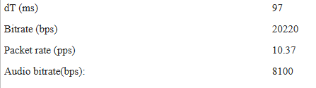

My “America’s” feed is
The 8100 bps is acceptable for most voices… and limited musical scores.
I guess it is a trade-off between the data files and audio streams
