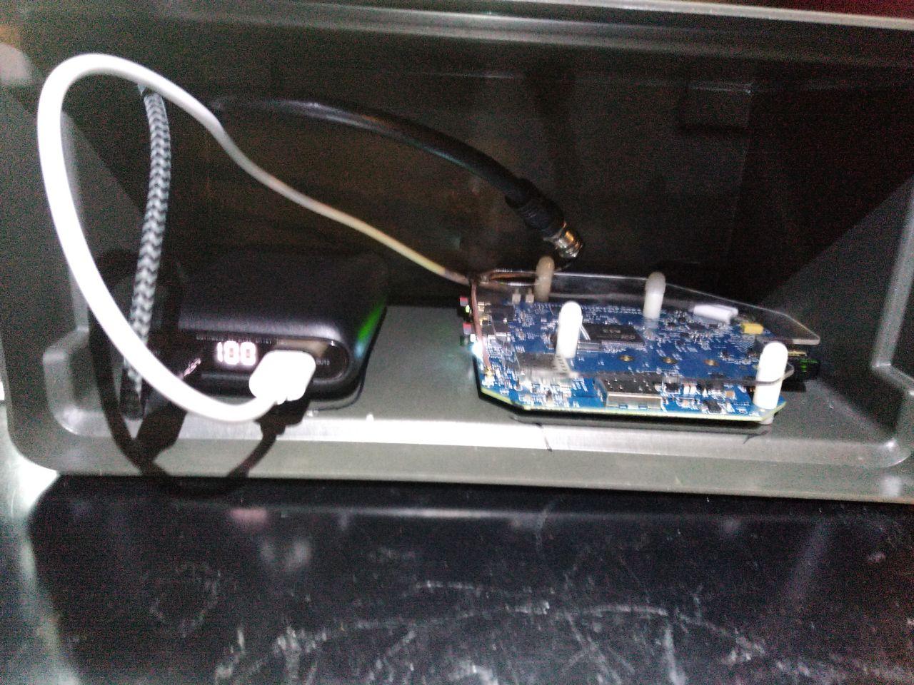

Since I’m running portable, I had gotten a uGreen 10kmAh power bank (since it supports pass-through charging and if it works, I’ve got some RPI projects in mind) and it has a battery percentage readout. I ran the DC for an hour and used about 13% of the power with the initial update grab. That’s all for tonight.

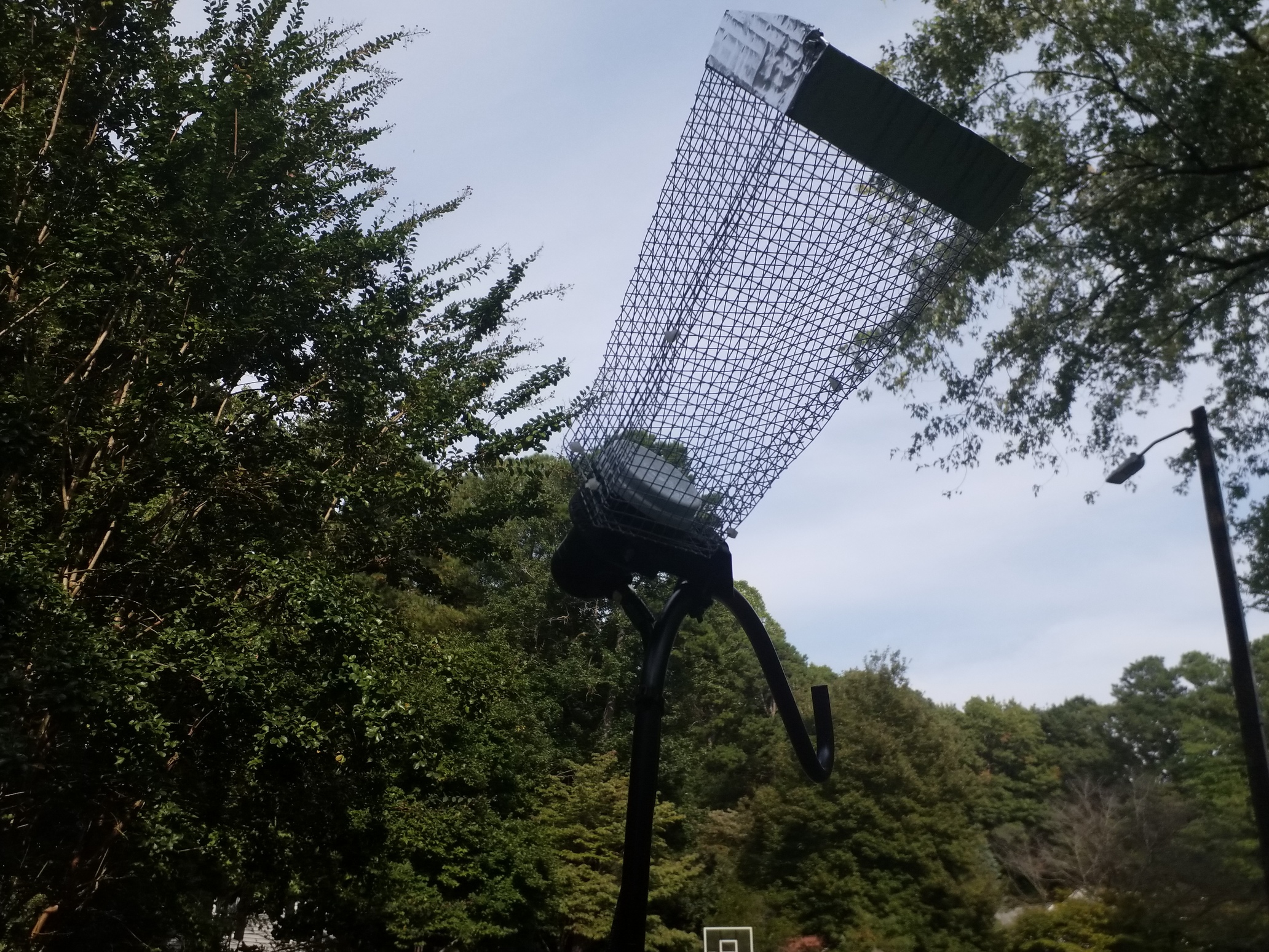

Hey Ken, thanks for the tips. I’ll check the pics I took but I think the Rssi was running around 77-78. I’ve got a spot in the yard I want to test after our next couple of days of rain that should be about 40’. I think I’m going to try the wire mesh cone for the l permanent installation just because of the regular reason we get. The current plan is to attach it to a 6’ shepherd’s hook. Any thoughts on the top of wire mesh?
Wire mesh is a good idea because it has no wind resistance and won’t collect rain. There are several pictures in the Wiki you could consult such as this one made with 4" x 8" x 2" trapezoids in a wave guide form:
or this one made as a cone with similar dimensions.

That’s actually the plan @kenbarbi. We’re currently renting so I’m trying to keep impact on the house to a minimum while working around tree cover. 50’ it so gives me the ability to run it to an open spot in the yard and through a pass through on the window.
I’ve been up on the air for about a week now. I’ve got to bury the cable and put some cut-outs in my project box, but I’m consistently getting -9-11 dB. The reflectix take is more to cover some rough edges.
You did good!! Keep us all posted as you Winter over. Ken

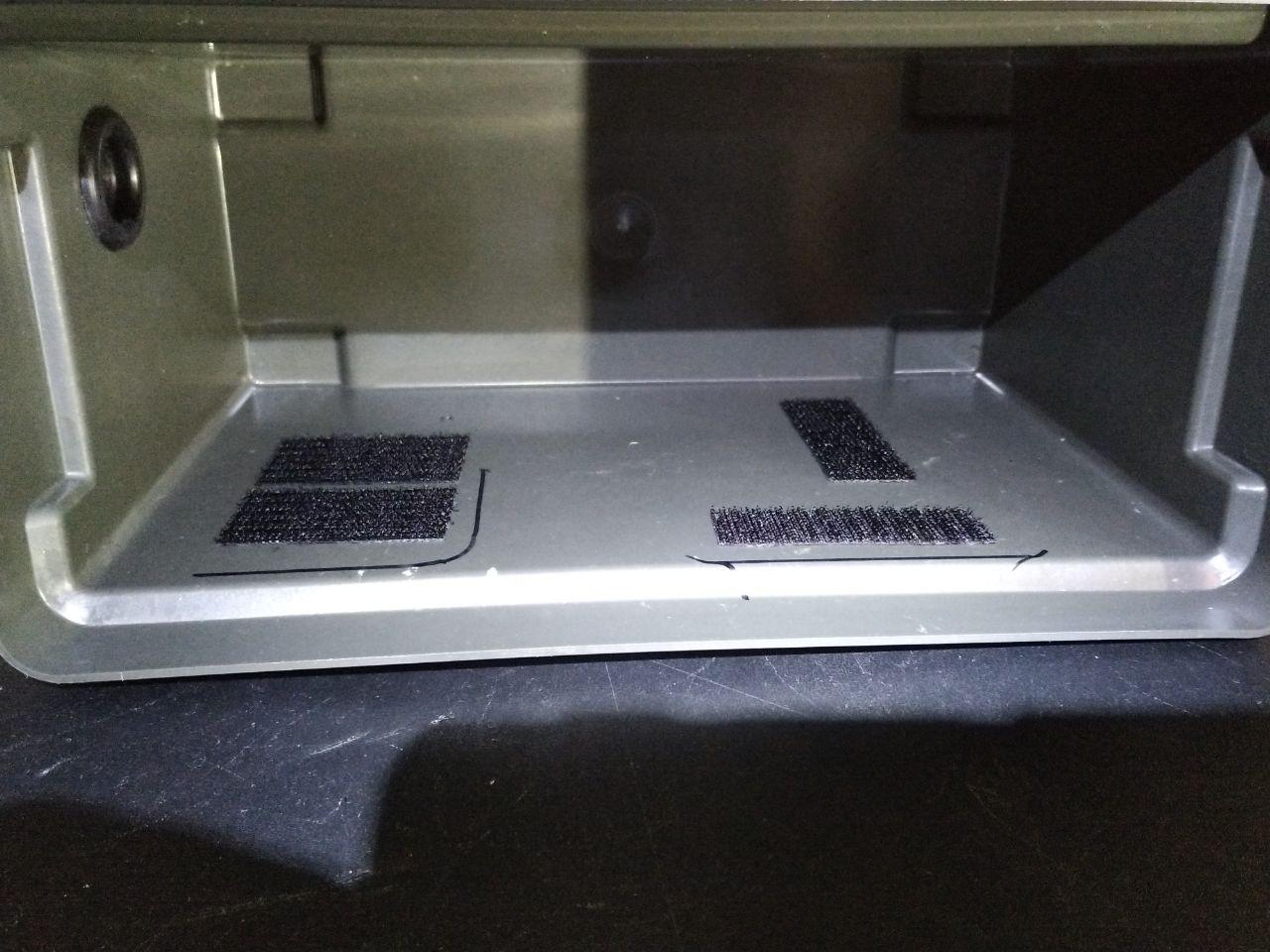

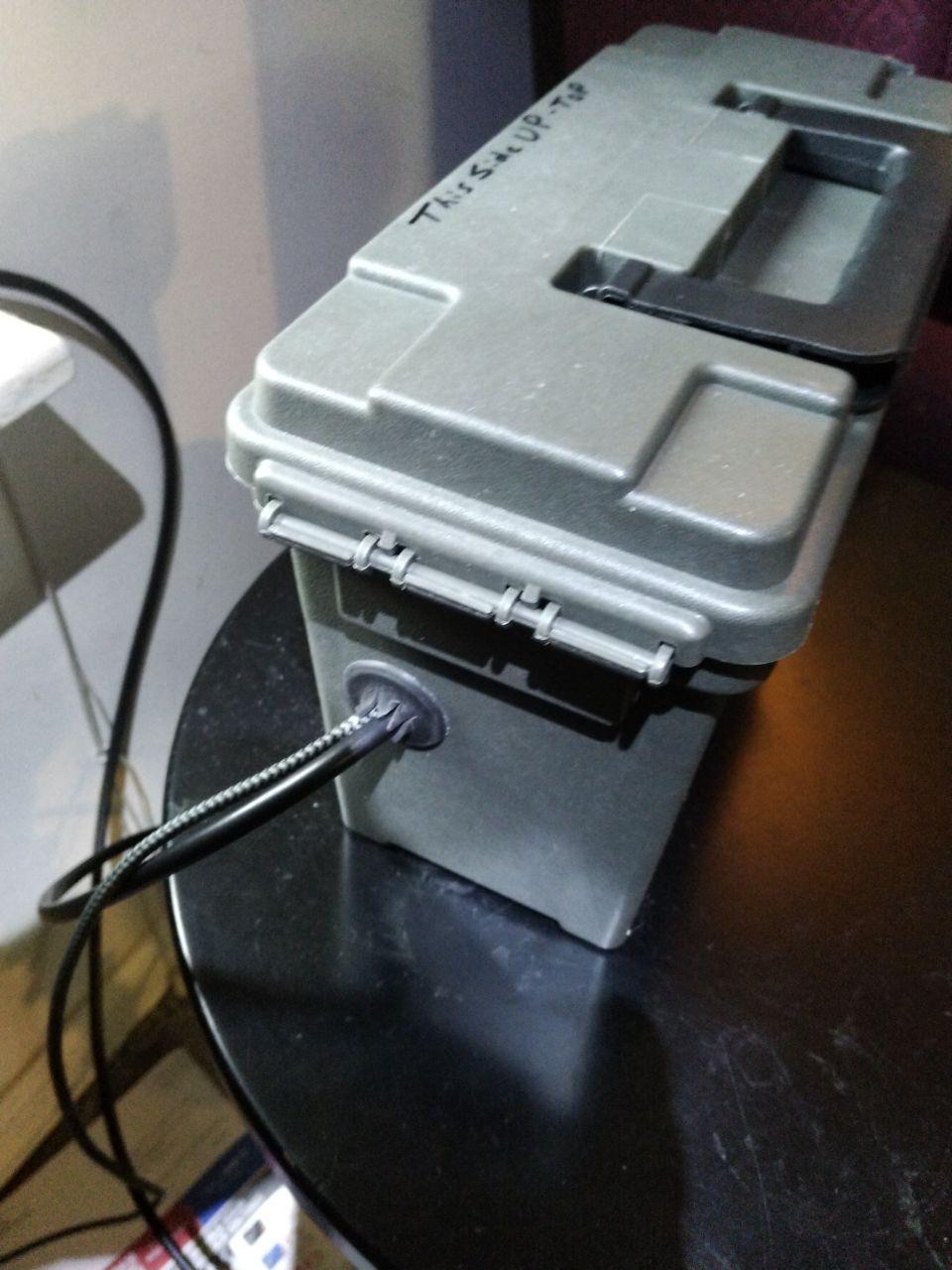

Since I wanted to put Othernet in a go box and my wife wanted her table back, I finally had 5 mins to wrap this up until I can get a stencil to paint the name on the side.
