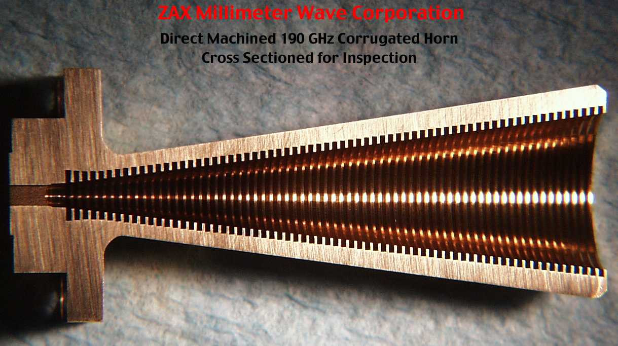

To expand on the what @caveman99 said, the end of the LNB with the cover/lens is a corrugated horn antenna.
At the small end of the horn–and connected directly to the PCB inside of the cast metal housing of the LNB–there is a 1-cm monopole, which feeds the PCB. The F-connector on the LNB spits out a carrier between 900 and 2400 MHz.
