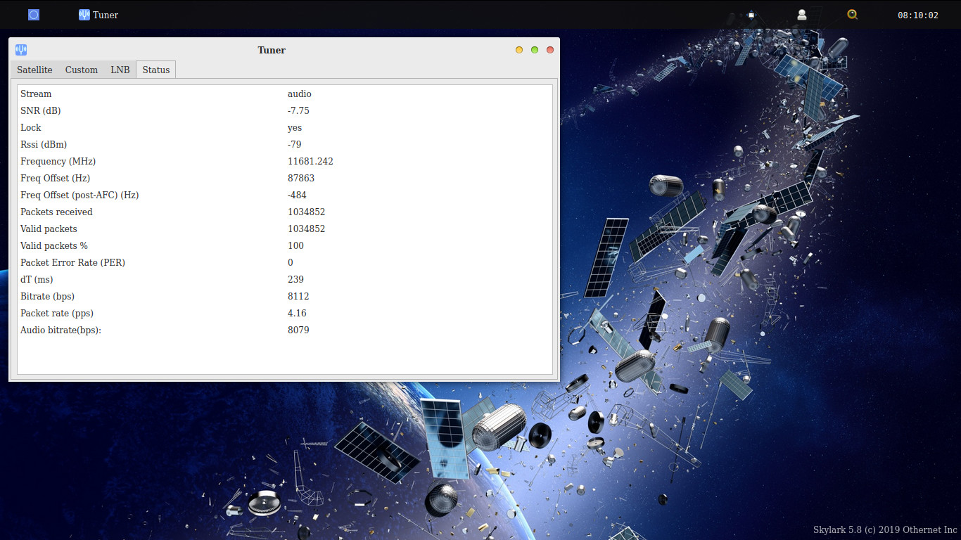

Skylark v5.8 / dc (765ca8b)
built at 2020-03-04 11:29:15+00:00
Sun Jan 24 07:12:06 UTC 2021 up 4 days, 22:01, load average: 0.01, 0.02, 0.04
total used free shared buffers cached
Mem: 250864 247048 3816 36 58104 114744
-/+ buffers/cache: 74200 176664
Swap: 251324 1764 249560
/dev/mmcblk0p4 28.1G 611.1M 26.0G 2% /mnt/downloads
5: wlan0: <BROADCAST,MULTICAST,UP,LOWER_UP> mtu 1500 qdisc mq qlen 1000
inet 10.0.0.1/24 brd 10.0.0.255 scope global wlan0
valid_lft forever preferred_lft forever
[ OK ] Tuner is running
[ OK ] Audio service is running
[ OK ] Local audio is running
[ OK ] File service is running
Last few updates from file service:
[ OK ] Bias-T is configured on: 0x8b
[ OK ] Bias-T voltage is set to 14.2V
[ OK ] LNB power is configured on
[ OK ] LNB detected, normal current flow: 0x23
[ OK ] Bias-T Voltage normal
but I can hear no audio!

Hi Syed,
I use Astra 23B Satellite @ 23.5E
On my D.C. File service is running but i get no files.
My last file download is from 01/19/2021 .
Please have a look for yourself.
Greetings Klaus
