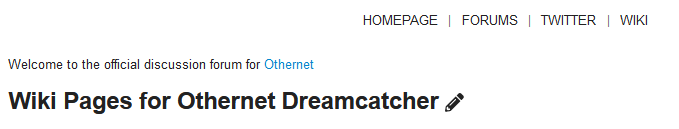

There is a User’s Guide in the above WiKi
that explains the setup/operation of the existing Dreamcatcher v3.05. That device is not sold anymore, but some Forum members may have spares they might provide you. @Syed Syed is working very hard to get the next generation Dreamcatcher out to users, but until it becomes available, there is no User Guide for it. Ken
