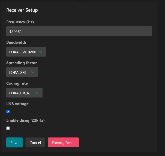

… having i little issue getting the new frequency entered in to the dreamcatcher 4 where when i convert the mhz to Hz which gives me 12058100000 then enter the number it comes back with a crazy incorrect number of 4294967295 what am i doing wrong here…

Are you entering it as 12.0581 ?
For Dreamcatcher 4, please subtract the LO value of your LNB.
Got it thanks for the needed info Syed with the bullseye lnb that i have in use

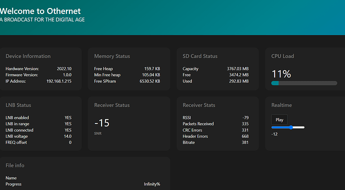

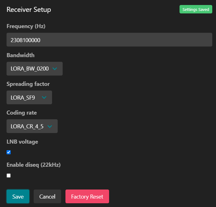

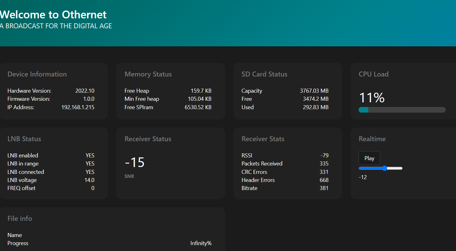

If you have a Bullseye LNB, I “think” the setting on Dreamcatcher 4 prototype should be 2308100000 to start with. Not that mine (with Dish 500 dish) is working yet, but I am getting Packets with CRC and Header errors. -15 SNR and -79 RSSI. (was +3 to +7 SNR before change.)
@BillMc If you were previously getting +3 for SNR, then my guess is that there is a bit of frequency offset. Can you trying changing the frequency +/- in 10 kHz increments?
I finally found the signal at:
2308260000 (calculated 2308100000)
1 to 2 dB SNR and -75 RSSI. Thanks…I just had to be persistent.
