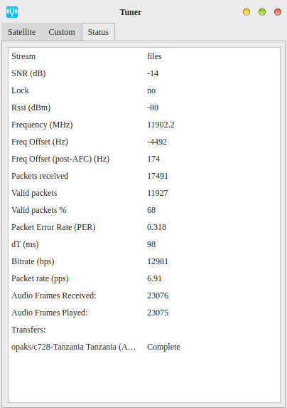

How is the sound quality for everyone? I have a plain naked LNB pointed at a tree line, so my SNR is -15dB. At that level, the sound is very skippy; not possible to make much out, but there is sound coming out. Just a simple shroud would give me the extra few dB I need.

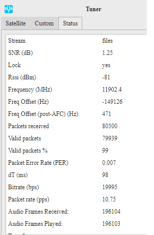

Sound is nice and clear, I get quite a bit of looping and stuttering though. Is there anyway to prevent this? I am getting 100% audio. I am using a DC 3.02.
On my 3.02, after a re-boot, the audio started, and sounded good for a few seconds, then began what @kb2sdrjay Jason referred to as looping and stuttering. I only had a limited time to listen this morning, however, so far what is coming out of the audio jack is not usable. I re-booted a second time, but it did not seem to improve, but I will check it off and on to see how it is going. What I was able to hear was not bad quality, as far as the sound itself; it just seemed to have a problem playing through.
I had to reboot this morning when I saw audio in the tuner tab. Nothing was coming until I rebooted. The same for yesterday as well.
What is the SNR that you both have?

Yes, I’m having trouble with audio also. Stuttering and looping. At this time SNR is better than -1. RSSI is -73. Valid packets is 100%. Audio packets received is 1 count difference from audio packets played.
Like: 47180 received, 47179 played. When in a loop, the count stops. A loop could last over 5 seconds. Stuttering very annoying too. I know the Team will fix.
My SNR is varying from -11 to -13, normally running -12, RSSI at -83 -84. All symptoms similar to @kb2sdrjay and @donde. We are having some weather-related interference just now, but not severe.
I’ll talk to @Abhishek about the stuttering on Monday. I thought it was isolated to myself, due to being at -15dB SNR. But if someone with -3dB is experiencing the same issue, then it must be related to something else. My Dreamcatcher also locked up after about an hour (or less).
@Syed My SNR is + 1.5 .
