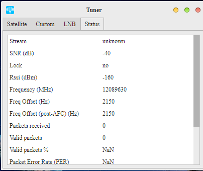

In answer to Maverick Single LO usage, I have applied the same Fine Tuning Technique I used on the Dual LO (which worked fine). I get these results consistently after honing in with minimum Freq Offset on the correct operating frequency set in my Custom Tab as 12.089280767 GHz. Consistent fluctuations, but no LOCK . I know Syed said using the Maverick would be more difficult, but this seems to show something else going on. Ken

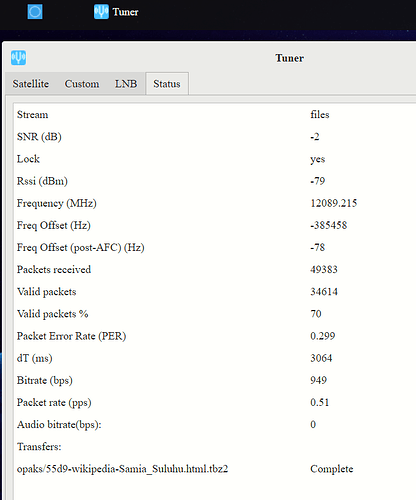

I am excited… I got a lock using a Dish TV lnb18… the dreamcatcher corrected almost 400,000
offset.

I am also excited… I got a lock using a Maverick LNB and with the help of Manuel (thanks)
… now fine tuning is required/needed.
Well -40 isn’t a realy lock as i said before, the Maverick is just not the best thing i would say.
But good luck anyways, getting anything at all is a step in the right direction.
I had your same experience. It look promising but never achieved Lock. That’s when I changed out my LNB. Ken

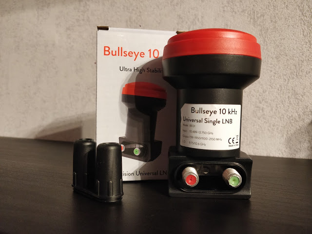

[Bullseye 10 kHz Ultra High Stability Universal Single LNB]
And you mention ā€œDual LNB:LOā€
So you are talking about a device that has TWO connectors, NOT a single LNB
Interesting— ā€œfor this subjectā€
My understanding was an LNB single/duel related to the rj58 connectors.
It would have been my belief the image below, has two rj58 connectors, therefore is a duel LNB.
Yes, but …I read the image ā€œsingleā€. …arrrrr

Just get a Bullseye LNb it is the recommended LNb and it really works very well.
DONE !!! Thank Manuel

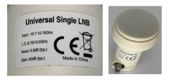

I’m talking about this LNB:
that came with the Dreamcatcher v3.05. It has the stability of ± 200 kHz. Ken
that should be okay as well i guess. Seems like a similar LNb that i used so far for Othernet.

What I mean is, I get the Status TAB filled in with information, but the Lock line shows either intermittent Lock/No Lock or just No Lock at all. With the Maverick, I’ve never been able to tweak the Freq so I get Lock. Ken
