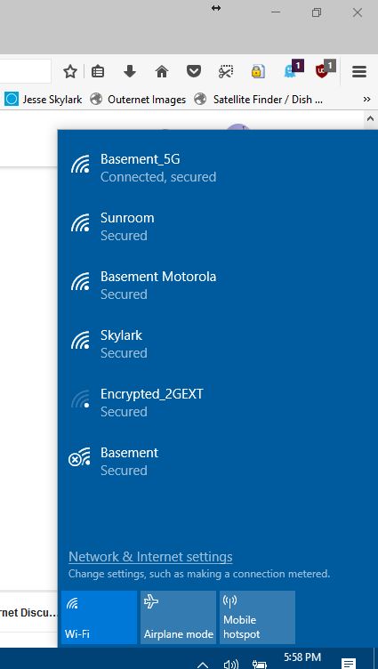

I can’t show you the Outernet Wifi because I am now connected thru my house WiFi, but in Windows 10 you get a screen like this showing the available WiFis - - Outernet should be on it (don’t worry about the Skylark WiFi you see - - that’s a local repeater I set up).
Are you trying to connect to the Outernet from the very same PC as you are writing on this forum?
If Mike is - - he’s on the wrong WiFi. Ken
