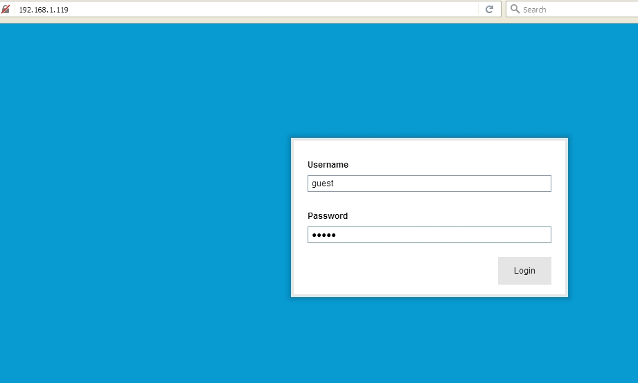

You mean this - -
Login as Outernet with password outernet (all lower case). Ken
do you mean log into my router?
Send me a picture of your screen. You should be seeing the Skylark logon screen (above) in your browser. Ken
This site can’t be reached
192.168.1.119 took too long to respond.

No - - 192.168.1.119 in my router’s assigned IP address for my DC - - it will only work at my house.
Are you connected to the Outernet WiFi hotspot now? Ken
