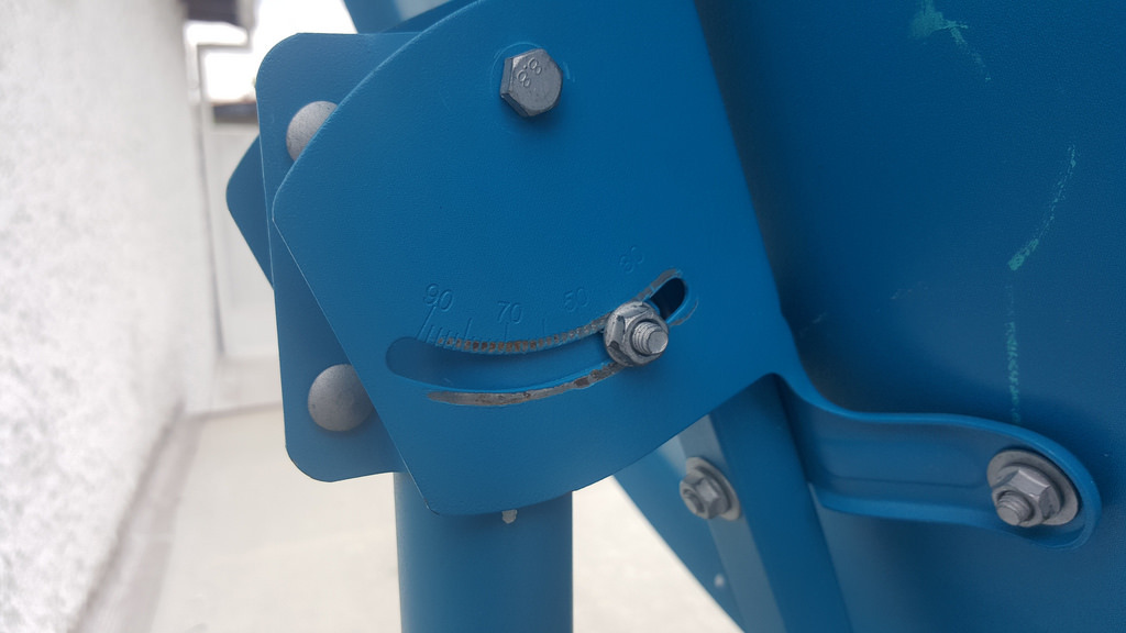

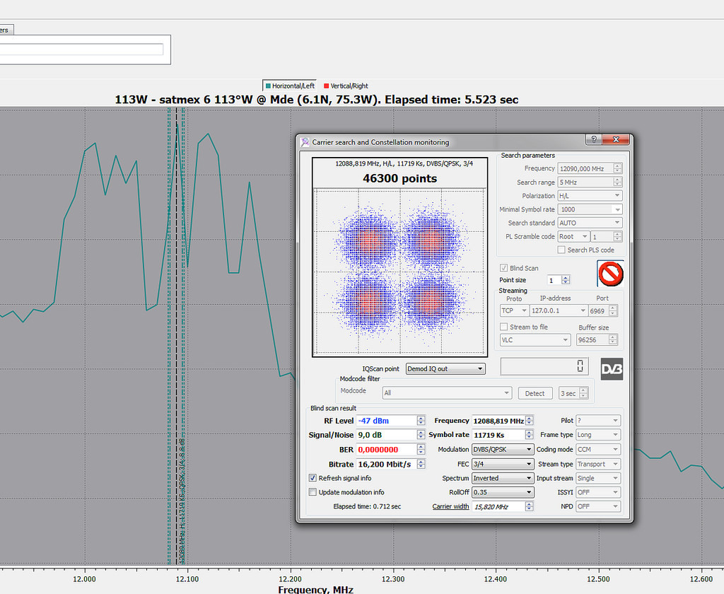

finally i get 113w with a 60 cm dish ![]()
final elevation , its like 40 not 46 (for my antenna installation
rf scan
rf scan

Great. Well done. If you donāt mind, did you ever put your location into a pointing website? If so, what elevation did it recommend?
It will help me reconcile the various markings on different dishes, to true elevation angle.

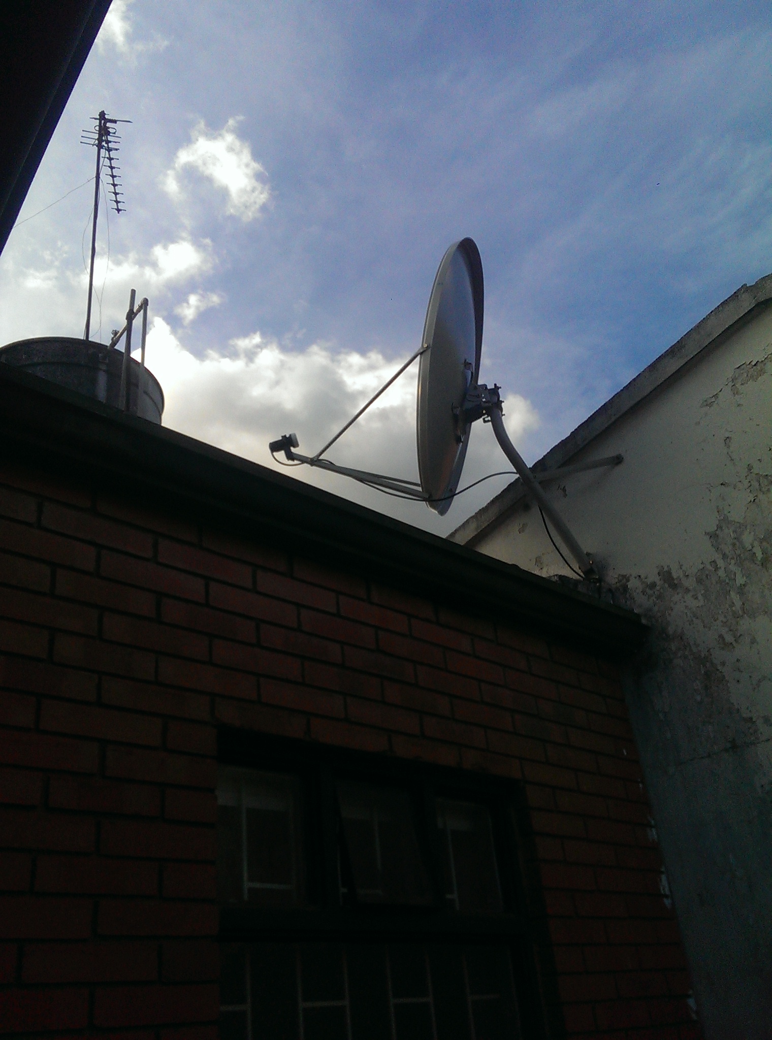

the dish is on the wall, not on the floor . and the wall its so badly done with mini mountains ⦠I suppose that the base is not 90 °
here a pic of the wall, and . put the base of the antena on the wall, was very difficultā¦

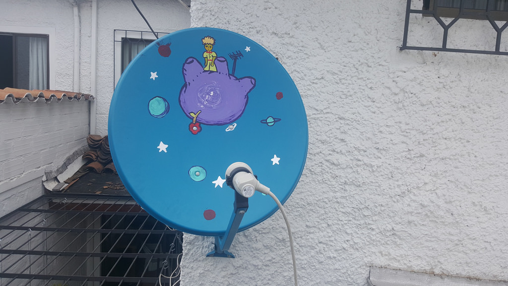

Thatās a beautiful dish.
SSH username/password are both outernet. The user account has sudo rights.
@kalashnikov indeed that is a beautiful dish :Dā¦

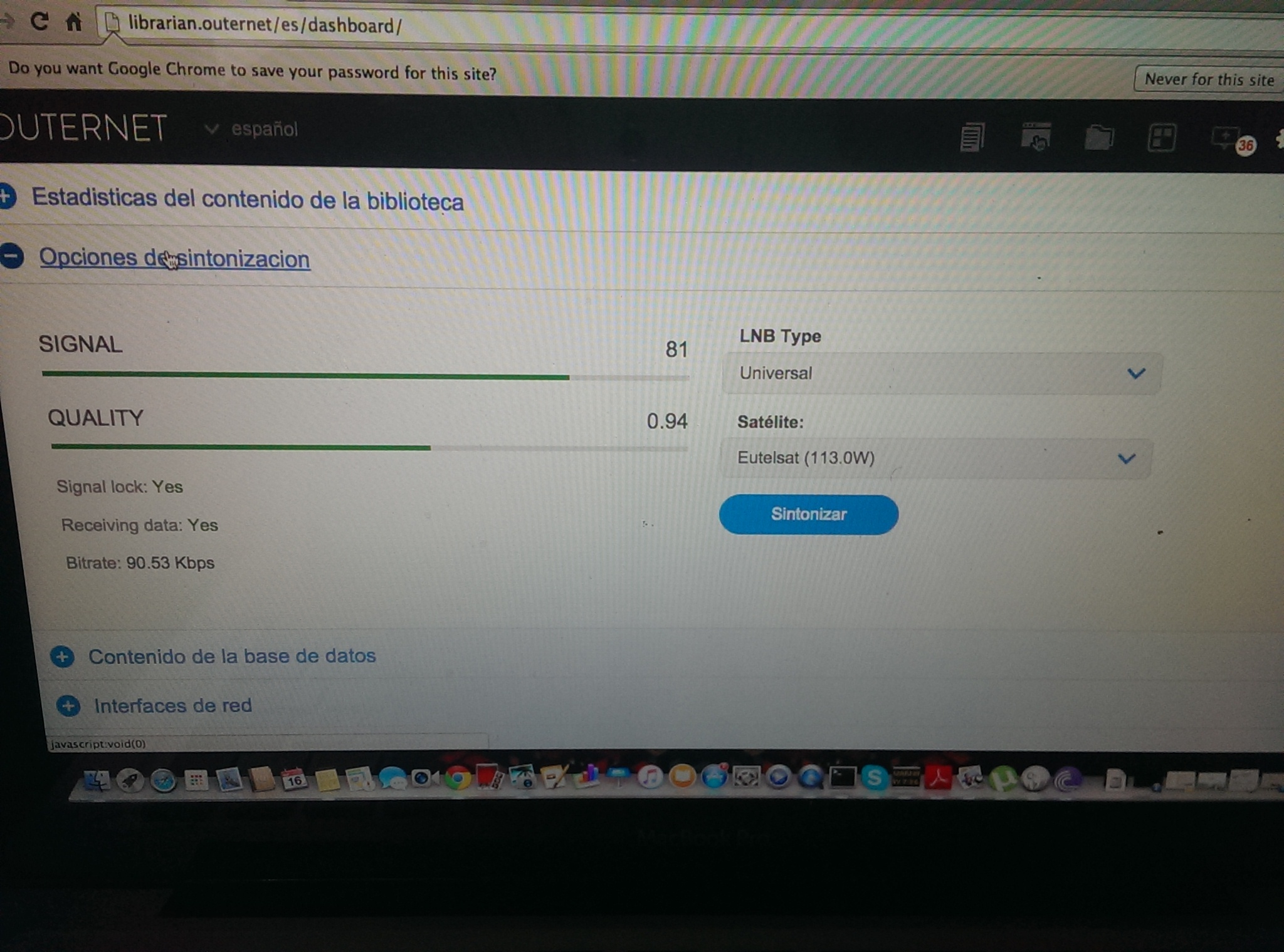

la seƱal no sube mas del 81 ? es raro que con 30 cm mas de plato solo suba el 10%, mi seƱal con uno de 60cm, ya hay seƱal pero tengo mis dudas si quedo bien afinada. pero quedo trabajando ![]()
lo otro es que puedes actualizar tu lighthouse a la version 1.3.0
saludos
voy actualizar la version, ya veo que esta disponible la 1.4, muchas gracias por la ayuda. y revisarse haber si puedo afinarlo un poco mejor

@kalashnikov are you using any special paint to decorate the dish?

y la pintura es acrĆlico normal, que la antena este limpia para poder pintarlaā¦
