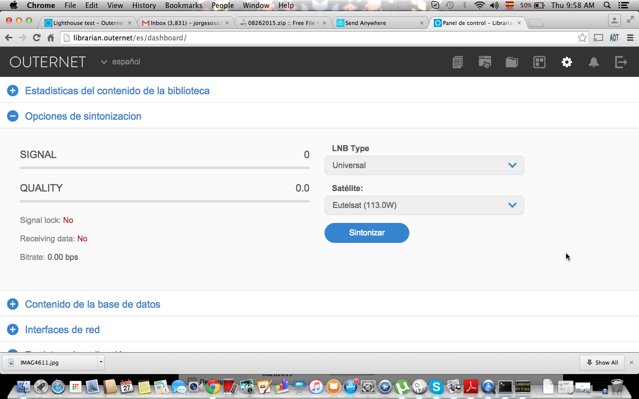

It appears you are using North America Ku band LNB in the settings. You should be using Universal, based on the photo you posted.
We have tested with both but it doesnât connect

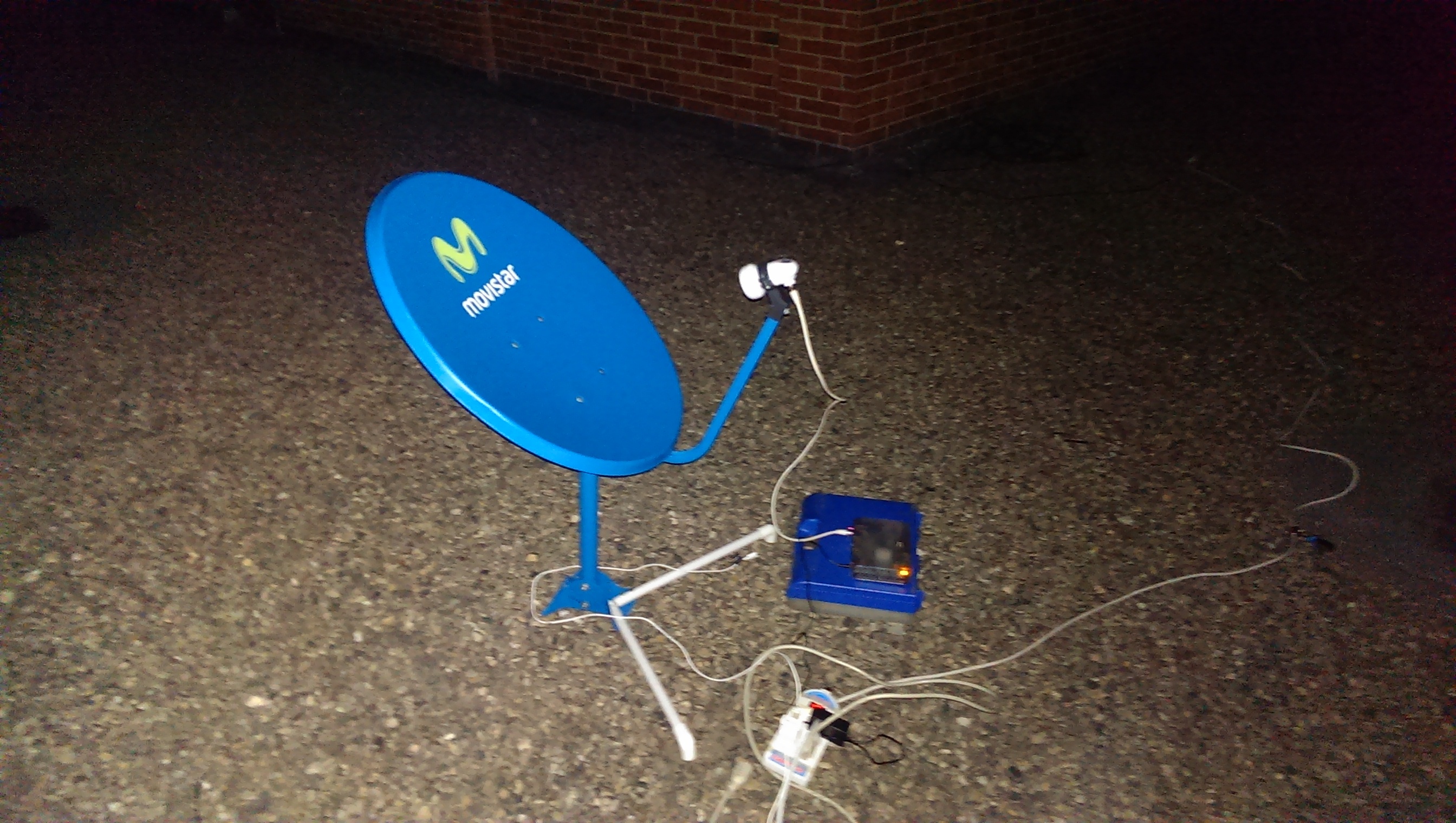

To see your picture, I have the feeling, your dish havenot a correct elevation. I dont know what is your location, but if you put your city-s name and your street address, and the name of the sat you want to points in this web page:
you will get 2 main values:
One for the elvation. This is the direction in grads, where you will see the geostats satellites âbeltâ from your location.
And this is the direction, where you can pull up your dish, more exactly its âmain axisâ. You can imagine, where it this axis is, and you can measure this elevations from the horizontal line/water level. On your picture it seems me this direction is too high. For a rough check, you can look around, find another dishes, and you can check theirs approx directions/elevations.
If you find this elevation, where there exist the satellites, you can deal with the second calculated value at the dishpointer site, this is the azimut value. If you fill the form with your exact location, you can see on the web site the exact diretion pojected to the google map of your location. If you have an iPhone, its compass application you can find easy this direction in the real situation.

the movistar dish of 60 cm it is very small
you better use 65 cm o 90 cm dish
I also have problems tuning 113w with a 60cm dish , It does not give sufficient strength.

Jorge, can you give us your locationâs elevation in degrees? Looking at your dish, you must be near the equator, and the sat virtually overhead.

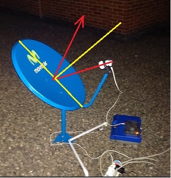

You have an offset dish, so the angle to the satellite is not the same as the direction of the dish. Below hopefully helps.
Yellow is a line perpendicular to the dish, red is the direction to the satellite. Some dishes take the offset into account, and the markings on the elevation axis directly correspond to your elevation from the equator. It is only a couple of degrees from maximum to nothing.
I donât think smartphone apps are accurate enough. You can use it to get the rough direction, but a satfinder will give you much better indication of correct pointing.
IMHO, if you are virtually under the satellite, a 60cm dish should suffice, but try to find a footprint diagram for 113W, which gives EIRP (power level) to dish size correlation. Generally, the further you are from the centre of the footprint, the bigger dish you need.

Thank you very much everyone for all the information, I am in Bogota, Colombia South America. we have contacted a directv technician an he has indicated the same thing you are telling us. we need a bigger dish as the satellite is very far. And he has told us, that even if we have a bigger dish, it still will not be an easy task. We have used the same website as kalashnikov(http://www.satbeams.com/footprints?lat=4.687502&lng=-74.068161&zoom=1&beam=5528&type=normal&name=oficina). And we have decided to buy a 90 cm dish, and it will arrive today. We will make tests and hopefully it will work. We will keep you posted on any update.
