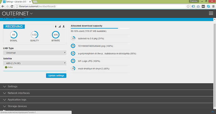

An interesting find - - I have not been able to complete a download of Lighthouse Version 3.0 from Galaxy 19. I keep getting a 99 % level as shown here

Lighthouse Outernet-rx-3.0 finally completed its download during the night - - [2016-04-11 04:52:53 (+0000)] DEBUG Notification received for updates/wt200/outernet-rx-3.0.pkg]
It shows 100%on my Tuner Setting Dashboard now. Otherwise Galaxy 19 is working fine here. Ken
That’s great news. It probably missed the last few packets the first time, and had to wait for them to come around again.

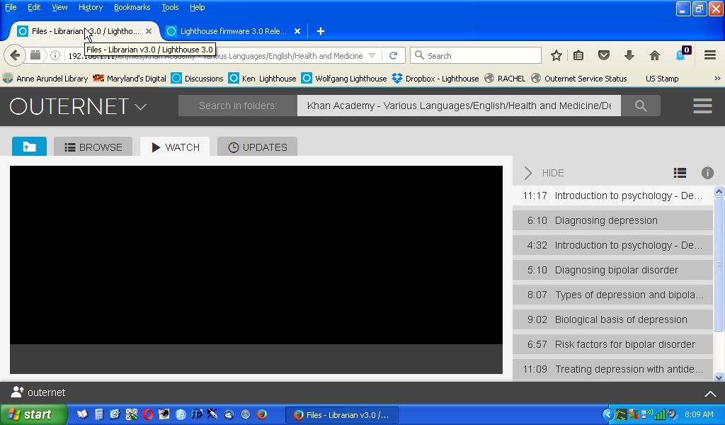

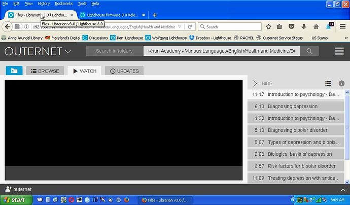

I have not been able to play any of the videos downloaded recently. I have an updated Flash Player and tried Opera and Firefox. I download fine from the Lighthouse, but can’t start the playback.
Here’s all I get:
I tried the same thing on Wolfgang’s forwarded Lighthouse with the same results. Any Ideas? Ken
Can you download the file and let me know if it can be played locally?
After downloading the file to my computer, ! was not able to play it as a audio/video - - I only got the audio portion.
I used Real Audio and Windows Media Player on my Windows XP machine. On my Windows 10 machine, I used Windows Media Player, and Win 10’s TV & Movie App.
In all cases, I just got the audio. Both machines (XP with Firefox, and Win 10 with Explorer). Both machines were unable to render audio or video in the Librarian Program. If it helps, I have sent you the MP4 download of 00004-Preventing malaria.

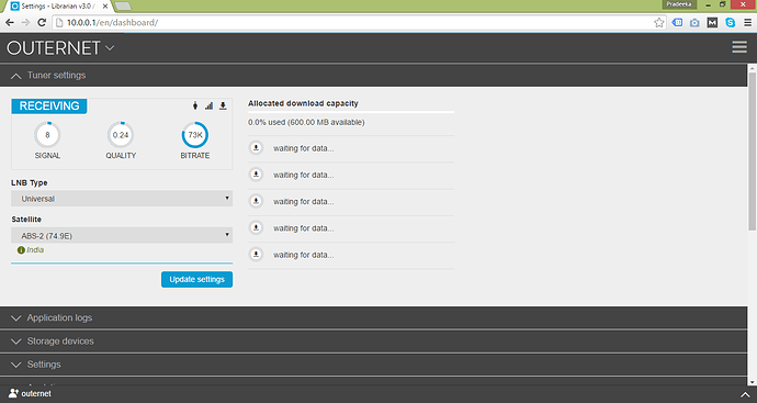

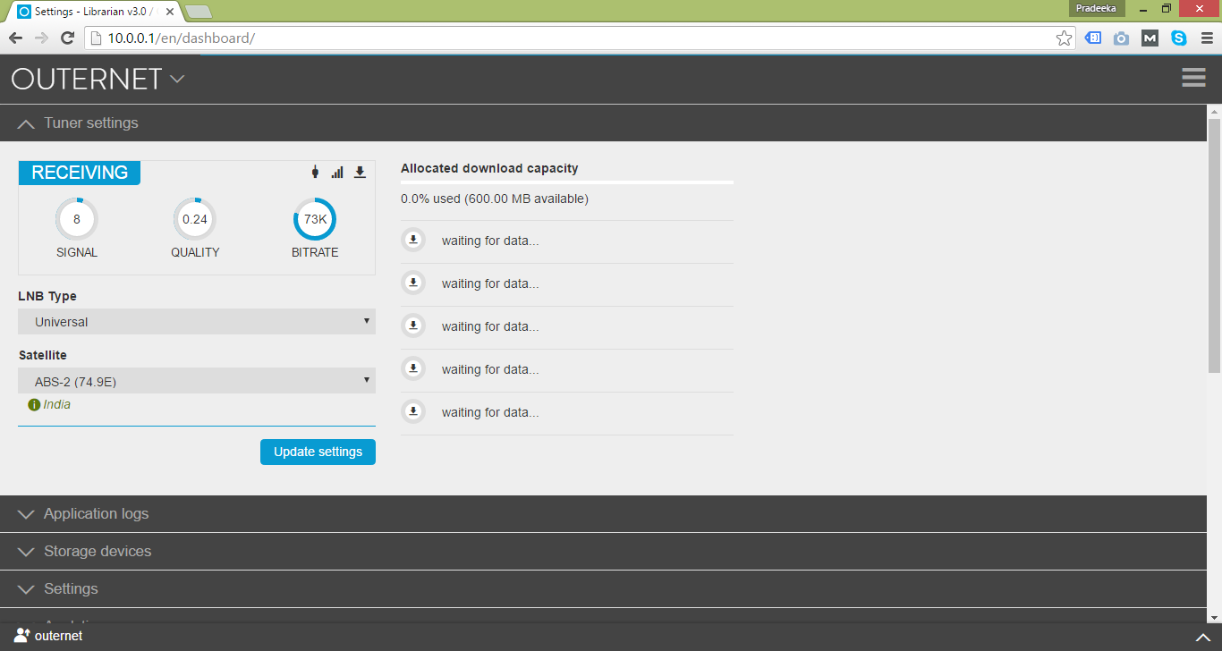

@branko For the same dish setup ORx reports very lower signal strength and quality. It is still waiting for data.
