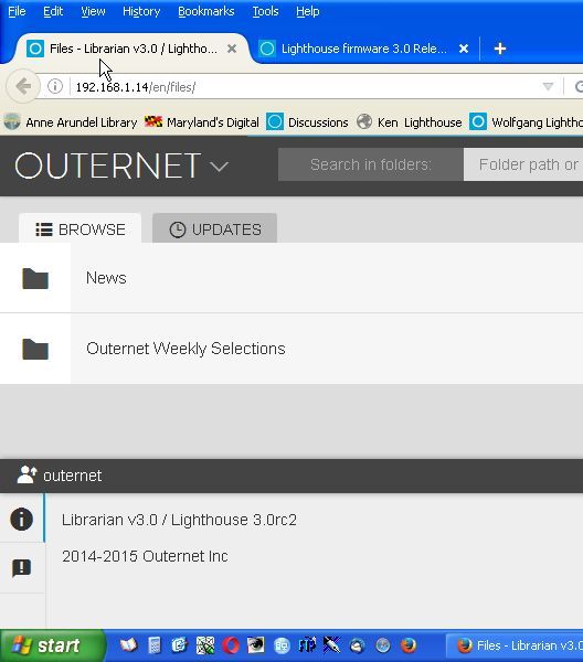

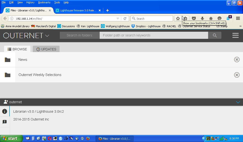

Unfortunately, my Lighthouse won’t let me go back to Version 3.0 from Version 3.0rc2. Otherwise, my Librarian looks and works as it should.
Can you do the greps please? Version 3.0 should be considered a newer version than rc2. If that’s not the case, it’s a bug.
For example, I have a development box that was on rc2, and it is now updated to 3.0 without my intervention.
I can’t get Version 3.0 to install over the Version 3.0rc2, so the greps remain the same - - no files found. Ken
