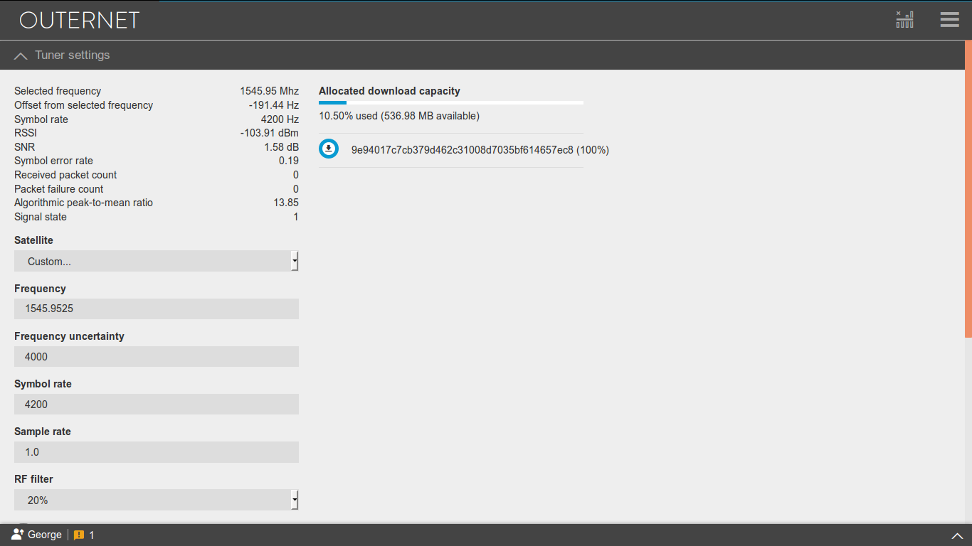

I have not shifted the antenna or moved any wires for the last few days. Sometimes my DIY Outernet receiver is getting very low SNR readings ie 1.5 SNR
Is there a weakening of the satellite sent signal strength or is it something to do with the Ionosphere or angle of sun etc.
Should I reset the unit when I get these low SNR ratios.
Could this be caused by the download testing Outernet is doing?
Working great now. Spot on. Thanks for the feedback and congrats to your team.
@Seasalt Yes, just the day passing can have an impact on SNR. But to go from 7 to 1.5 is really extreme. Has the SNR gone back up? Have you noticed any patterns to the fluctuations?
Although the SNR is enough to close the link, we don’t have that much link margin, so any kind of anomaly can impact the signal and reduce the quality of reception. I don’t know much about all of the variables that can impact the link.
When in doubt, reset. You can almost never cause harm by resetting. But with issues related to SNR, I doubt resetting will do much good. The SNR fluctuation is independent of whatever we are bouncing off the bird.
