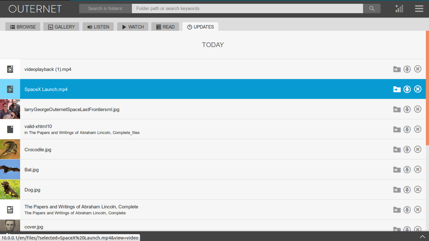

Now we got video.
Both the SpaceX and the Paper-plane worked perfectly. This really is 2kbps of exciting technology.

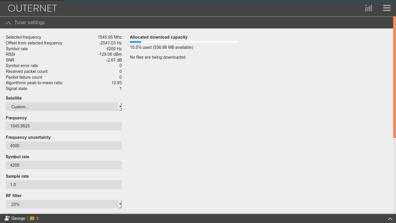

Syed could you please explain what the
Algorithmic peak-to-mean ratio 17.94.
Does Outernet software tell me how much forward error correction is going on?

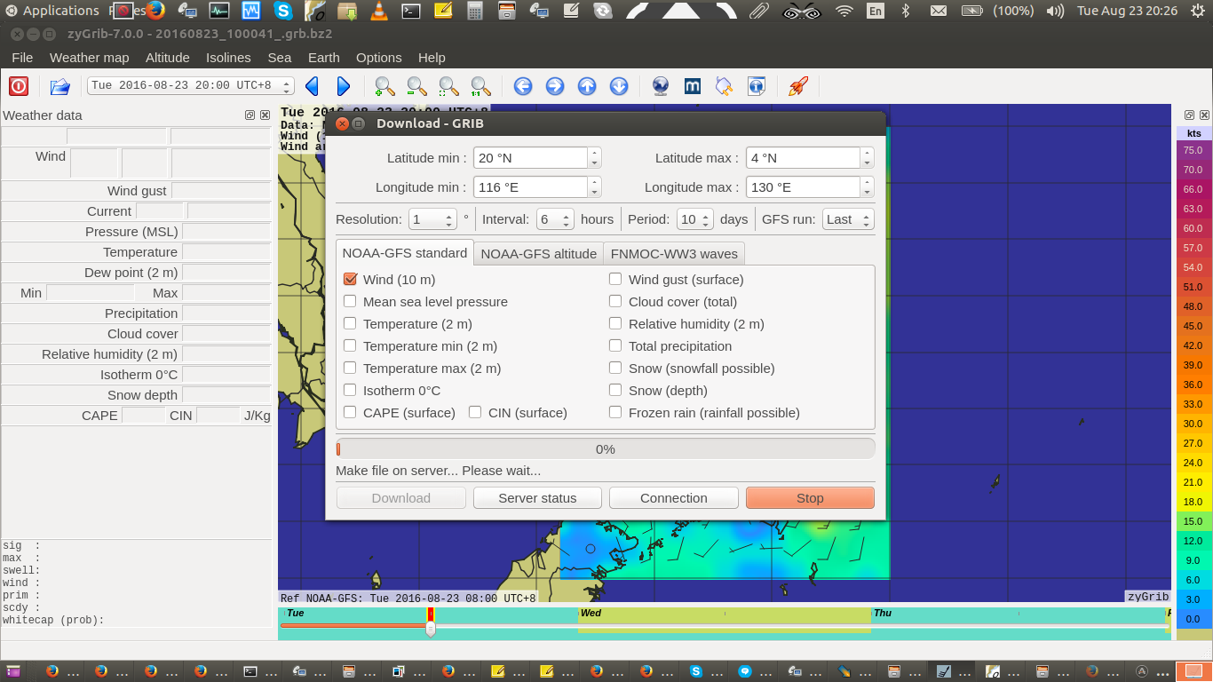

I use a program called Zygrib to go and get the geographical piece of the grib data file I want. Pic attached.
NOAA or another agencies has a sever on the internet that houses the latest grib prediction runs.
I think they do a world weather prediction every 6 hours.
There is also a new Grib 2 format that apparently has some new features like the ability to join grib files together to form a larger data set etc.

Nothing is coming now . I have done the Bias T mod on my RTL-SDR dongle and connected the second LNA-filter I bought from Outernet to it and connected the Outernet antenna.
It is unable after 12 minutes to get a signal Lock.
Do I need I need to change any parameters to use the RTL-Sdr.com R820T2 dongle.
There web site in the comments section stated that the new driver that helped with the overheating was installed in the Outernet software, So I assumed I could just substitute it and plug it into the CHIP

Did the green light on the amplifier turn on after it was connected to the modded RTL-SDR Blog radio? If you manually soldered the bias tee jumper, then you are using V2, which does not require any driver changes. Even if you have the most recent V3 radio, you are right–our firmware does have the modified driver.
First thing is to make sure that the amp’s light is on.
