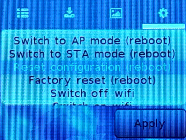

The second has to do with Resetting Skylark’s Configuration files. Doing that sometimes fixes unusual performance issues. Go to the Touch Screen on the Dreamatcher board’s 4th panel, and do a Reset configuration (reboot) The screen is hard to control with a finger, but be patient getting that line to come up highlighted - - but once it does hit Apply.
After you do that, you’ll have to set up Skylark again. This step has helped others upgrading from Version 5.3 to 5.5 getting Skylark to recognize Client Wifi networks, and stay connected properly as you select the different App Icons on the Skylark screen.

I did the reset config reboot this morning before work and it seemed to have worked all day so far. While reading through the posts, I saw that some errors were prevented by taking out the data storage card. Is that still applicable with this version? I was going to put some PDF’s in there but if it causes an issue, I can forgo that. Also, I have never really been able to manipulate the weather app. The only thing I have ever seen is wind directions. I am sure that it does more. Is there a way to get a NOAA type radar or satellite image?
