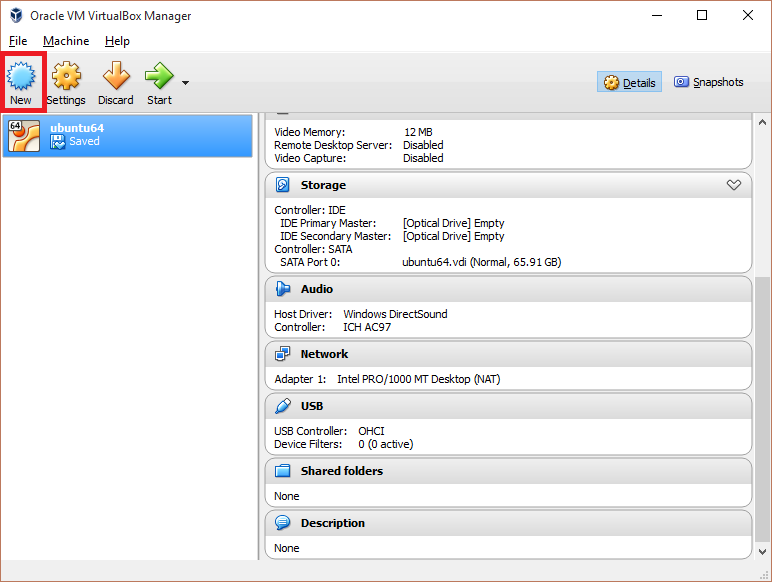

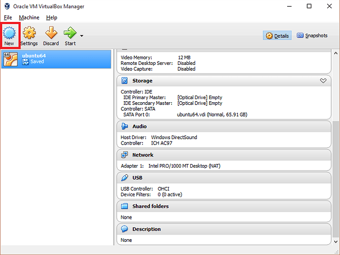

On the tool bar click New button.

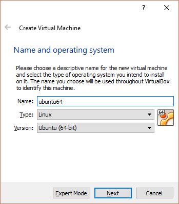

Name and Operating System: Give a name to your virtual machine, select Type as Linux and Version as Ubuntu (64-bit). Click Next.

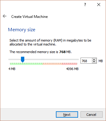

Memory size: The recommended memory size is sufficient. Click Next.

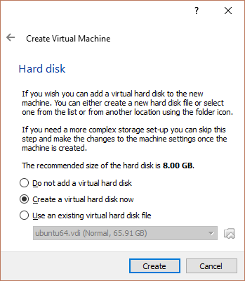

Hard disk: Select Create a virtual hard disk now (this is the default selection). Click Create.

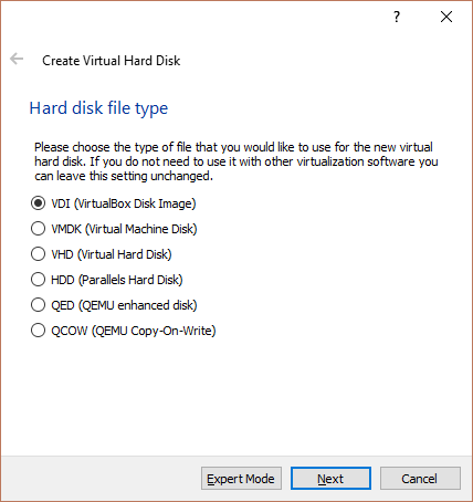

Hard disk file type: Select VDI (VirtualBox Disk Image). Click Next.

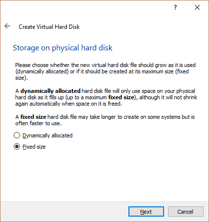

Storage on physical hard disk: Select Fixed size. Click Next

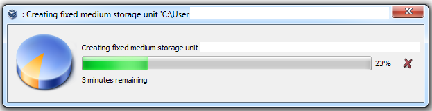

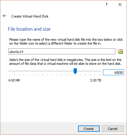

File location and size: Allocate reasonable amount of disk space. The default shows 8 GB. But I have allocated 60 GB. Click Create.
The process will take some time depending on the disk size.

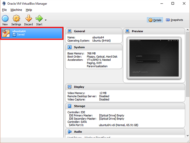

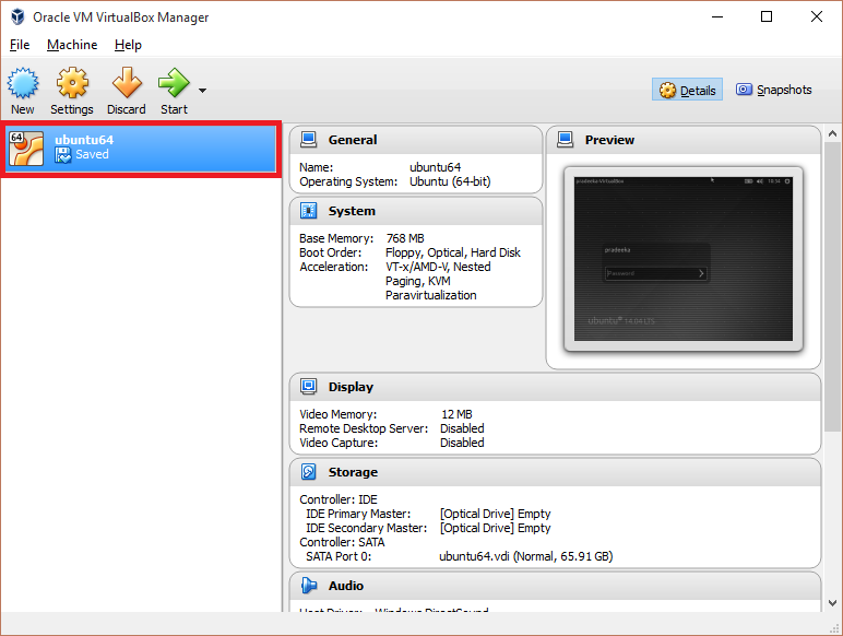

The new virtual machine can be found in the left pane. Click on it and on the tool bar click Settings button.

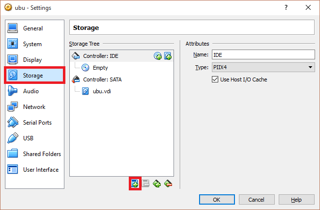

In settings dialog box click Storage, then click Add new storage attachment icon. From the menu click Add Optical Drive.

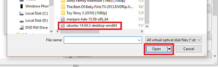

Click Choose disk button.
Browse the downloaded Ubuntu image file and click Open.
Finally click OK button in the Settings dialog box.
