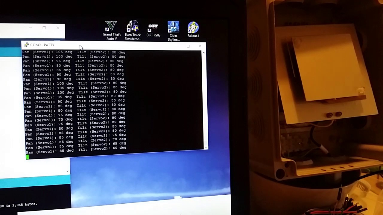

Here’s my setup for the antenna. From my northerly location I can “see” the Alphasat at 25E which has the Outernet service. I also have an access to Inmarsat at 64E (Indian Ocean Region) which has more interesting services.

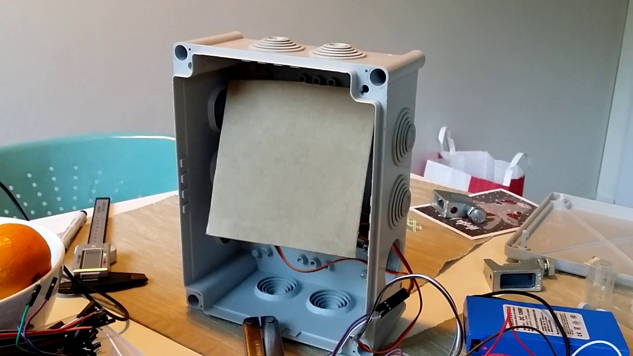

The problem was to have a weather / winter proof enclosure for the antenna and LNA, preferably with pan and tilt control to achieve maximum dB’s on these higher latitudes.

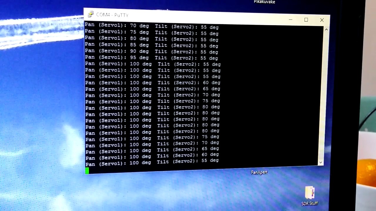

IP65 plastic box, 3D printed pan-tilt servo mount, Arduino Nano and bluetooth module to the rescue!
I’m now able to pan roughly 40 degrees left and right and about 20 degrees up, which is fine up here!
