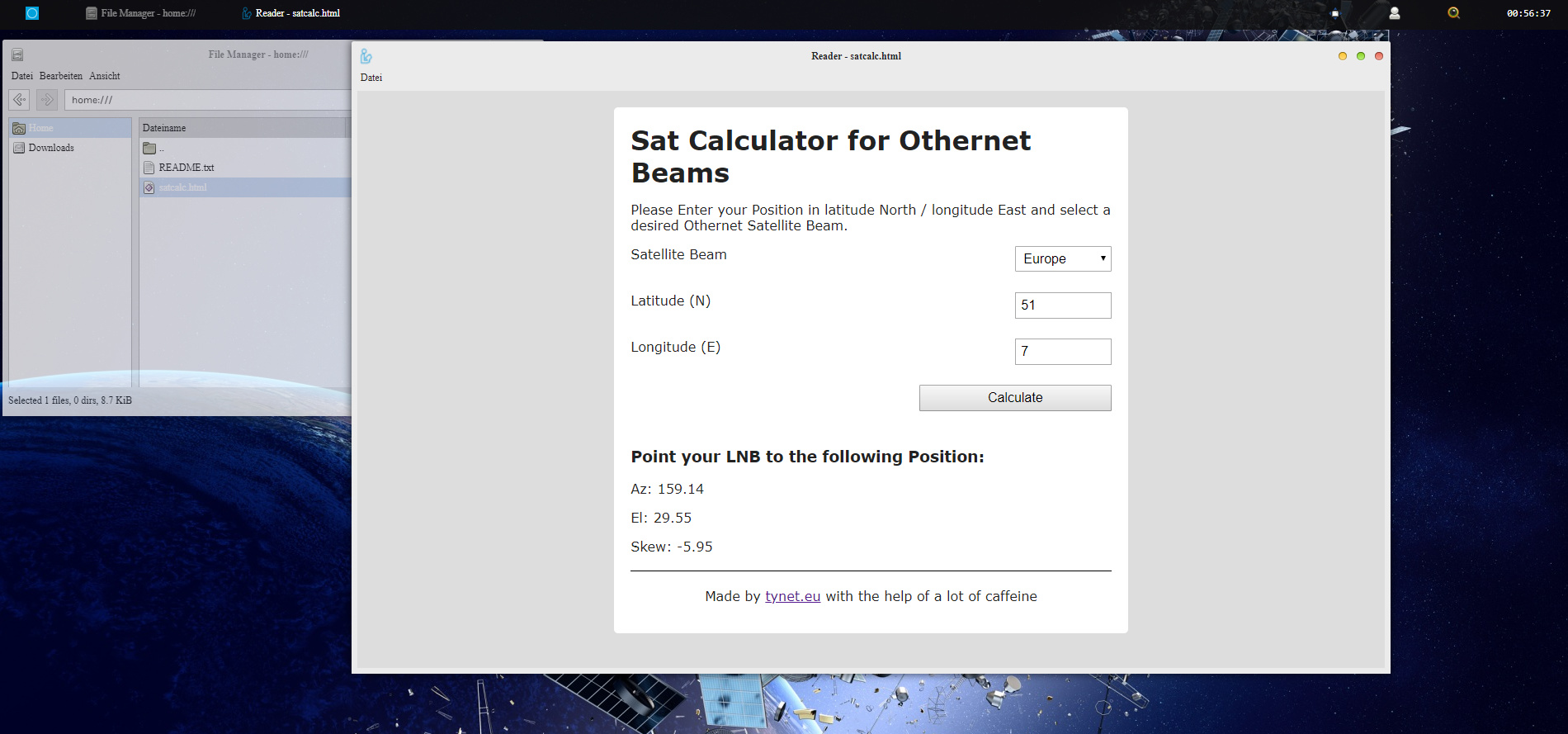

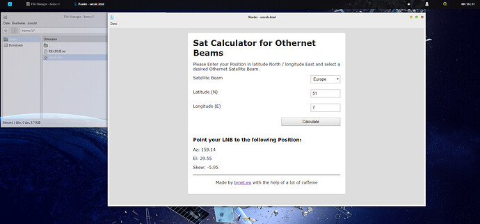

Jup, found similar things. A only js version is easy to do. I could make something nice looking if you like @Syed @kenbarbi
Currently making a little JS calc for Othernet Beams, calculation works already, now i need to make it nice looking :slight_smile:
Is this giving True or Magnetic Az? Ken
It’s True Heading for now, but magnetic is not a lot different.

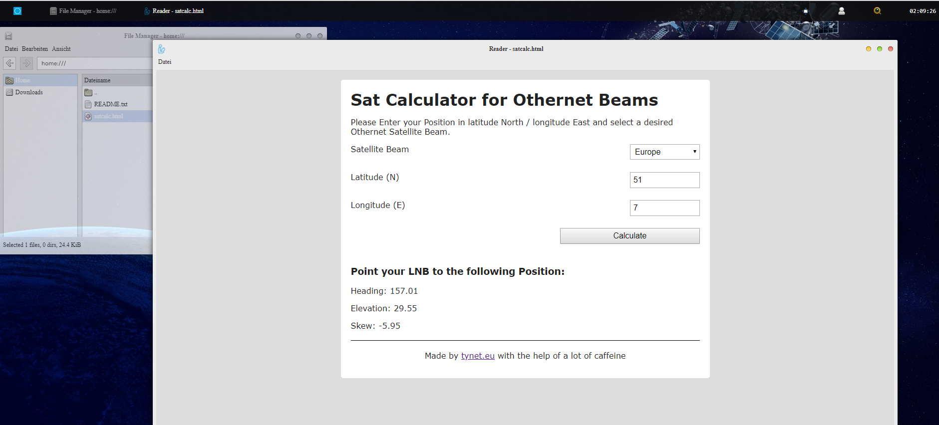

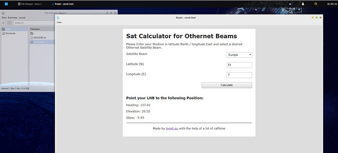

So i added Compensation for skew on Astra and made it look good. It’s a single file, so easy to send over sat link.
in the EU magnetic vs true heading is only a few degrees, i would like to add it but i currently have no easy option for that. But i’m confident that i / we will find a solution.
Ha! Got it! My script is now compensating for magnetic deviation on Earth, so it calculates the needed Magnetic Heading :sunglasses:
Cologne, Germany (Astra 3B)
New York, USA (SES-2)
@Syed @kenbarbi Any things you think would be needed?
