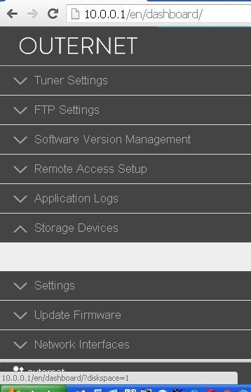

Install went fine. After using a powered hub the external hard drive (shown as device 0837) and a USB to Ethernet device showed up. However, in settings, I was unable to pop open the Storage Device folder (or any other folder other than Tuner Settings) to see the external device or look at Network Interfaces. So I don’t know the status of the hard drive, nor anything about a wired IP address assigned by my router. When I checked all my router IP addresses on another machine, the Lantern was not present.

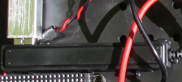

It is installed now. Before I open my Lantern box to connect my hard drive and “USB to Ethernet adapter”, I want to make sure I’m connecting them correctly. I’m plugging them both into a powered hub which I will then plug into the USB connection on the black strip next to the one the SDR uses:

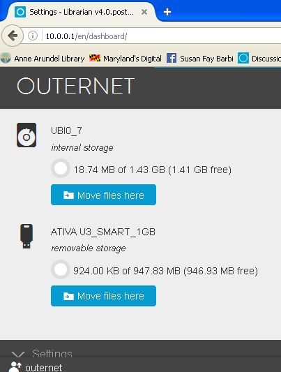

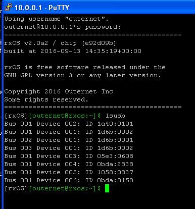

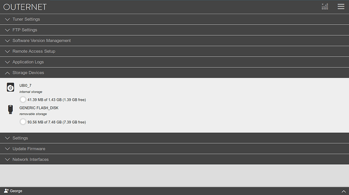

Good news regarding the HTML.GZ files - - they now open fine in the Librarian. Also a 1 GB USB stick (formatted FAT32) was recognized not only by the SSH LSUSB command, but also by the Dashboard.
My 1 TB Western Digital hard drive I used to use in the Lighthouse (formatted NTFS) was recognized by the LSUSB command, but NOT recognized in the Dashboard.

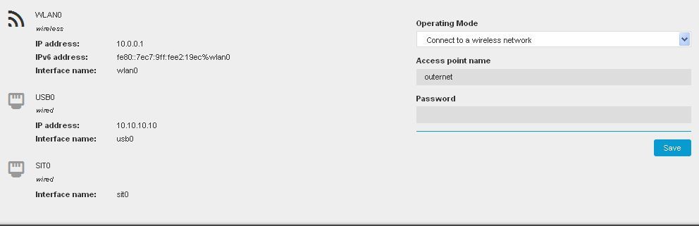

Also, my USB to Ethernet stick was recognized by LSUSB command, but did not work with my network. I also saw some very strange settings on the HotSpot / wireless panel on the left. Even though I was connected to the Outernet Hot Spot, I couldn’t force the Lantern to connect to one of my WiFis :

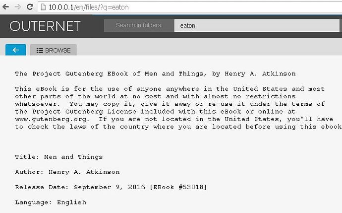

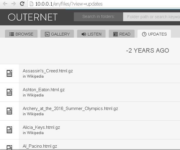

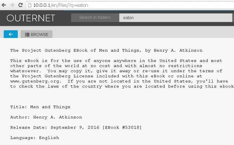

I’m still seeing all the Updates listed as 2 Years Ago in stead of when they downloaded, and searching any term keeps going back to the same Project Guttenberg file as before. Ken

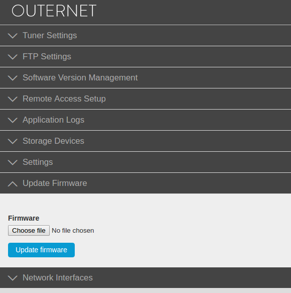

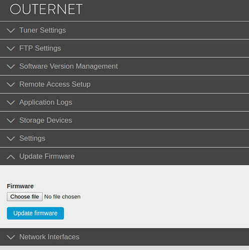

@Seasalt@Abhishek I think you are trying to update through the UI, but using the USB as the source of the file. That won’t work. If you’d like to update over USB, then just stick it in the CHIP while it is on. When one of the lights goes out, remove the flash drive. The easier way to update is via the UI, which takes place over wifi. You’ll need to have the .pkg on your client device and then upload through the wifi.

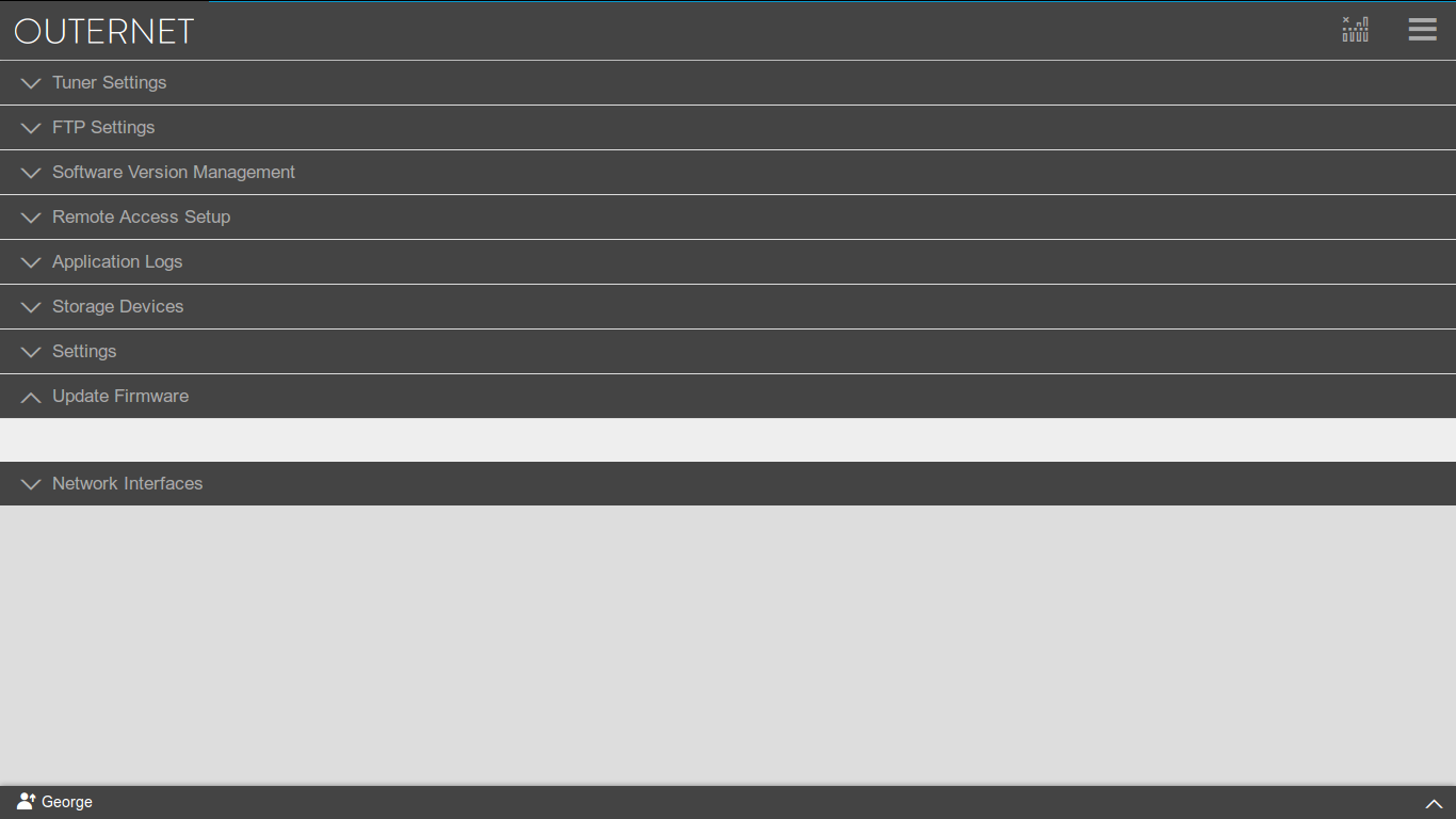

Option 1 may have inadvertently happened. Is there a way to check what version of software I now have?

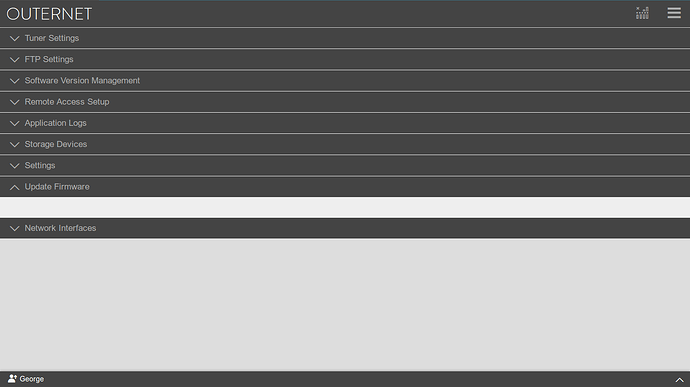

Option 2 where I look for the file is definitely not working as when I go looking for a update file in Library that part of the screen is blank.
