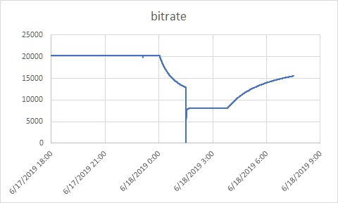

Noticed this morning that the bandwidth of the Othernet service dropped to roughly 10000bps, and the signal is not a steady stream anymore. Is this normal? (I’ve been away from the project for a while, it was working/looking normal last night)
Edit: about 15 minutes later, the signal returned to normal. It seems it just didn’t have any files to send at the time, thus the low bitrate (audio only) and thus the pulses. The bitrate is slowly creeping back up, but I believe this is an average over x time, so it will take a while to get back to 20000.

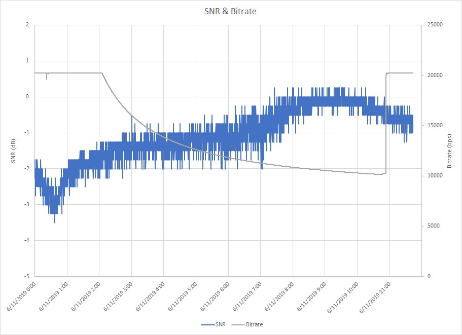

Interesting. Here is what I saw in central VA. SNR seemed to stay good for me, but bitrate fell off.
The bitrate is currently dropping, and no files coming. fwiw
Around 5:30am Eastern time, the signal jumped back to normal 20000 bitrate bps

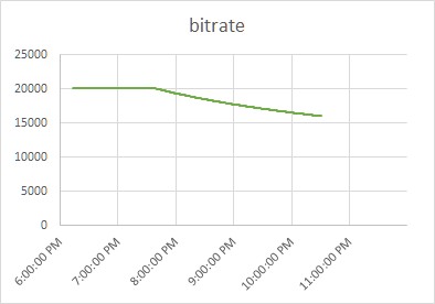

It is 06/17/2019, 10:00 PM in Salt Lake City, UT.
I am experiencing this phenomenon of half bandwidth at this moment.
