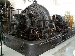

On 4 July, the World Heritage Grimeton Radio Station in Southern Sweden will broadcast its annual Alexanderson Day message to the World. The station, SAQ, transmitts at 17.2 kHz CW (yes kHz) from its 1928 Alexanderson Alternator.

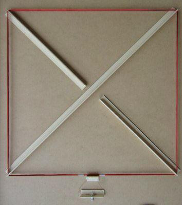

I have an up converter board kit on order. I may need an amplifier first like you show. Check this out. A wire spreader for a loop.

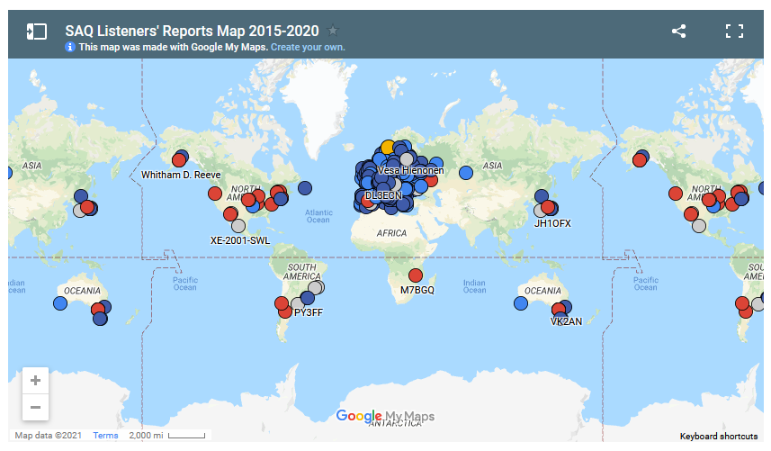

They show reception reports on their site at Föreningen Alexander – Grimeton Veteranradios Vänner as in this screen print. Ken
