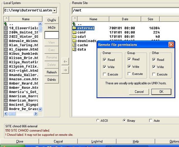

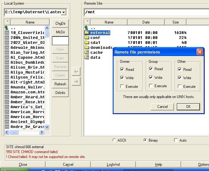

It appears to be a permissions issue as writing to the CHIPs external storage is not allowd, but I can’t change the external directory’s permissions with CHMOD to allow writing back to the external storage:
Any thoughts on this anybody? Ken

The filesystem for external storage is mounted read-only to minimize the chances of file system corruption. So yes, uploading to external via ftp will not work.

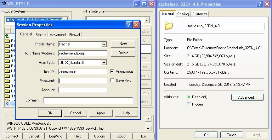

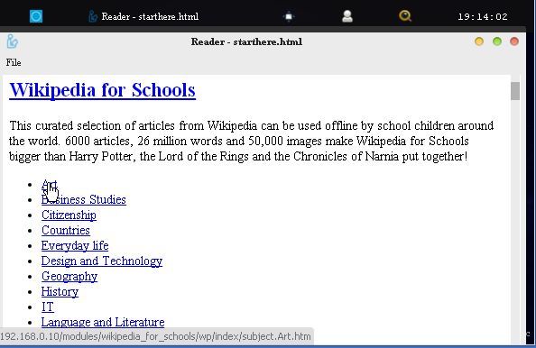

My problem so far has been the Skylark Reader’s ability to drill down into the Rachel navigation architecture. I keep getting kicked into the wrong http address within the Rachel Modules shown at the bottom of the picture, and they don’t go to the correct files. 192.168.0.10 is my Lantern’s local address on my LAN.

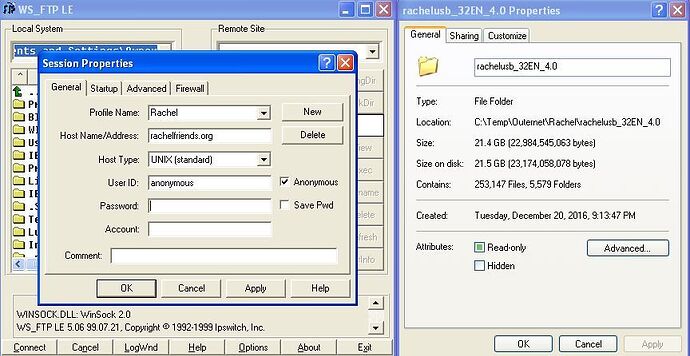

I’m going to load the latest version (rachelusb_32EN_4.0) of Rachel’s USB stick version on an NTFS formatted 64 GB Stick and try again. This way all of us who want to try this will be starting from the same set point.

My 32 GB Flash Drive files are visible in SKylark 4.4, but when I run the Rachel starthere.html file, and try to go to Rachel subdirectories, I can’t.

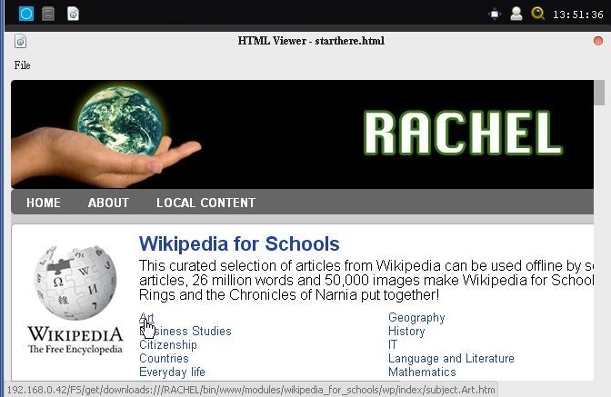

When I try to drill down to Art, the CHIP directs me to 192.168.0.10/modules/wikipedia_for_schools/wp/index/subject.Art.htm which can’t be found. The 192.168.0.10 is my CHIP’s router address on my lan. Additionally, with Skylark 4.4, I don’t popup the framed Rachel page as I do below with 4.2.
I re flashed a second CHIP to Skylark Version 4.2, and tried the same thing and was successful.
Drilling down in Art sends me to:
192.168.0.42/FS/get/downloads://RACHEL/bin/www/modules/wikipedia_for_schools/wp/index/subject.Art.htm which can be found. Again the 192.168.0.42 is the network address for my Skylark 4.2 system. (I have 2 CHIPs running simultaneously each flashed with a different version of Skylark)

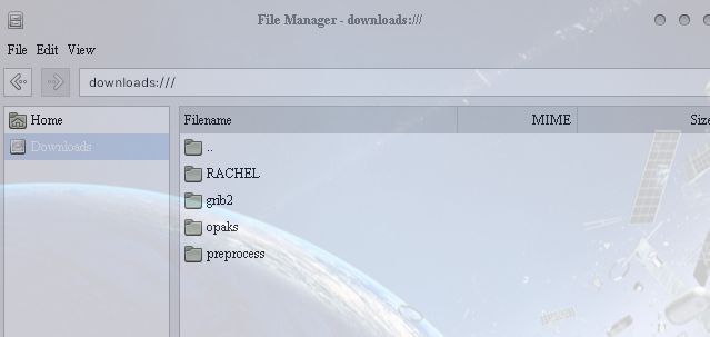

Another thing I found is in Skylark 4.4, the external drive (my Flash drive with Rachel on it) stands alone at an equal level with the CHIP’s Download directory. In Skylark 4.2, the contents of the same external drive appear (or maybe are mirrored) within the CHIP’s internal Download directory
