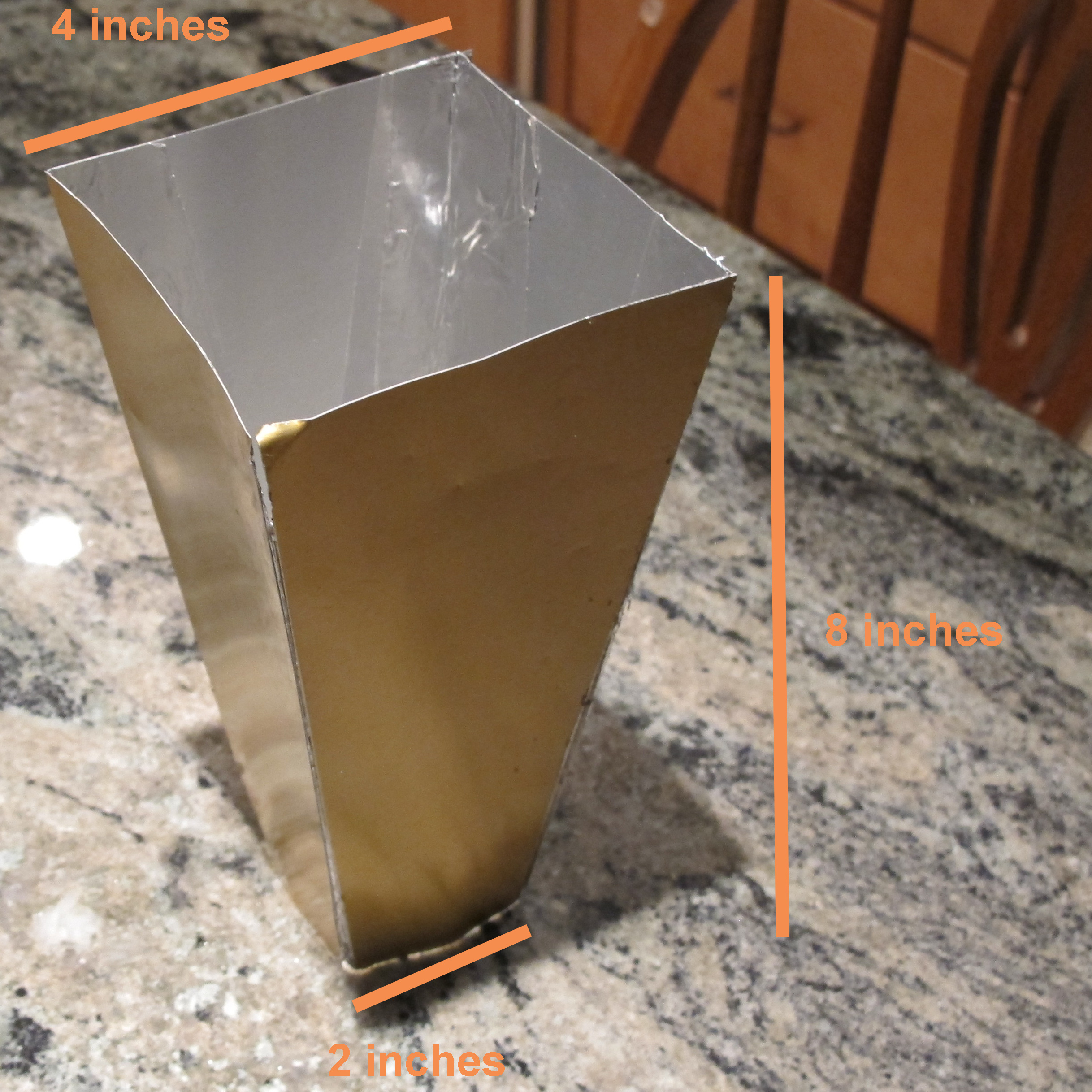

Could you share drawings and more detailed pictures of the DIY wave guide?
Nice work, Ken!
DIY Wave Guide
Made out of aluminum flashing from Home Depot or Lowes. I taped the 4 trapizoid sides together with duct tape.
Several folks made it out of garden chicken wire which is more wind proof.
How did you come up with those dimensions?
I took the martini shaker dimentions which I first tried and cut trapizoid paterns so I could piece it together in a foldable format for transport. I also looked at wave guide dimentions for 18 GHz sytems using wave guides which agreed with those dimensions and used them.
Not very scientific - - besides, I don’t drink martinis - - just wine :rofl:
Anyway, seriously, the specs of the martini shaker (2x4x8 inches) work well as Konrad’s antenna does and other’s are finding - -

@kenbarbi Your 4.5 dB improvement with the wave guide is much better than @Konrad_Roeder’s martini shaker. If you unmount the waveguide while connected to the LNB, how difficult is it to eyeball point?

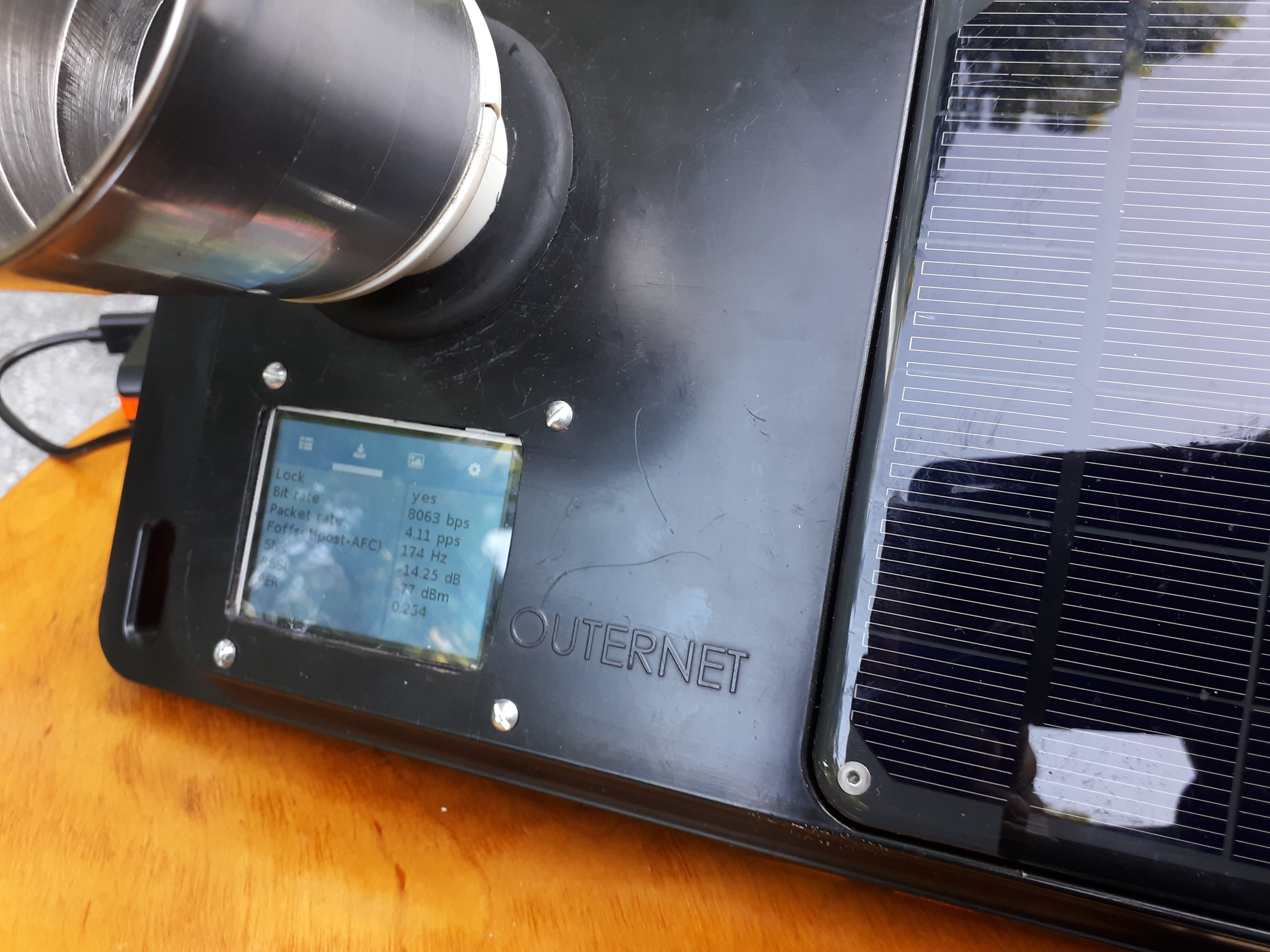

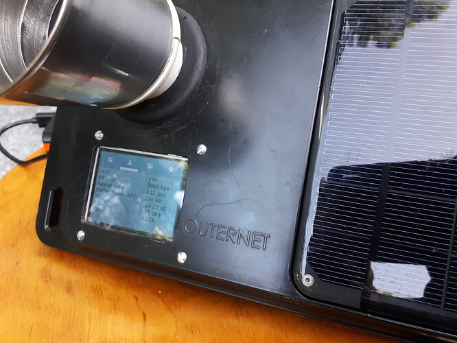

Knowing the general magnetic direction and elevation angle makes it easy to point by just looking for a spike in SNR from a -17 dB to a higher value around -14 dB. When I pass that point, I slow down my movement of the LNB to get a peak reading.
The one issue I have is that I mounted the touch screen on the front side of my portable terminal right under the LNB. Bad move, because to read the screen in sun light requires you to be head on to the screen which blocks the LNB with your head. Otherwise the glare prevents you from reading the SNRs.
(By the way in this picture I haven’t optimized pointing - - my elevation is too low and I am standing in front of the LNB to take the picture)

Ken did you have to add a ribbon cable to the display?
