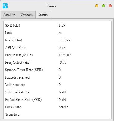

The 50 ohm load gives steady signal levels as shown here:
I guess the problem could be in my active antenna. I have another one on order, so when it comes, I’ll swap it out. For now, I will press on with what I have. I’m getting files fine, it’s just the indeterminacy of my SNR and Rssi values. Ken

Ahhh-ha. We “doubled” My response was before hearing the result of the 50 Ohm load test.
RSSI -132.88 confirms that you blocked signals coming in.
SNR of 1.69 … noise.

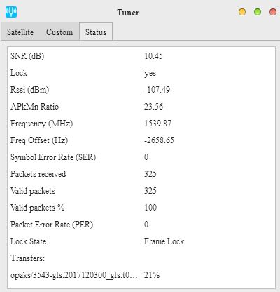

Here’s the one thing we didn’t think to do, Konrad. Cycle the DC back to the Hotspot mode, then check the tuner; and cycle the DC back to the WiFi mode.
That done - - the intermittent problem disappeared.
Rock solid performance now. The DC somehow must have had a network connection problem before is the best answer I can come up with. I guess this is another tool to put in our arsenal to help others experiencing similar problems. ![]()
