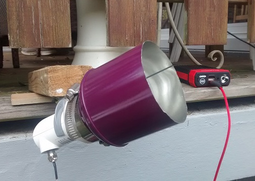

I will try to make a small horn with wire mesh.
Not too much experience with the microwave horns. Is it necessary for the metal body of the horn to be in contact with the ground of the plug f ?
Thank you
Ideally, the material should have holes than are less than 1/10 of the wavelength. In this case, less than 2.5mm.
ok thank Syed , I’ll try to find that
On a calm day aluminum foil seems like not a bad choice for an experimental horn that might last a few minutes.
Aluminum foil can work, also foil tape like is used for heating and cooling ducts has met with some success. Some have used soft drink cups covered with aluminum foil duct tape successfully, also.
@Butternut, to answer your question, no, it is not necessary to contact the “grounded” area of the LNB or coaxial cable (f connector) with your horn.
