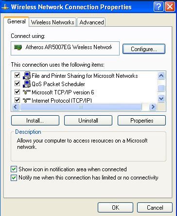

In Windoze.
left click on the wifi Icon on the taskbar, near the clock
Right click on Outernet and select âstatusâ
then from there click on âpropertiesâ
in the properties you should see something like " internet protocol V4 (TCP/IPv4)
Click on it ( be careful NOT to âuncheckâ the box!) and then click on âpropertiesâ
then click on "use the following IP address"
Then follow the rest of the instructions

The only issue here is you canât follow the above steps on a Windows XP machine. I had to use a Windows 10 machine to do it. My XP doesnât give me the required option for "internet protocol V4 (TCP/IPv4) - -
I see - - so I just have to assign an IP address and gateway in the normal TC/IP setup on my old XP machine, and then Iâll be OK. Iâll try that later just to make sure.
