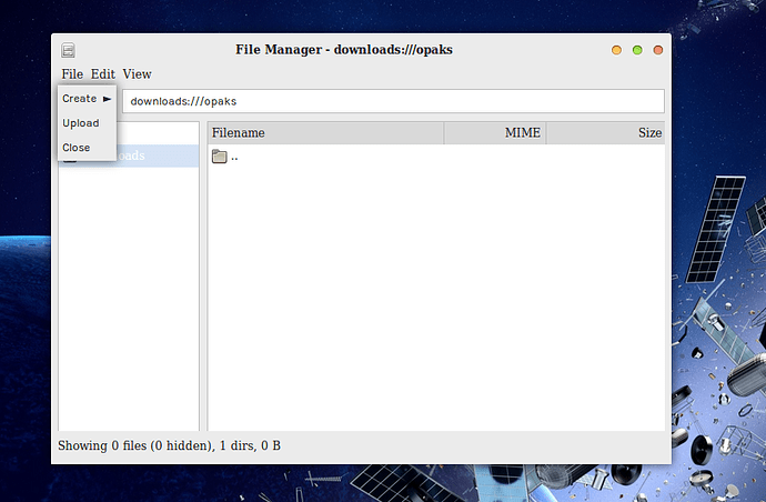

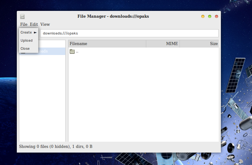

I have placed the opak here:
https://archive.outernet.is/images/Skylark/skylark-chip-.1701041326.to.1702021712.psop.tbz2
It’d be a great help if all of you could download this file (do not extract it), and then in Skylark file manager, open “opaks” folder and then select “upload” from file menu. Then select this file, upload.
Once the upload completes, if you now hit “refresh” from the “View” and confirm that the file vanished.
Then hopefully its the regular ota process - about 7 minutes worth of wait and then a (automatic) reboot.
Downloaded it and went to opaks, but mine is full of Zero Byte files … oops!
How can I get ride of them?
Anyway the update file DID disappear! :slight_smile:

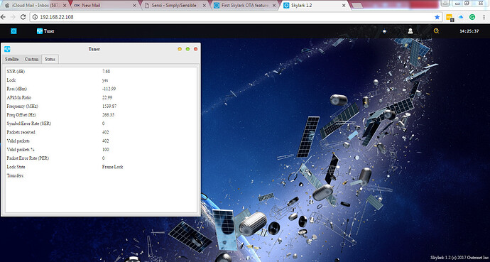

I received the update, no problems. The system rebooted, but didn’t come back to the WiFi network it was assigned. OUTERNET SSID popped back up, so I had to reconnect to that. It did not distribute DHCP, but was able to get to 10.0.0.1 after manually setting an IP on my WiFi card. The settings showed that it should be connecting to a WiFi network, not operate as a HOTSPOT. It even had my network name in there with the password. I hit apply and reboot and we’re back in business. Spot beaming, at least here in Midland, Michigan, appears not to have been a problem, though not completely unattended in this case.
:satellite:
don’t bother about cleaning up the pending files in opaks. The update, if it works, will clean it up.
so you are seeing the new 1.2 version???
Yes, sir!
ok. Thats an excellent data point. Thank you!
So, wifi settings got messed up. But other than that the OTA did work, though it doesn’t look like it worked for everyone.
A job well done, sir! Pretty darn cool when you think about what you did! If I can be of any further assistance, please let me know.

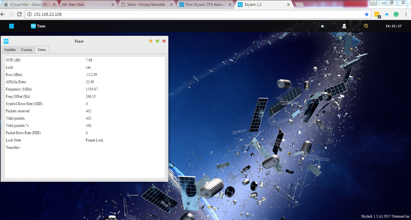

Both my terminals received the OTA update as I watched the Tuners, but I missed the reboot. Now both systems only respond with an Outernet HotSpot, and the Hotspot does not assign an IP address. There is no way into the CHIP - - I’ve tried at least 10 times on each machine.
As an aside, neither CHIP is powering the LNA. Ken

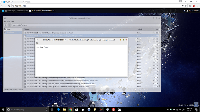

I guess I could have phrased that better. What I am talking about is news headlines that are questions with a “?” in them. I have some screenshots.
It seems to be only files with a “?” in the name. Filezilla does work, however I cant use it to automatically download the files. After I get these files onto my computer I am able to view them just fine.
How do I do this step? Seems simple enough, but I have never done it before. Thanks for your help, Ken
