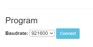

- Click CONNECT

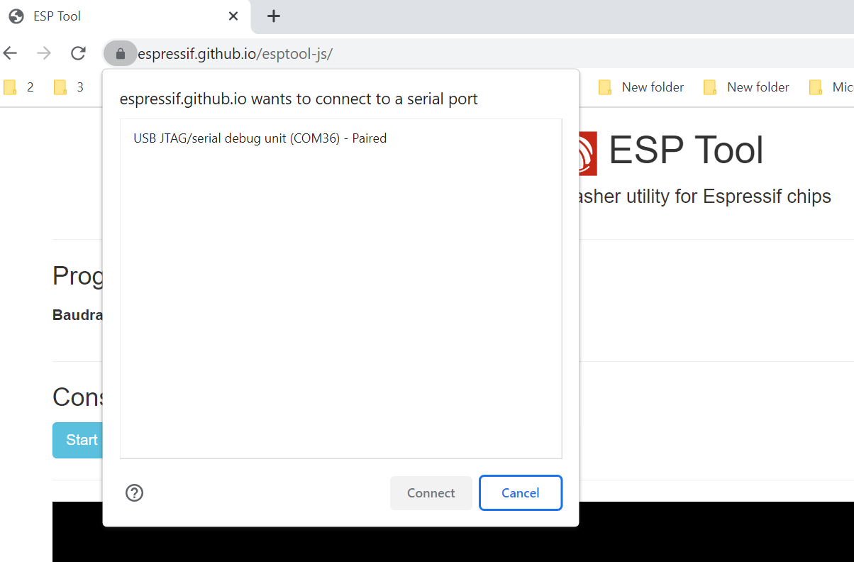

- Click the device in the dialog-box.

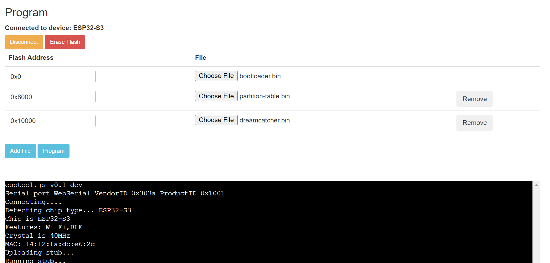

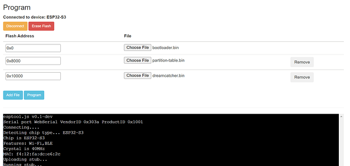

- Click ADD FILE twice so a total of three lines appear.
- Change the FLASH ADDRESS values to what appears below.
- Click CHOOSE FILE and add the appropriate .bin, as shown above.

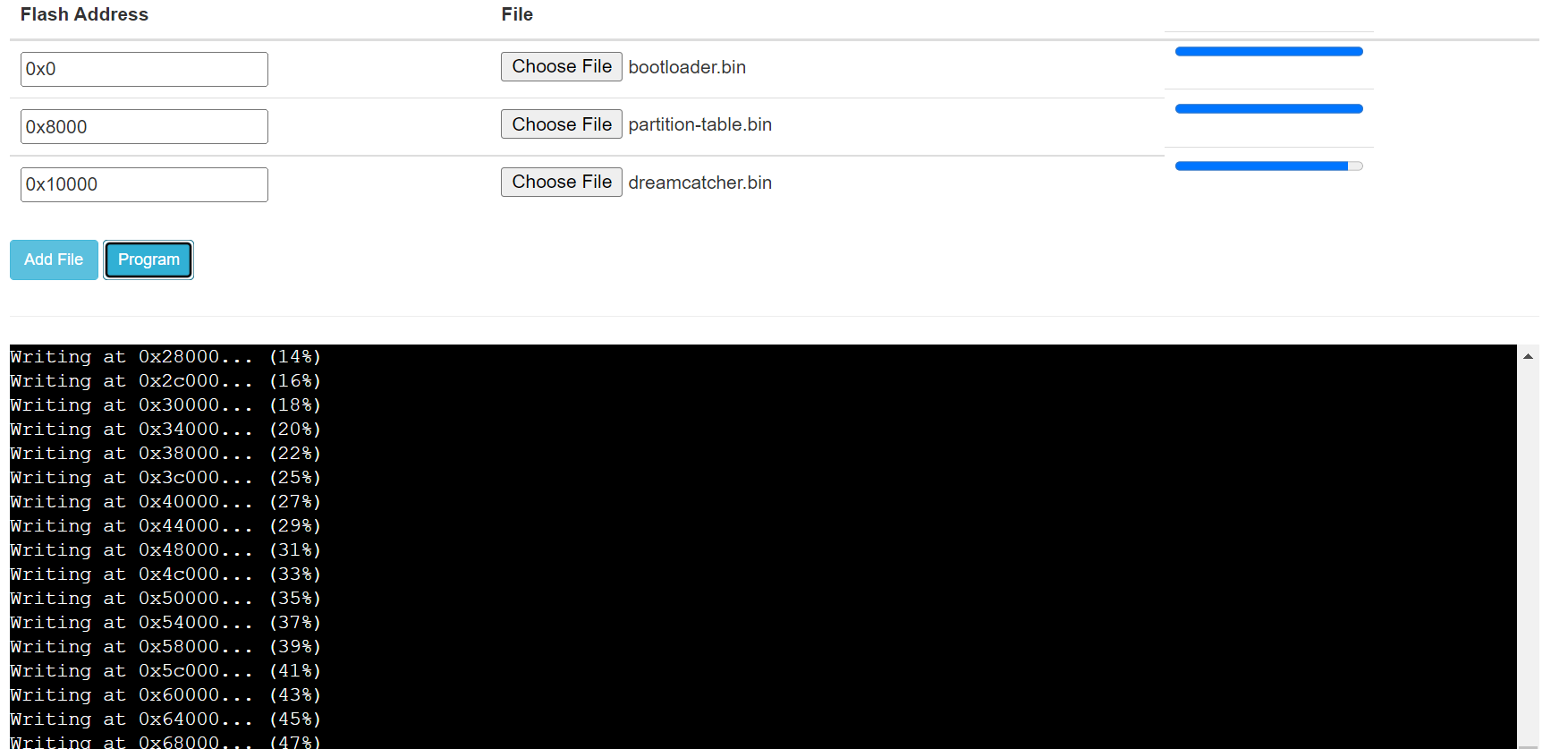

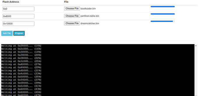

- Click PROGRAM
- When you see “Leaving…” at the bottom of the terminal, remove the USB cable and connect the Dreamcatcher to the LNB. Next supply power over USB.
