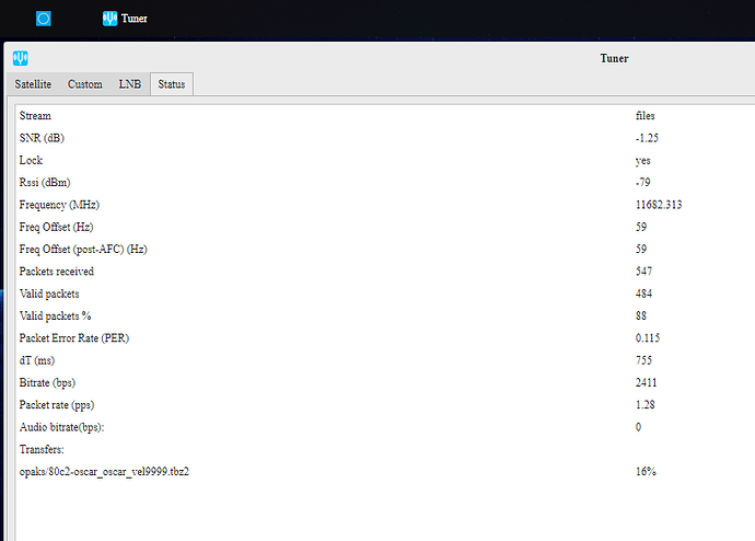

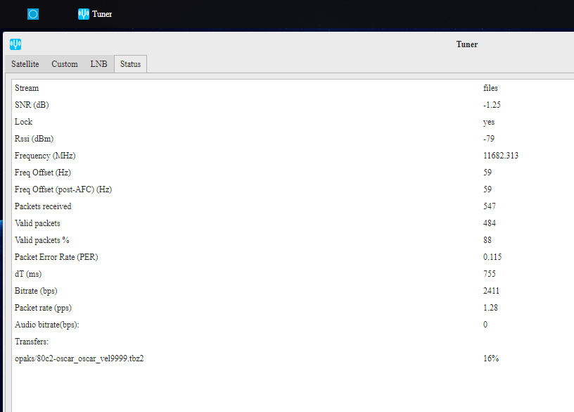

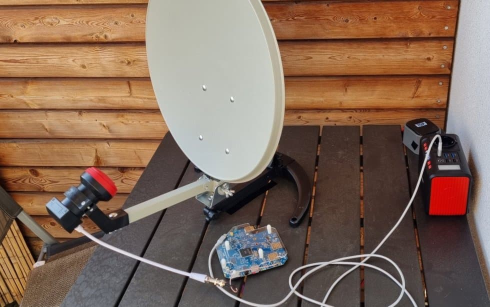

It’s a makeshift setup. The cable is the one from my measuring setup with 2 fast coupling f extenders. So there is much more HF friction than with one decent cable and 2 screw on connectors.
Quick and dirty adjustment with satellite antenna…
what Dish Size is that? I tested with a 60cm Dish and i got +7 SNR :slight_smile:
35cm

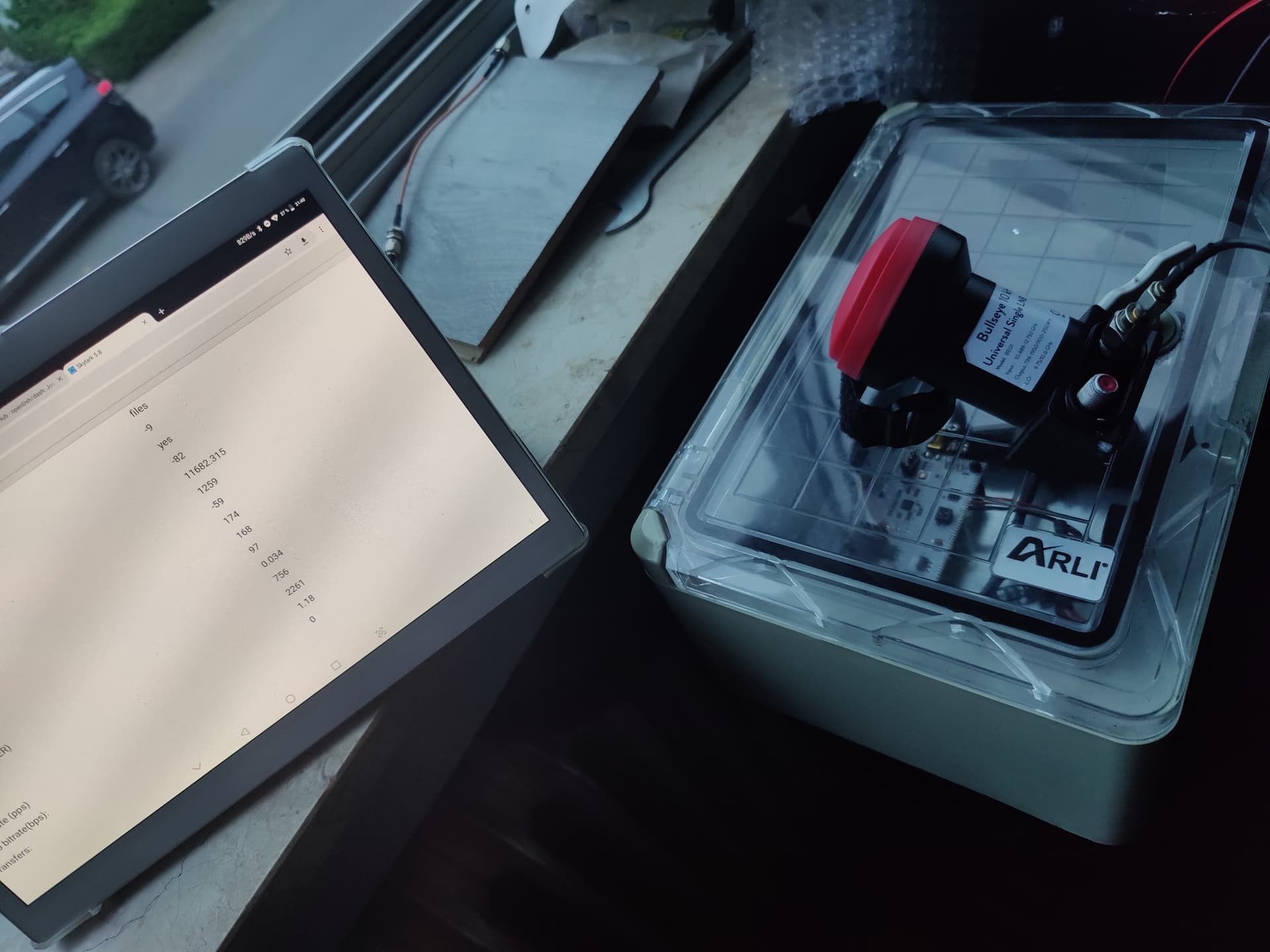

Quick test of my DC 3.05 and Bullseye LNB Setup before i pack it into my bag for my visit to portugal.
Just put the LNB inside on a box and let it view trough my open window, got a good signal (-9db snr) without any fine adjustment.
I will test during the next week from Portugal and test how the reception is down there.

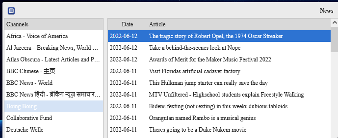

Just got 2 new article for 12 June here in US on SES-2 Ken
