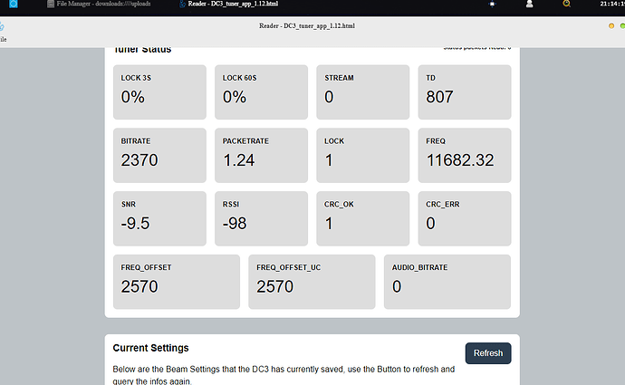

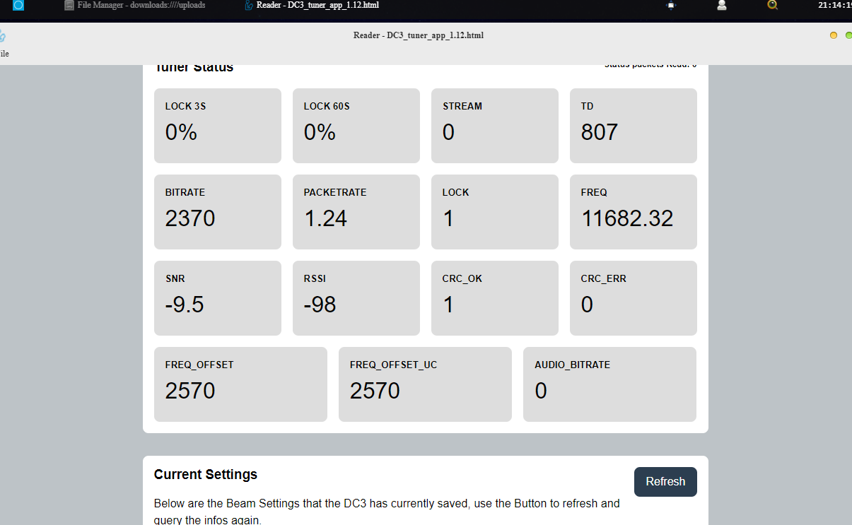

I’m in Geneva, Switzerland, i did receive the signal before when it was on Astra 3B.
I have the LNB that came with DreamCatcher 3.05 (dual lo), no cone. I also have a Bullseye LNB that i can test with. I didn’t need a cone before, but i will add a pringles can (i printed the tysonpower mount on thingiverse including the pringles mount)
Edit: I got a (weak) signal, after adding a cone and using the tuning app

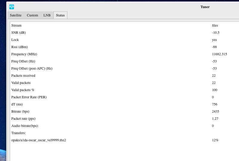

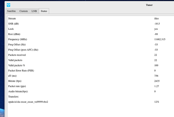

Without any finetuning of the LNBs postition i now got a lock on Astra 3B, LNB only without a cone near Cologne, Germany. Freq is now within spec at 11.682315 Ghz
If anyone can receive the Signale, please report if there are any Frequency Offsets.
I’ll repoint my minidish tomorrow and will make a parallel test with bare LNB
thats very low signal power for a dish, are you sure that you are pointing right?
I still got a stable -10 to -11 SNR with -88 snr from a bare LNB
