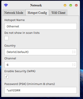

@kenbarbi I propose that the user documentation be supplemented as follows: In the network app, activate the option “Enable Security (WPA)” under “Hotspot Config” and assign a secure password.
It would be better to force these settings.

However, the documentation should recommend the use of a password. It would be advantageous to force this by default. Currently, neither encryption nor a password is set for Wifi by default.
Good point, Robert. Most of us have not worried about this issue. But if it is a problem to anyone - - yes Skylark has the solution. While you can change the Othernet admin password (as I have mentioned in the User’s Guide), no one yet has looked at the Othernet HotSpot password, nor have I mentioned it.
Yes, Skylark has a way to fix that very simply. Simply add the WiFi Hotspot password, and use it to get into the Dreamcatcher when you are using the Othernet Hotspot. I’ll add that to the User’s Guides. Thanks, Ken
