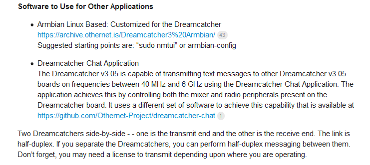

The Github repo is incorrect. It should point to the following.
That repo has the latest version of the chat application, including the GUI. It also includes better, simpler instructions on getting everything up and running.
Yes, that’s correct.

The bug in the chat app should be fixed. Just run the installer again:
wget -qO- https://raw.githubusercontent.com/Othernet-Project/dreamcatcher-chat/master/install.sh | sudo bash
Garbled text should no longer crash the server. Instead, you should see a message in the GUI saying that garbled text was received.

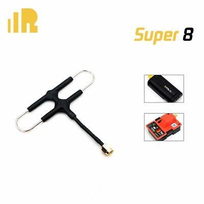

My projects always seem to requires several trips the hardware store … I got the FrSky Super 8 antennas, but they (of course) had an un-expected reverse polarity sma male on it’s coax. So to make it all work… I have now made a second ordered for adapters…
Your lucky your connectors are not reverse threaded. I ran into this problem on a VHF antenna that used reverse thread N type and TNC type connectors. Try to find adapters for those
Software Link on chat page goes to shopify page rather than archive.
Which link and page are you referring to?
