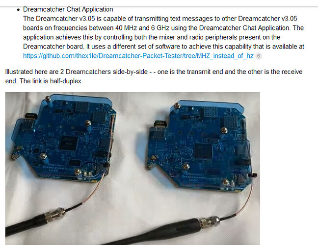

Thatâs what meant. I could be wrong, but a year back I thought a picture showed 2 boards at each location, maybe for full duplex? Probably not.
I donât think we ever posted anything about a full duplex concept. What we have in Dreamcatcher chat is half duplex.

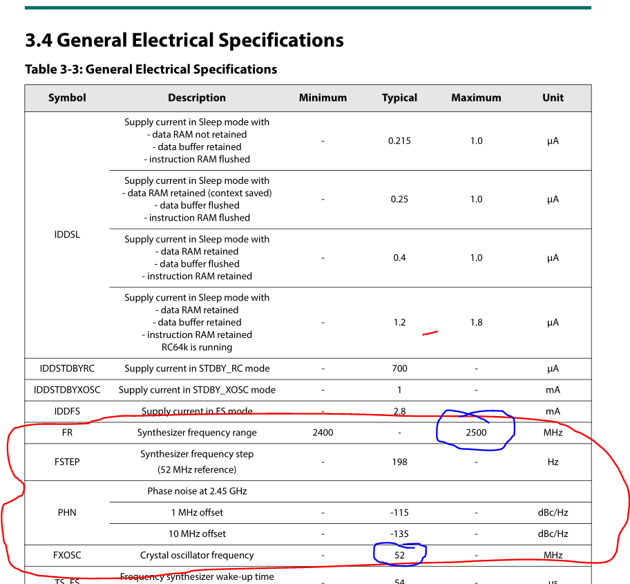

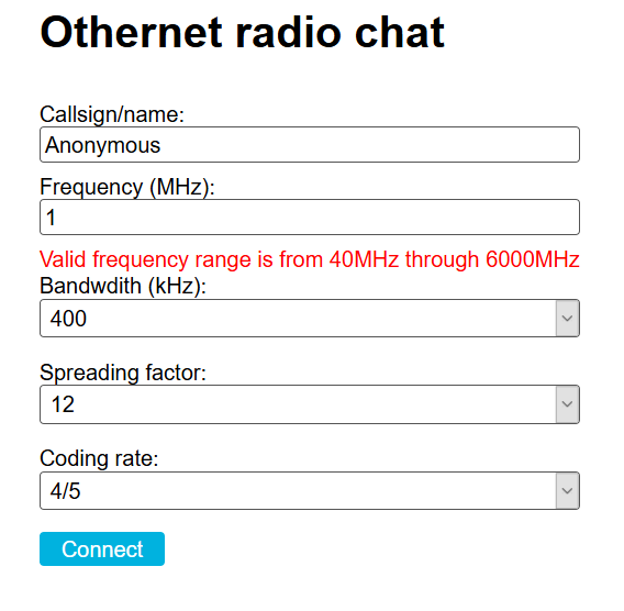

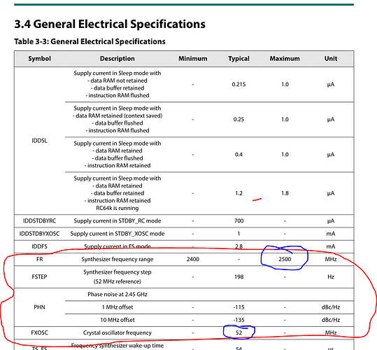

One more potential change to the chat setup page. I donât think the allowed freq are correct in the lookup table. I think the maximum is around 2500MHz but I canât confirm this in the datasheets. minimum may be the 52MHz based on the internal crystal.

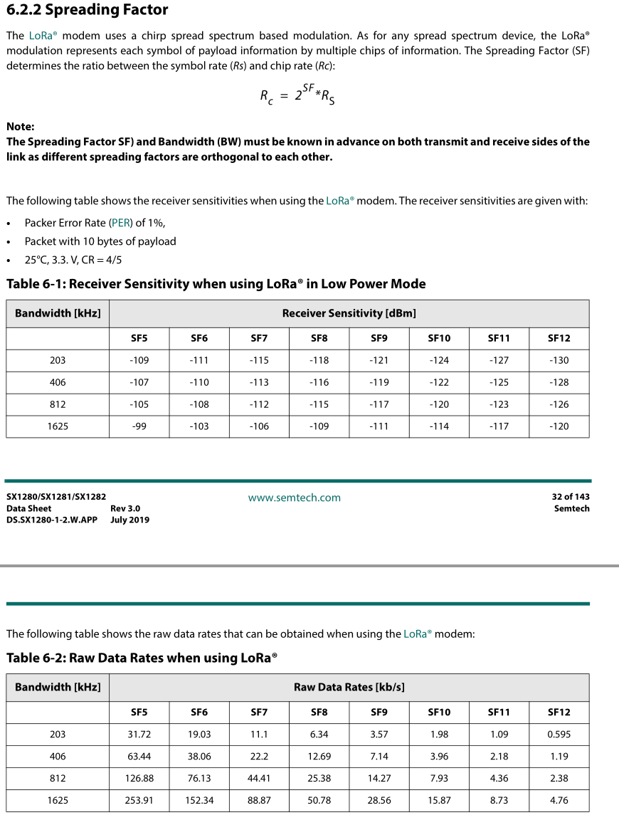

Users might also want to know what is affected by the the bandwidth, SF, and coding rates
There is a mixer and synthesizer in front of the SX1281, which expands the frequency range to 85 - 6000 MHz. Basically, we have a moRFeus integrated into the Dreamcatcher.

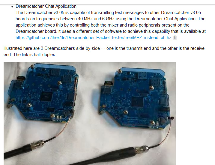

I probably saw 2 DCâs set up at one location as a test of Chat. One transmitting and the other receiving.
Yes you did - - I played the video and thatâs what they were demonstrating. I copied the picture of the 2 Dreamcatchers when I illustrated the Chat App in the Wiki. I need to clarify that. Ken
By half-duplex do you mean one is a send end and the other is a receive end? Or do the DCs switch back and forth from send to receive to achieve half-duplex operation? Not clear as I never ran it. Ken
They switch back and forth. Every Dreamcatcher can transmit and receive, but canât transmit and receive at the same time.
Good - - they are truly half-duplex devices as we all know them. Ken
Now I remember! Could you briefly repeat how Chat would be used here on the Othernet? Or is the info on a Wiki and Iâll just read it.

I forgot to mention that Jim found this Chat App video a couple of weeks ago - - What can you do with two Othernet Dreamcatcher Boards? - YouTube Ken
@kenbarbi Unless the user is a licensed amateur radio operator, they really should not be using the Dreamcatcher Chat over the air. Itâs really meant to as an experimental, educational application.
That video is old. I donât believe there is anything that shows the most recent version of the chat application. Itâs far easier to startup and use.
Good point - - otherwise is my explanation in the Wiki OK? Ken
