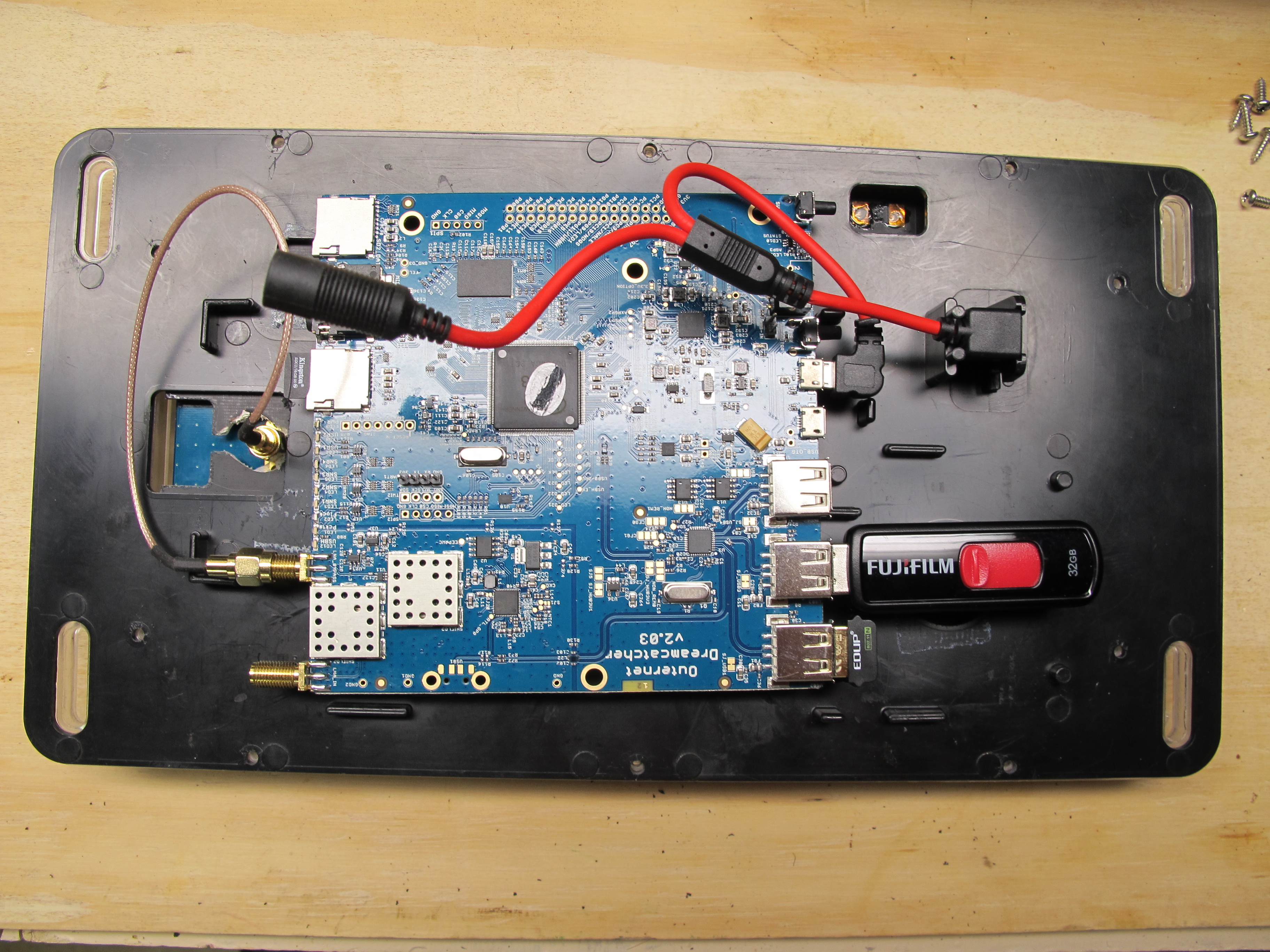

Syed has indicated he is working on some new ideas on containers to hold the Dreamcatcher Skylark system. Well, since I travel allot with Outernet in my “go bag”, I wanted a compact way to hold everything. The Simplest solution pictured below uses the old Alpha Lantern case
The only thing I haven’t done yet is gain access to the power off button. I can shutdown from PuTTY with SUDO POWEROFF - - or pull the power plug (which I don’t like doing).
I miss the internal LiPo battery the Lantern (CHIP/LNA/SDR/Patch) had which gave me portability. So I am powering my device with a 6,000 mAh Solar/external USB power device.
When I travel away from an ac outlet, I strap Solar package to the back of the Dreamcatcher case. When fully charged (trickle charge from ac keeps unit fully powered), I have several hours of portable usage. Ken

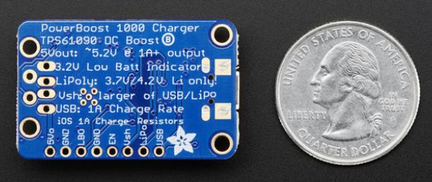

On the other hand, I just ordered an Adafruit PowerBoost 1000 Charger - Rechargeable 5V Lipo USB Boost @ 1A - 1000C from PowerBoost 1000 Charger - Rechargeable 5V Lipo USB Boost @ 1A [1000C] : ID 2465 : Adafruit Industries, Unique & fun DIY electronics and kits. Small as it is, it will supply 1 amp dc at 5 v, and uses a LiPo battery (so I can use my Alpha Lantern’s Boston Power Swing 5300 pack).
The device appears to function in a similar way that the CHIP did recharging its LiPo. It is sold as an uninterruptable power source (UPS) for computer projects like the Raspberry Pi.

According to Adafruit’s specs, it does not run a device from the battery, but keeps the battery charged for when it is needed to power your device when the USB source drys up. It sounds like the way the CHIP did its LiPo battery charging.

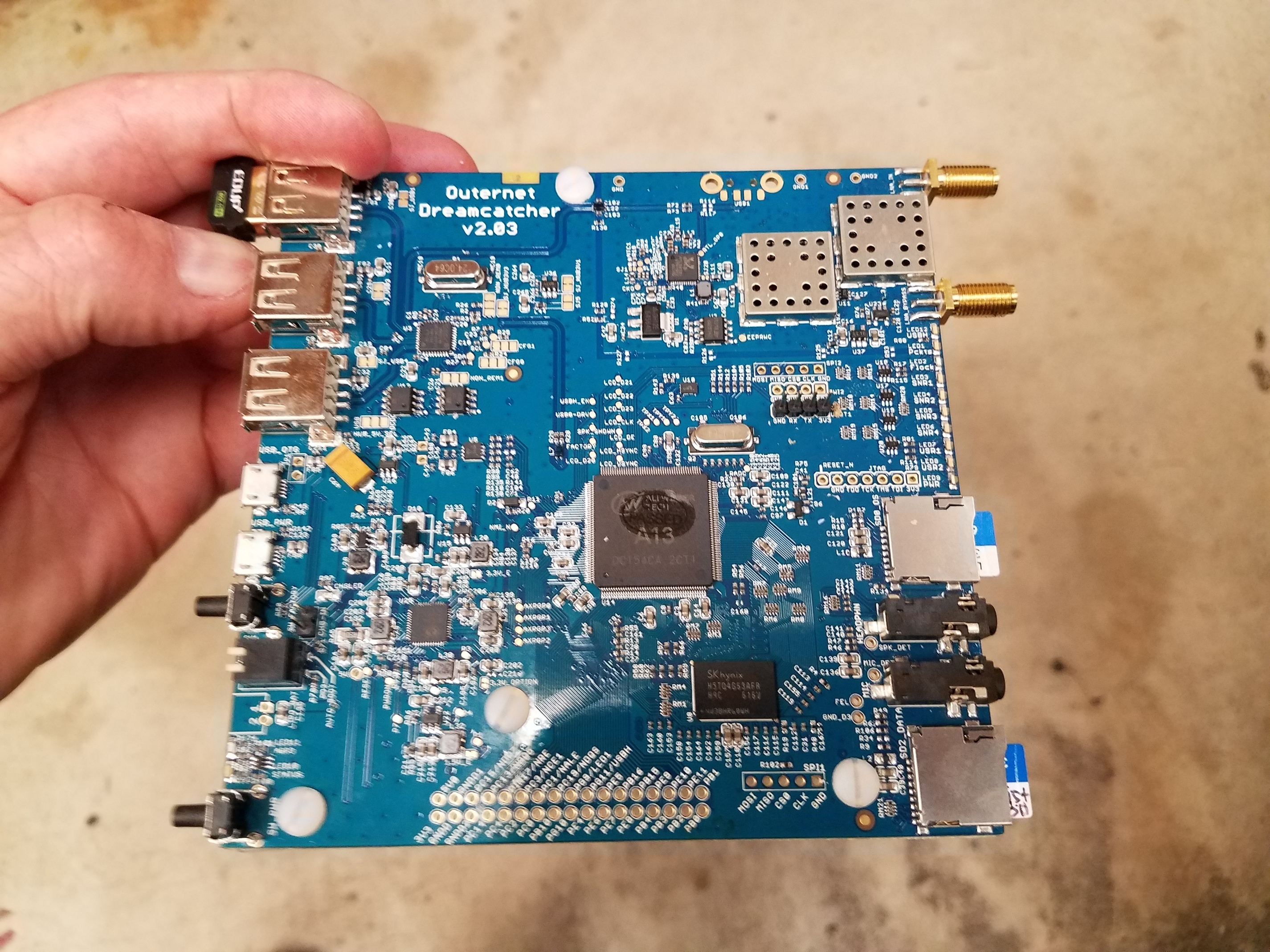

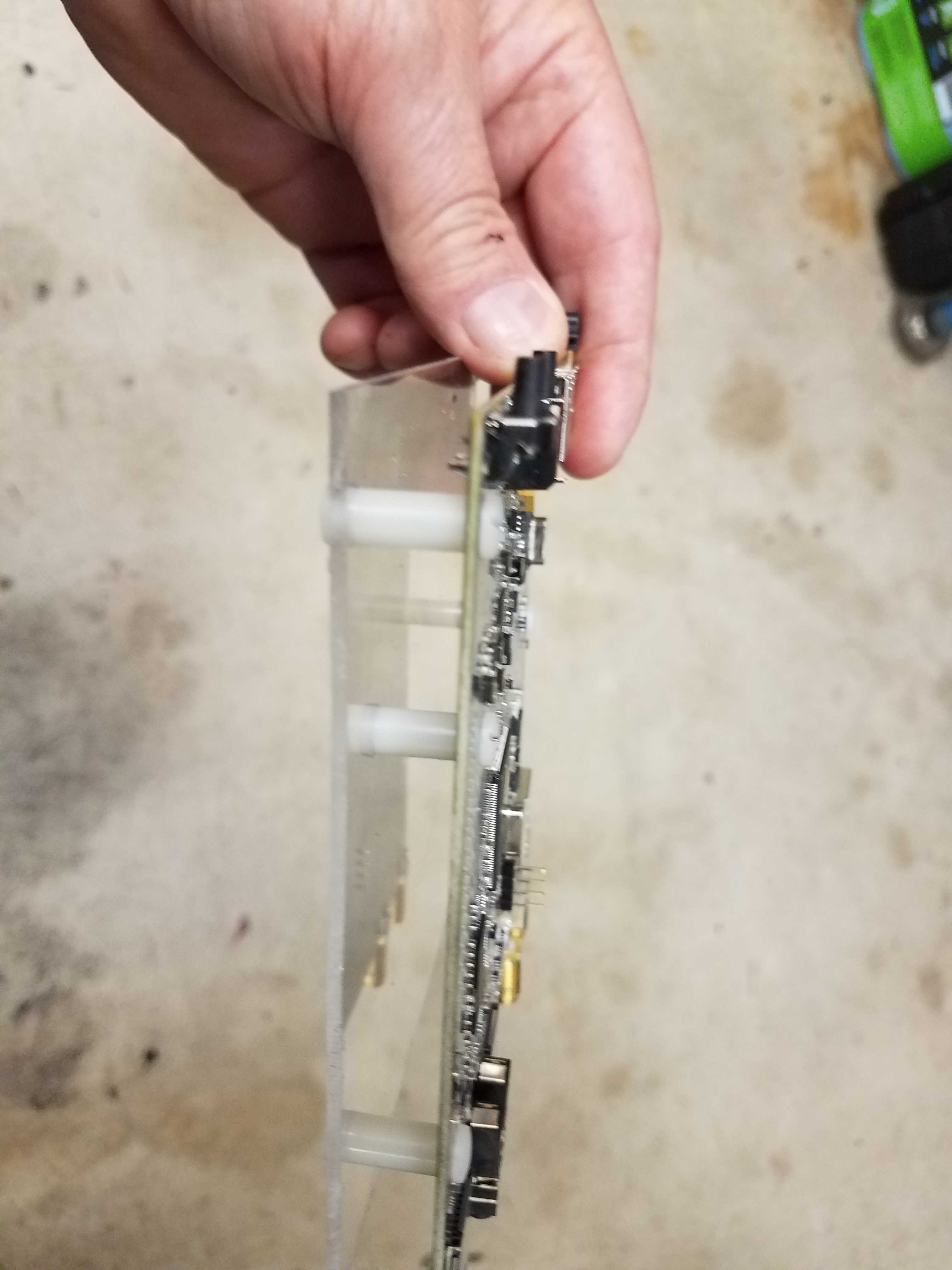

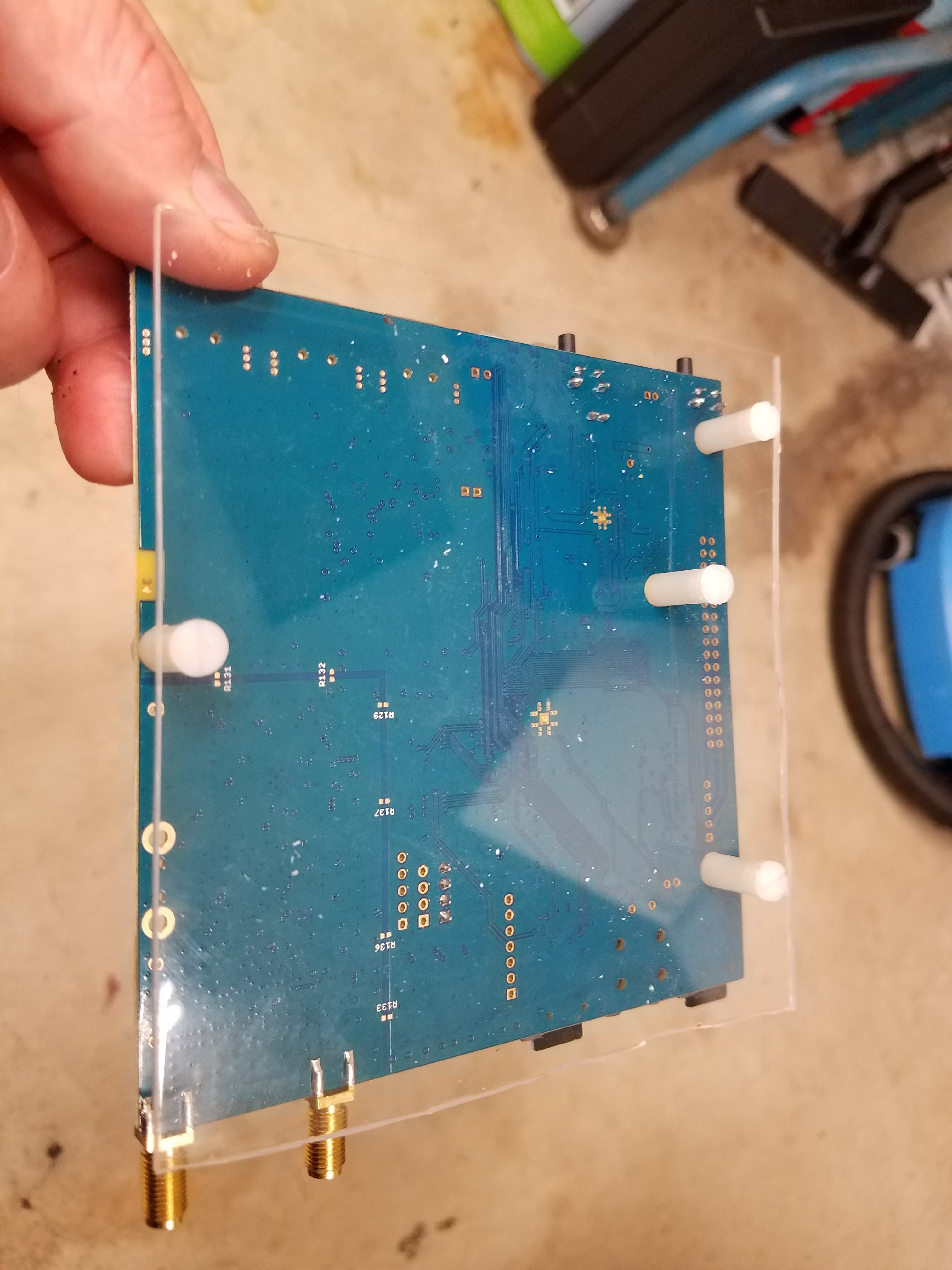

Here’s my ultra simple platform. All nylon standoffs (not to be confused with spacers) - these standoffs have 6-32 threads matching the 6-32 screws - all nylon - I used. Lexan platform. This’ll sit in my living room and I’ll pass a low loss cable thru the wall to a pivoting mount for the antenna outside . More on that later.
Well, the dingalings at Ace hardware were out of shorter nylon screws so I hadda cut 'em (all 8 of 'em) short with a box cutter rolling along the threads to make them short enough to not run into each other halfway in the standoffs. The nylon screws on the bottom serve as bumpers to set it on a table and not scrape the lexan all up. I coulda used the smaller holes as well but not necessary for this. Lexan melts when you use a rotating bit to drill or cut it, so beware, mess ensues! It’s what they had at the aforementioned ill-stocked hardware store. Anyhow done.
I hand (melted/fabbed) some acrylic brackets for the antenna… Sadly, the holes in the antenna do NOT fit 6-32 screws as do the holes in the Dreamcatcher. So… (sigh) I"ll go back and scrounge up some 4-40 nylon screws and nuts at said mediocre hardware store. I’ll drill a hole for a 1/4-20 screw (universal tripod mount) to fit thru the center of the brackets (there are two - you’ll see) as well. Pictures tomorrow.

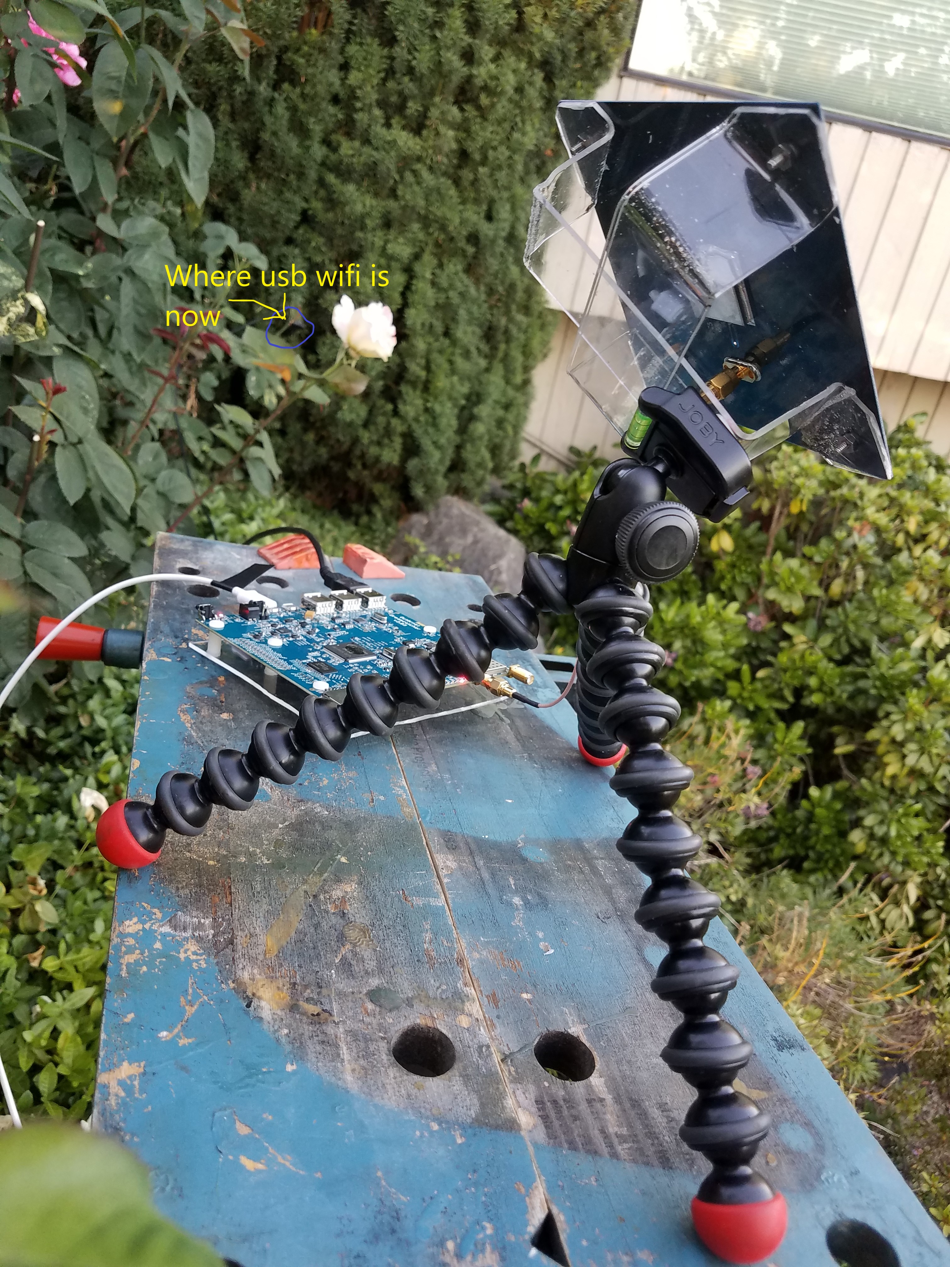

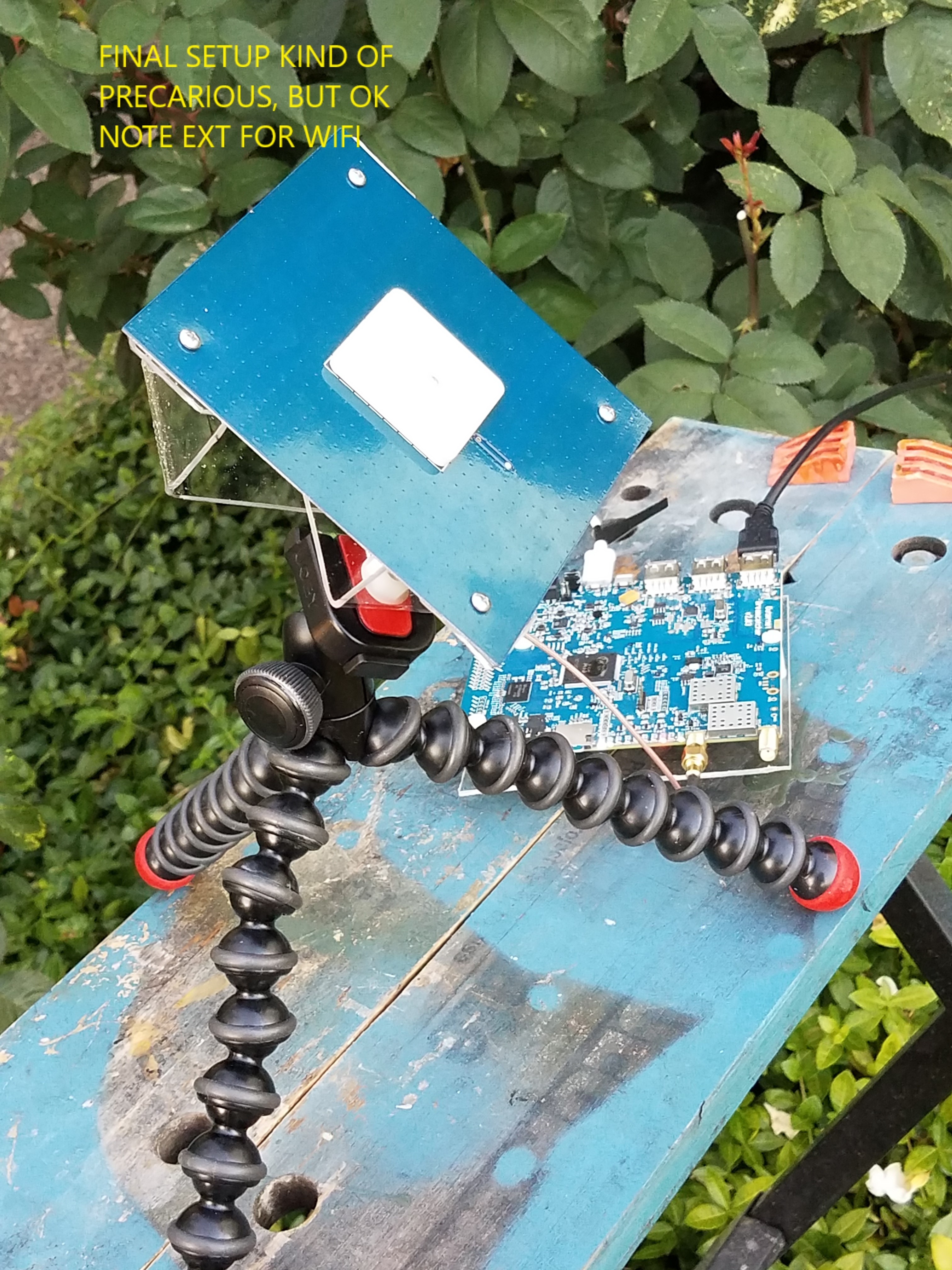

OK… after some cursing, and so on, a bit of a lashup, but hey, now it works! I can point it, etc. I need to duct tape the gorilla tripod down to the workmate (workmate designed by guy who designed the Lotus Elan or one of 'em at least.) . I had to add an extension to the wifi or it wasn’t strong enough for the basement (behind the concrete in one of the pics. I also took my wifi setup in my basement computer and hung it closer to the wall and up higher. The combo gave excellent two-way …
So you see, I bent those shapes so I cleared the back of the Antenna thingie. I had to offset the hold/mount for the 1/4-20 as it was such a short screw, but after that, even offset, with a universal pivot on this tripod, no biggie. I had to use metal screws for the antenna as 4-40s are not available at the hardware store in nylon (I DID order some, didn’t wanna wait). The bracket is acrylic. You cut it by scoring like glass (I used a box cutter) then extending over the edge of a table and placing a flat large object on top of the acrylic ON the table and whapping the overhanging edge with the side of your hand… It’s brittle yet bends easily under heat. Drilling is a pain. Sawing with a hacksaw to trim edges of (note I trimmed the corners so they didn’t hang out) isn’t so bad. I bent the acrylic over the edge of a table after heating with one of those cheapo torches run with butane (using butane lighter refillers). Enjoy!
Update on Adafruit Powerboost 1000C
The Adafruit Powerboost 1000c does not work with the Dreamcatcher. My configuration was to connect a Boston Power Swing 5300, a 2.4 amp USB wall wart, and the Dreamcatcher. If you start with a fully charged LiPo, the unit will drive the Dreamcatcher and float charge the LiPo fine.
If you run down the LiPo by disconnecting external power for 40 minutes, the Dreamcatcher runs fine. But running the Dreamcatcher while then recharging the LiPo from the Powerboost 1000C sheds the Dreamcatcher load.
It was worth trying, so I can understand Outernet engineering a solution might be very difficult to do. I’m more inclined to use Zoltan’s @zoltan external power pack idea. I know Jim @ac8dg ordered a Heloideo 5000mAh Slim Power Bank that might work (running and keeping the Power Bank charged so the Dreamcatcher stays operative), so I’m looking forward to his report. Ken
